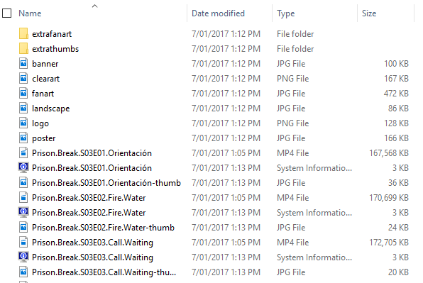

Just added Prison Break to see, added season 3, all episodes are present but the seasons section is empy as per the attached screenshot:
Example .nfos
S03E01

So this is a flat folder structure (Series with no Season folders), correct?
Correct, with episodes named SxxExx.episode.name example below:
