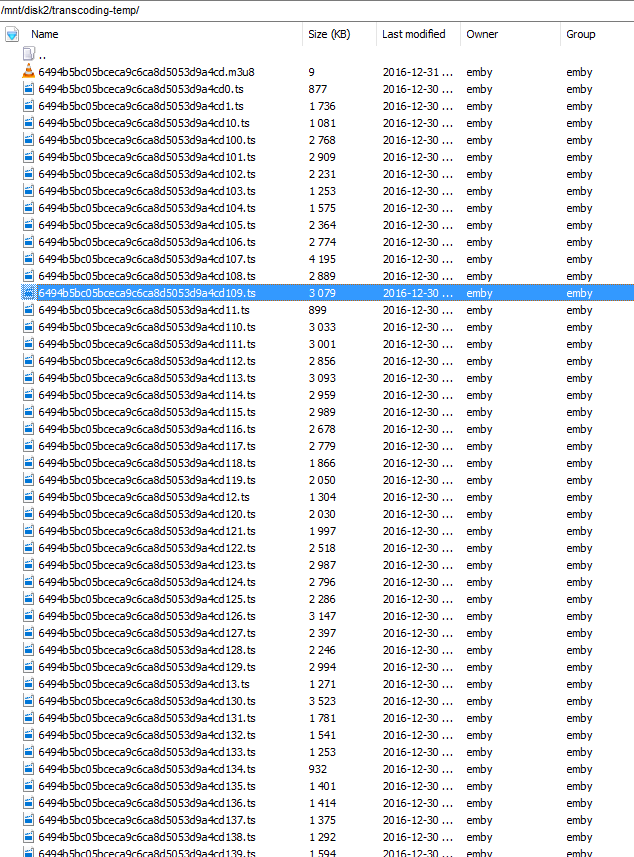

pr3dict 33 Posted December 31, 2016 Posted December 31, 2016 Hi, over the past 2 days my server, and I mean ENTIRE server has crashed to a point of not being able to login to my hypervisor and a hard reset is required. (Emby is run in a VM, storage server, router, etc. etc.) I have attached the most recent log before it crashed. I'm hoping someone can tell me its not emby so I can move on to the next piece of the puzzle. The weird thing is it has done it twice and both times the server was transcoding a video. Emby server log 161106 rev2.txt

pr3dict 33 Posted December 31, 2016 Author Posted December 31, 2016 Last question. When emby is transcoding is it normal for it to make like 100 files per viewing?
Luke 42244 Posted December 31, 2016 Posted December 31, 2016 the time probably won't make a difference, and yes for some apps we split the video into segments when transcoding.
