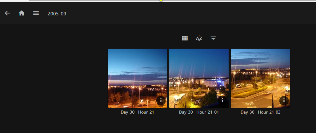

derelict 0 Posted October 12, 2017 Posted October 12, 2017 I do have the same issue. And i'm wondering why nobody else is asking this. I do have structured "Private Photo Collection" Folders ... but they all just show up as colored squares ... i was expecting, that emby is somehow able to generate "Cover Arts" for those folders... maybe with 5 random photos from with that folder as kind of a "collage" ? Do i really have to do all that work (with folder.jpg files) myself ? Please see the below screenshot ... all those Folders have Pictures in them ... Wouldn't it be nice.. if those folders whould be shown with some random photos as a cover art ? and wouldn't it be nice if i could just select/choose one photo and set it as "Album Cover" just while browsing my library (just like in facebook) ?
Luke 42203 Posted October 12, 2017 Posted October 12, 2017 hi @@derelict, we do do this. can you show the contents of one of these folders? thanks.
derelict 0 Posted October 12, 2017 Posted October 12, 2017 (edited) @@Luke Sure: This is the latest Emby Version (Premium) running on QNAP Storage... just in case this matters.. Edited October 13, 2017 by derelict
