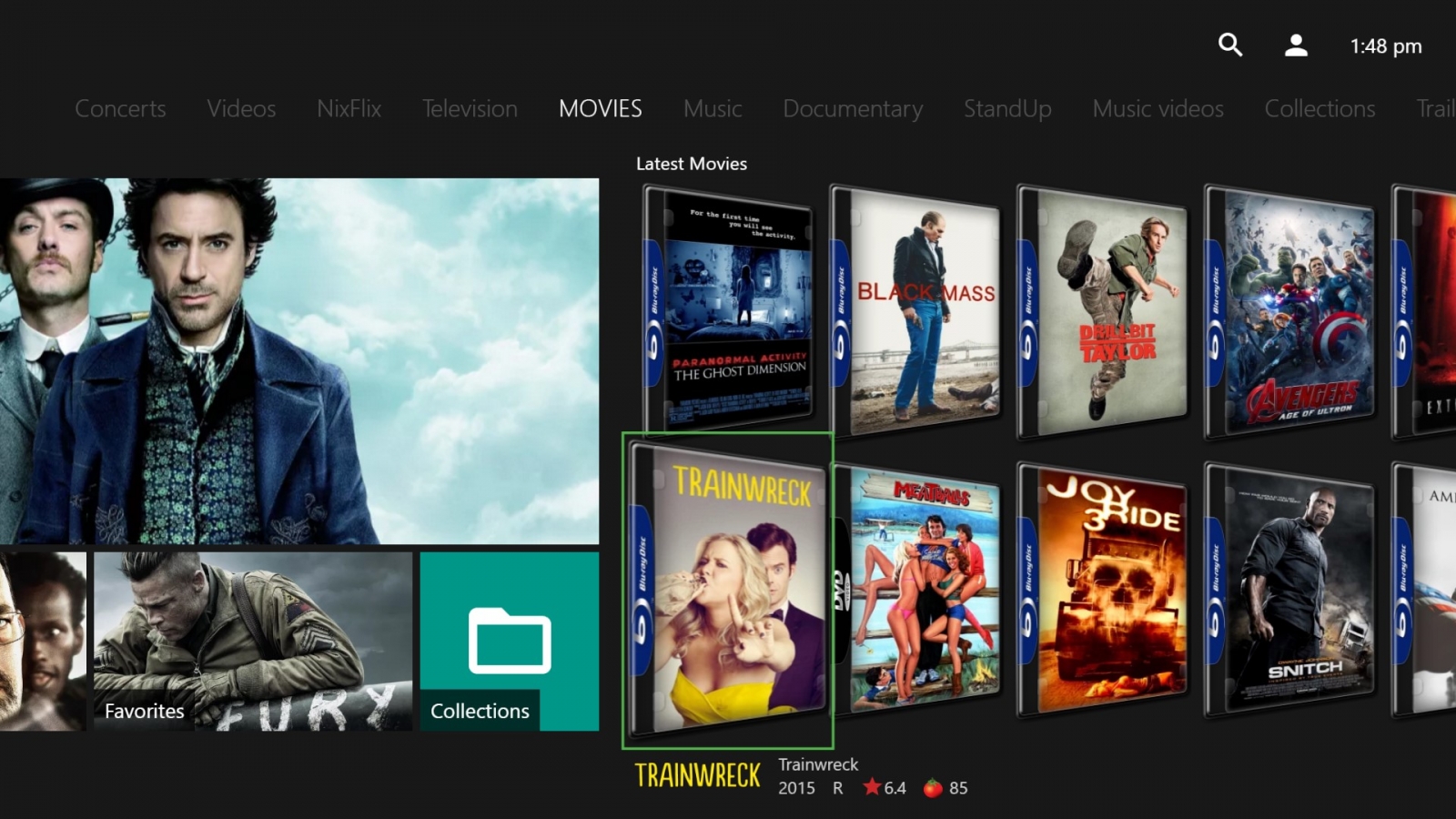

rms8 14 Posted December 29, 2016 Author Posted December 29, 2016 (edited) Hold down left click on a library on Home or Movies screen. Ok. From the Home screen, I held the Left click. This put a green box around each library and a checkable box in the upper left hand of each box. I clicked this in each Library and then clicked the tripple dots and selected Refresh. That's it, correct? Not sure how long it will take, but here is an example of what I am talking about regarding the missing time: Edited December 29, 2016 by rms8
Happy2Play 9801 Posted December 29, 2016 Posted December 29, 2016 (edited) Well that is Theater and I don't believe there is a multi-select there. Try app.emby.media instead of tv.emby.media or is that the actual app. Edited December 29, 2016 by Happy2Play

rms8 14 Posted December 30, 2016 Author Posted December 30, 2016 Well that is Theater and I don't believe there is a multi-select there. Try app.emby.media instead of tv.emby.media or is that the actual app. I was just using Theater to show the symptom. I was able to resolve it via your suggestion "...multi-select option and Refresh". THX! Not sure why it happened in the first place though?
