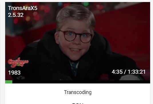

clarkss12 304 Posted December 27, 2016 Author Posted December 27, 2016 Played "A Christmas Story" using ET and it was playing OK but was being transcoded. I then powered off my Denon AVR and as Mark_G says, when I powered up my AVR, the video was one forth the size and playing in the top left corner. A Christmas Story ffmpeg log.txt A Christmas Story mediainfo.txt A Christmas Story server log.txt
Guest asrequested Posted December 27, 2016 Posted December 27, 2016 Turning it on and off uses the 19th pin in the HDMI cable. It's the control pin. It turns off the display, and then turns it back on. It's a hardware issue. I bought one of these to help with that. http://monitordetectkiller.com
