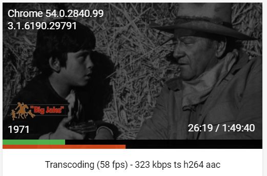

clarkss12 304 Posted December 27, 2016 Posted December 27, 2016 Watching "Big Jake" on my Tronsmart Ara X5, Windows 10 micro PC, Chrome browser is being transcoded when I see no reason why it should. AVR is showing "multi channel in". See attachments Big Jake ffmpeg Log.txt Big Jake mediainfo.txt Big Jake server log.txt
Happy2Play 9801 Posted December 27, 2016 Posted December 27, 2016 Well the browser/browsers are limited on codec support. Edge is the only browser that support AC3. Test your browsers support (https://html5test.com/).

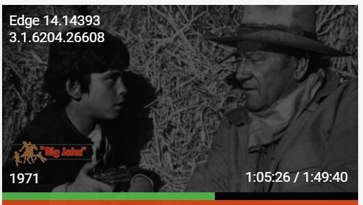

clarkss12 304 Posted December 27, 2016 Author Posted December 27, 2016 Ok, opened "Big Jake" with Edge Browser, and it is still transcoding, but much, much worse than playing in Chrome.
clarkss12 304 Posted December 27, 2016 Author Posted December 27, 2016 Well the browser/browsers are limited on codec support. Edge is the only browser that support AC3. Test your browsers support (https://html5test.com/). Ran the test on my Windows 10 box, with Edge, got 460, Chrome browser got 507. And yes, I see that Chrome does NOT support Dolby....
Luke 42186 Posted December 27, 2016 Posted December 27, 2016 There is no browser that supports mpeg2video, and only the Edge browser supports ac3. Is there something we can do here to prevent you from thinking Emby is doing something wrong?
