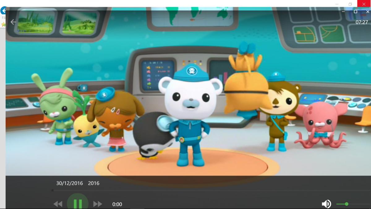

PrincessClevage 175 Posted December 27, 2016 Posted December 27, 2016 Hi there My recorded TV seems to have lost the fiction to skip forward and skip backward, both are greyed out. Is there a setting that I should check to enable this function again?

Luke 42243 Posted December 29, 2016 Posted December 29, 2016 ok, so in this case, the runtime is unknown and that is why the seek functions are not available. Try clicking the dot menu -> refresh. then play the content and see if that helps. thanks !
PrincessClevage 175 Posted December 29, 2016 Author Posted December 29, 2016 (edited) ok, so in this case, the runtime is unknown and that is why the seek functions are not available. Try clicking the dot menu -> refresh. then play the content and see if that helps. thanks !Is refresh close to realtime? Tried 2 separate recordings but still same issue Edited December 29, 2016 by PrincessClevage

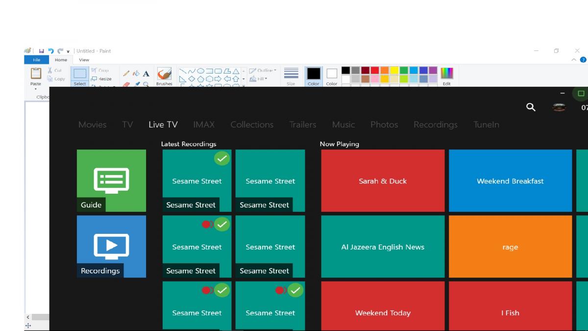

PrincessClevage 175 Posted December 29, 2016 Author Posted December 29, 2016 Is refresh close to realtime? Tried 2 separate recordings but still same issue Not sure if this is related but none of the rectangles under "Now playing" have any images, just colour rectangles

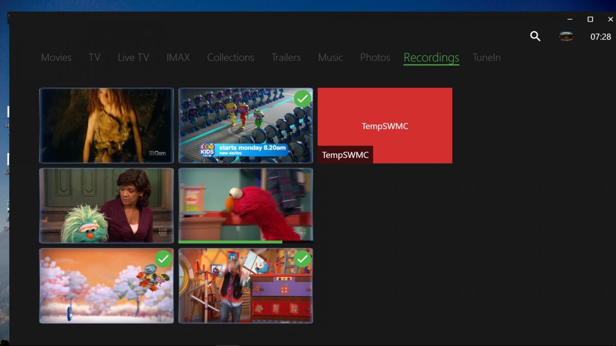

PrincessClevage 175 Posted December 29, 2016 Author Posted December 29, 2016 yes, currently I have only 5tv recordings in web view and 5in ET. Their descriptions match alsoI have also observed that under live tv in the web view displays the same colour tiles and details as ET but under "recordings" displays image and details correctly (as per previous screen shot)
PrincessClevage 175 Posted December 29, 2016 Author Posted December 29, 2016 I have also observed that under live tv in the web view displays the same colour tiles and details as ET but under "recordings" displays image and details correctly (as per previous screen shot)I have also check ET and it is the same I.e "recordings" shows tiles correctly with image and correct details and plays correctly with ff option but recordings listed under "live TV" show no image, not full details and plays with ff option greyed out.I have ran a library scan and guide data refresh

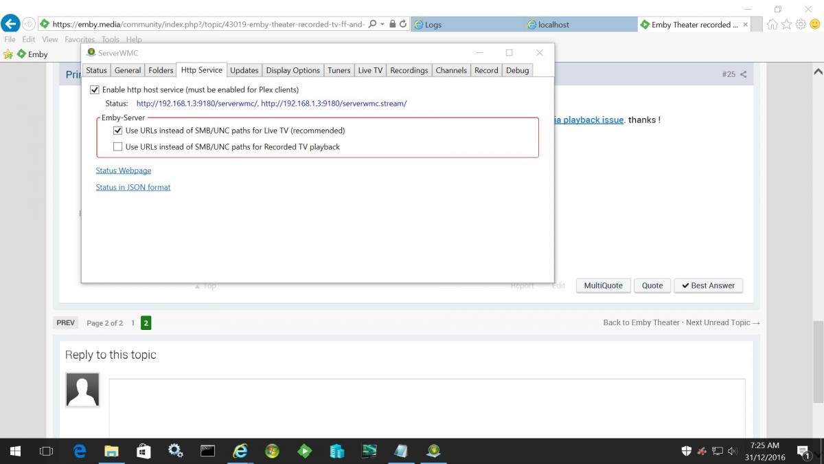

Luke 42243 Posted December 29, 2016 Posted December 29, 2016 Are you using server wmc? i think that's because server wmc is sending the recording path back as a url, in which case we don't probe it for media info. i think it can be configured to send back the actual file path.
PrincessClevage 175 Posted December 29, 2016 Author Posted December 29, 2016 Are you using server wmc? i think that's because server wmc is sending the recording path back as a url, in which case we don't probe it for media info. i think it can be configured to send back the actual file path.Yes I am using server WMC and url is ticked (always has been to my knowledge ) as it states it is recommended for Emby (for greater support of remote sessions.
Luke 42243 Posted December 29, 2016 Posted December 29, 2016 for live streams (channels) yes. for completed recordings, the actual file path is a better option. i thought the latest server wmc was making that distinction now.
PrincessClevage 175 Posted December 30, 2016 Author Posted December 30, 2016 for live streams (channels) yes. for completed recordings, the actual file path is a better option. i thought the latest server wmc was making that distinction now.I have tried the server WMC stable and preview versions but still same results for live TV. Is there some setting that I should check specifically?
Luke 42243 Posted December 30, 2016 Posted December 30, 2016 @@krustyreturns is there a way to send back the file paths of the recordings? thanks !
krustyreturns 191 Posted December 30, 2016 Posted December 30, 2016 In serverwmc open the 'http service' tab and make sure 'use urls instead of smb paths for recorded tv' is NOT checked (default). You might need to start emby to see the change. Reply Report Edit
PrincessClevage 175 Posted December 30, 2016 Author Posted December 30, 2016 (edited) for live streams (channels) yes. for completed recordings, the actual file path is a better option. i thought the latest server wmc was making that distinction now.i have checked with krusty (Serverwmc support) and he informs me that all is required is to make sure that on the http tab make sure the use url for recorded TV playback is unchecked (which it is) Edited December 30, 2016 by PrincessClevage
