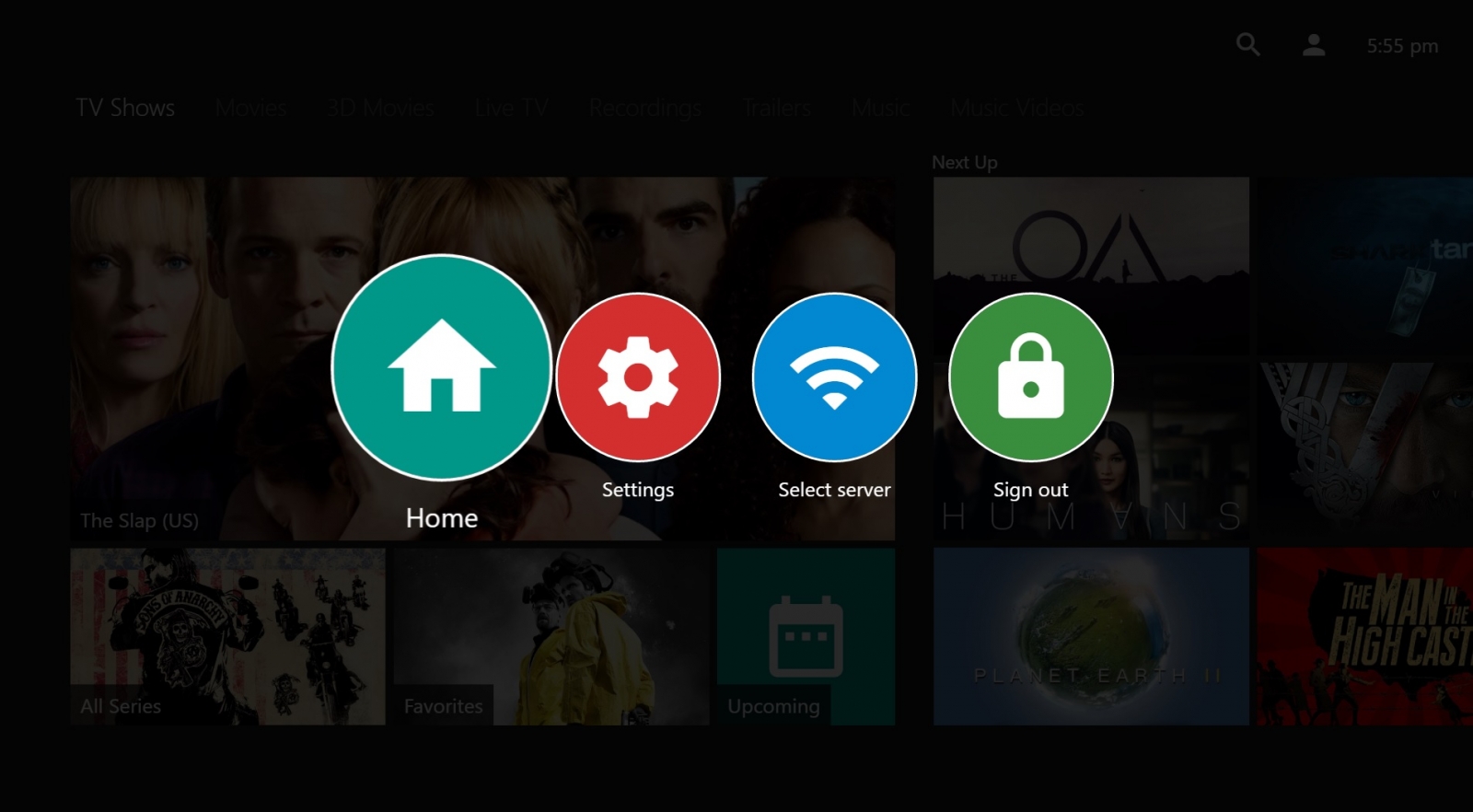

diaz1510 154 Posted December 19, 2016 Posted December 19, 2016 Weird problem and not sure what creates it. I will be using ET and randomly I will notice after watching some media that the 3 symbols in the upper right (minimize, maximize, and "X") are gone. I then select the person silhouette to try to exit that way but the exit options are missing. The only way to shutdown ET from here is to open task manager and close the application there. Problem is, it won't fix until I do a complete PC restart. Then, after a random length of time, it does it all over again. Below are some screenshots: Notice the lack of the 3 symbols in the upper right corner And here is what it looks like when I click on the person silhouette:

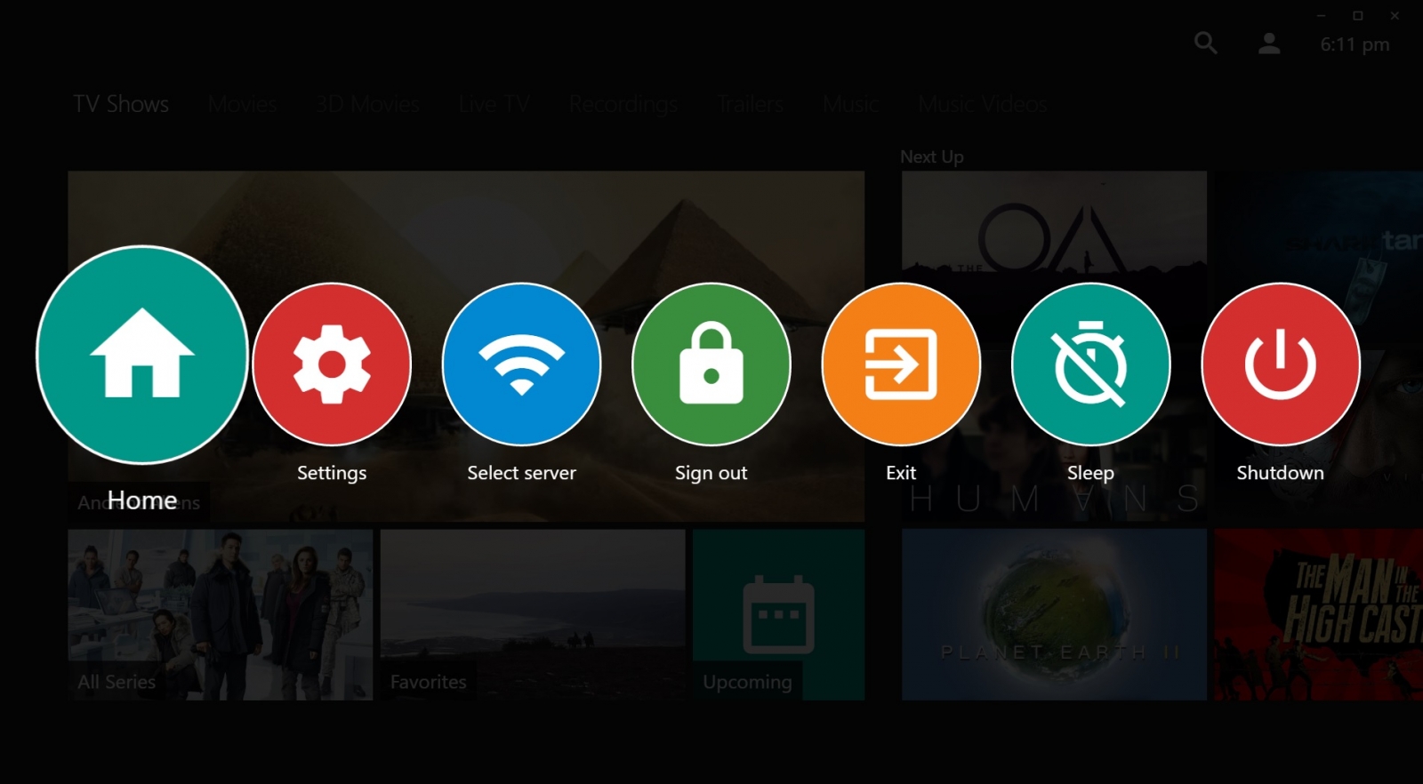

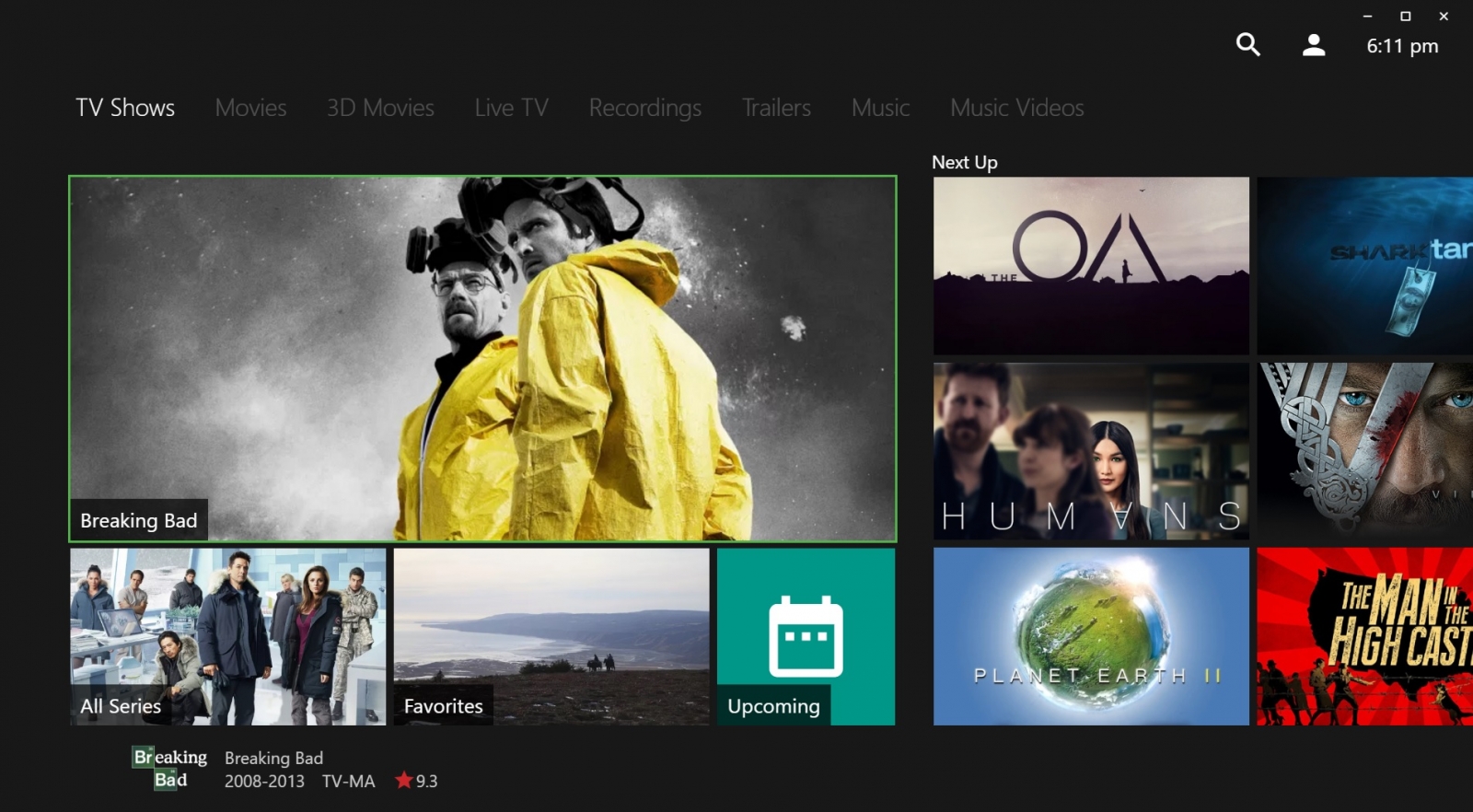

diaz1510 154 Posted December 19, 2016 Author Posted December 19, 2016 Here are some screenshots I just took when it is working properly:
Luke 42243 Posted December 19, 2016 Posted December 19, 2016 Sounds to me like a graphics driver crash that gets cleared up after rebooting.
