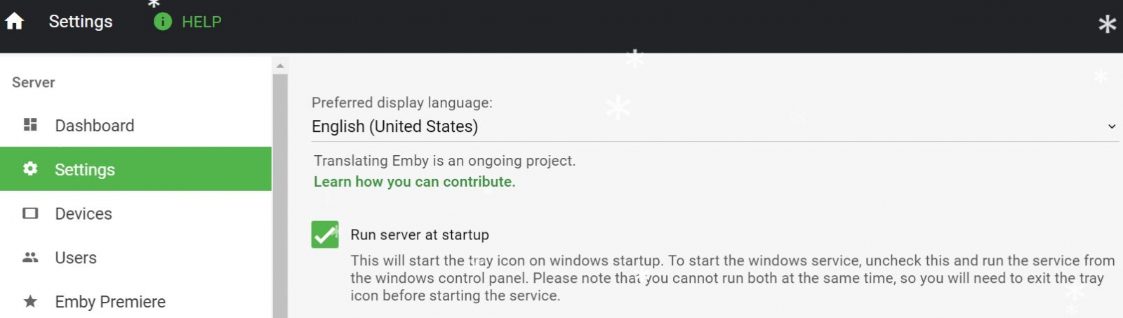

Sammy 790 Posted December 19, 2016 Posted December 19, 2016 (edited) I'll take a peak at my task manager. In the mean time, I cannot access Emby remotely because I had some issues needing a re-boot this morning and I forgot to load the server manually before I left the house. I can log in via Team Viewer and fix it because RDP is not an option due to the Emby Server running on the auto logged in WMC user name. On my list of things to do is to move the Emby Server to another user name so I can remote in with a log in to do things that can only be done on the host machine. It hasn't made it from the long list to the short list yet. Getting Emby to load at start up would be nice. It is in my start up tasks so I'm not sure why it isn't loading. Edited December 19, 2016 by Sammy

Sammy 790 Posted December 21, 2016 Posted December 21, 2016 I looked in my Task Manager and sure enough there's only one PROCESS running. I didn't look at Services because it is my understanding that, even though the services show up in the Task Manager, they aren't used. This may be why you cannot load them but I'm not sure. It even says it on the Settings page but I think there's more information about running as a service versus a process on here somewhere but I don't know where as I don't use it. @@Luke can probably point us in the right direction. That said, My Emby Server is still not loading automatically at start up but Start Server at Startup is enabled.

Luke 42197 Posted December 22, 2016 Posted December 22, 2016 Is there a shortcut for Emby in your startup folder C:\Users\HTPC\AppData\Roaming\Microsoft\Windows\Start Menu\Programs\Startup
jmassaro87 28 Posted December 22, 2016 Author Posted December 22, 2016 Is there a shortcut for Emby in your startup folder C:\Users\HTPC\AppData\Roaming\Microsoft\Windows\Start Menu\Programs\Startup Yes there is, should there not be? Its been there forever.
