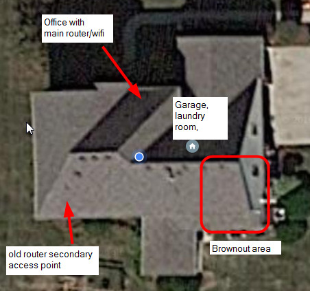

Marc_G 95 Posted December 9, 2016 Author Posted December 9, 2016 (edited) Hi guys! My home is nothing special. No giant mansion or anything. Here's a Google maps satellite view, showing the area where the office is with the router, and noting the area where there is weak coverage. All rooms relevant to this discussion are on the main floor level. Scale: As shown here I think the house is about 60-75 feet in this direction <-------------> It's worth ~$100 or so to fix this. Maybe a bit more for an elegant solution or something that would offer improved functionality overall. Now, I know well that if I were to mount the main N750 router centrally in the kitchen, not under a desk next to the garage-facing wall in my office, that I would get a LOT better coverage from it. That wouldn't cost me anything, as I have plenty of cable to run and so forth. However, Putting it where it belongs would effectively end my marriage. Visible router in kitchen won't pass the WAF. Also, there's the consideration that I have a UPS in the office that handles my cable modem, router, office Ethernet splitter, one of my tuners, and one computer. I stay online about 40 minutes into an outage, which means I only lose power to the network components once every couple years, on average. There's another UPS downstairs near the HTPC/Emby server covering it, another tuner, splitter... I'll catch up reviewing all the great info above over the next day or two. Totally wiped out right now though! Thanks again, and don't hesitate to pipe in with any further thoughts... Edited December 9, 2016 by Marc_G 1
