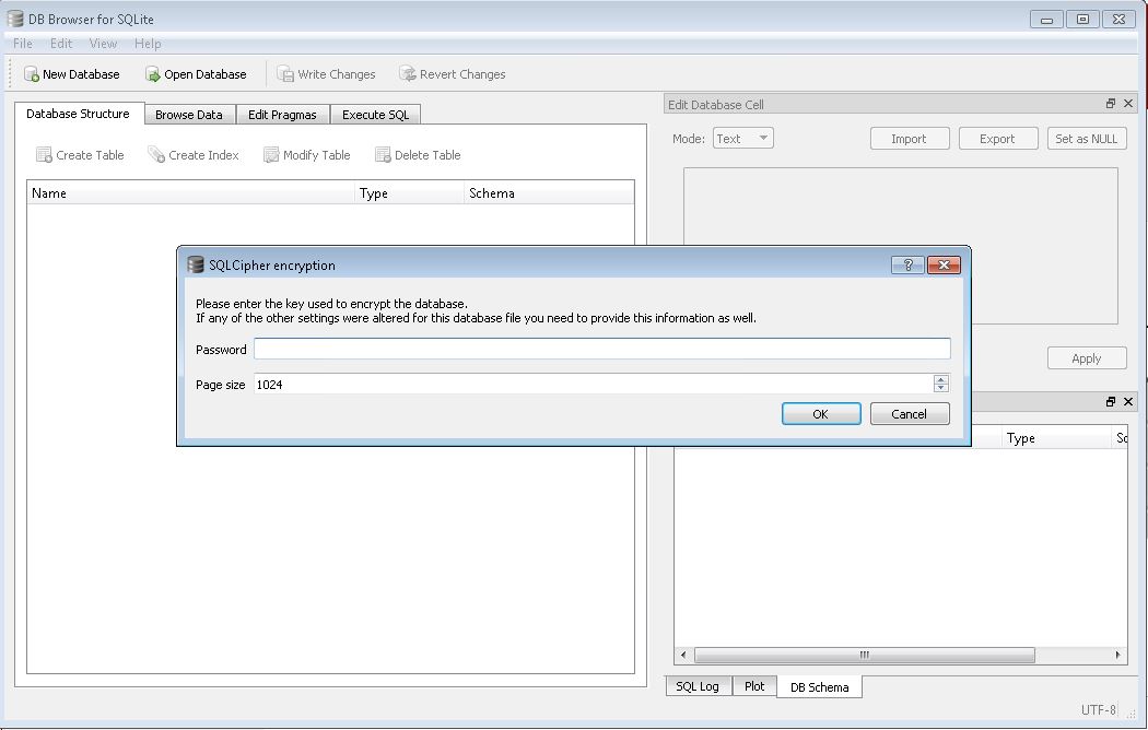

djon 16 Posted December 7, 2016 Author Posted December 7, 2016 Okay I upgraded to the latest Emby now. Now I can't open Library.db as it requires a Password as it's apparently SQL Cipher encrypted. What's the password?
Happy2Play 9801 Posted December 7, 2016 Posted December 7, 2016 Okay I upgraded to the latest Emby now. Now I can't open Library.db as it requires a Password as it's apparently SQL Cipher encrypted. What's the password? Had no problem opening it with SQLite Database Browser Portable.
djon 16 Posted December 7, 2016 Author Posted December 7, 2016 (edited) Ok, I can only read the db when Emby is shut down. When it's running it apparently locks the db in the new version of Emby. Any way around this? Edited December 7, 2016 by djon
Luke 42186 Posted December 8, 2016 Posted December 8, 2016 3.0.8500 opens the database in exclusive mode which is what is causing that error. The beta is not doing that although it possible to be added back again. Did you go through the forced upgrade that 3.0.8500 presented you with? You should get that done, because the beta has enough changes that we're no longer going to do the upgrade and instead we're just going to rescan the library entirely (if you're coming from a really old version like you are). you should backup library.db and userdata_v2.db throughout this process in case you need to retry. on the other hand with the beta you could consider deleting library.db and letting it rescan your library. again if you make backups you can try and see what produces the best result. please note, i'm only presenting you with information, not trying to encourage you to install pre-release as it is a work in progress so your transition might not be perfectly seamless. but since you're running sql queries i assume you know what you're doing, so if you make backups of all the databases it shouldn't be hard to experiment.
