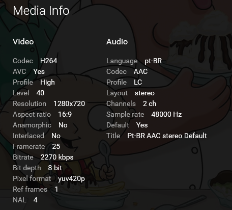

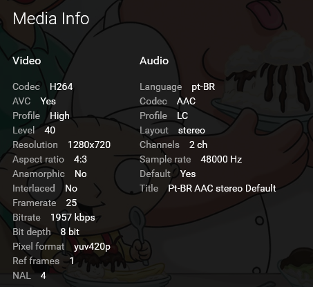

anderbytes 141 Posted December 4, 2016 Author Posted December 4, 2016 Here it goes: -- MEDIA 1 -- MEDIA 2 -- MEDIA 3 Maybe you got the bug asking for the media info. Look at the Resolution vs Aspect Ratio of the item 3. It doesn't match.
SamES 1088 Posted December 4, 2016 Posted December 4, 2016 A No that's fine. In that case, for example #3, there is nothing we can do about the Dlna playback, other than forcing transcoding. Can you supply the media info from the web app detail screen? For the Samsung app, there is maybe something we can do. @@SamES what do you think, it might be related to that position code in the video player, which I'm assuming exists in both Samsung apps. Thanks. So this almost looks like the reverse of anamorphic. We should force the player to match the aspect ratio, not the height/width. I wonder what issues this would cause?
SamES 1088 Posted December 4, 2016 Posted December 4, 2016 (edited) @@Luke, this would do it, but do we always trust the reported aspect ratio to be correct? Of course this all assumes playback on a device with a 16:9 ratio. You'll know where this code goes. Do you think this will have any unintended consequences? I'll admit to having not thought too hard about this, and i don't have anything in this format to test it on. Added code between the lines var newResolutionX; var newResolutionY; var centering; --------- if (videoStream.AspectRatio == "4:3") { newResolutionX = Math.round(rect.height * 4 / 3); newResolutionY = rect.height; centering = Math.round((rect.width - newResolutionX) / 2); webapis.avplay.setDisplayRect(parseInt(centering), parseInt(0), parseInt(newResolutionX), parseInt(newResolutionY)); return; } -------- if (ratioToShrinkX < ratioToShrinkY) { newResolutionX = rect.width; Edited December 4, 2016 by SamES
