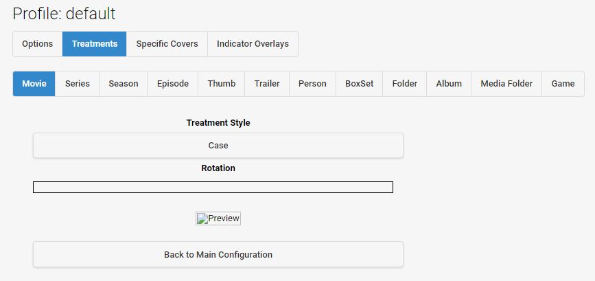

scottpro 15 Posted December 2, 2016 Posted December 2, 2016 Hi, I just installed the Cover Art plugin for Emby Server (I have a Premiere key) and it appears to be not working correctly. I can see the error in the logs with references to ImageMagick. OS: Ubuntu 14.04.5 LTS Emby Server: 3.0.8500.0 Cover Art: 4.0.19.0 Installation used: sudo sh -c "echo 'deb http://download.opensuse.org/repositories/home:/emby/xUbuntu_14.04/ /' > /etc/apt/sources.list.d/emby-server.list" sudo apt-get updatesudo apt-get install emby-server wget http://download.opensuse.org/repositories/home:emby/xUbuntu_14.04/Release.keysudo apt-key add - < Release.keysudo apt-get update Included is the log file after a restart and a screen shot of the plugin screen. Any help would be appreciated. Thanks, Scott server-63616232220.txt
hurricanehrndz 149 Posted December 2, 2016 Posted December 2, 2016 (edited) Hi, I just installed the Cover Art plugin for Emby Server (I have a Premiere key) and it appears to be not working correctly. I can see the error in the logs with references to ImageMagick. OS: Ubuntu 14.04.5 LTS Emby Server: 3.0.8500.0 Cover Art: 4.0.19.0 Installation used: sudo sh -c "echo 'deb http://download.opensuse.org/repositories/home:/emby/xUbuntu_14.04/ /' > /etc/apt/sources.list.d/emby-server.list" sudo apt-get update sudo apt-get install emby-server wget http://download.opensuse.org/repositories/home:emby/xUbuntu_14.04/Release.key sudo apt-key add - < Release.key sudo apt-get update Included is the log file after a restart and a screen shot of the plugin screen. Any help would be appreciated. Thanks, Scott Thank you for your feed back. Can you please be so kind to print out the list of directories within the lib directory under `/usr/lib/emby-server/`. Edited December 2, 2016 by hurricanehrndz
