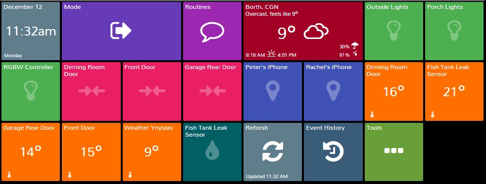

Swynol 375 Posted December 12, 2016 Posted December 12, 2016 So over the last few days been messing with smartthings. i currently have 3x Door sensors 2x presence sensors (mobile phones) 1x fibaro 2x 1.5kw relay 1x fibaro RGBW controller 1x Water leak sensor 1x zwave plug 1x motion sensor I have various apps and automation setup. for example all door sensors are linked to home security which alerts me if any of them open while me or the wife arent home. it also arms itself after a certain time at night. Also setup that if its between sunset and sunrise and the front door opens, turn on outside lights and porch lights. Also works with presence sensor that if i arrive home between sunset and sunrise turn on outside and porch lights for 10 mins. i have lights on my stairs, motion sensor sense lux and if its getting dark and between 7pm and 10pm turn on stair lights also if motion detected after 10pm until 1 hour after sunrise turn on lights. water sensor is below my fish tank, mainly incase it leaks. RGBW lighting in my theater room around the pool table. my plan is to add 2 smoke detectors and a few more lighting control around the house, maybe some more smart plugs (would of been good for the christmas tree lights). I also have a fibaro door sensor which i will get around to hooking up to my door bell so that when mu door bell rings it will notify me phone etc. i also use the smart tiles app. highly recommended, you can access your smartthings in anyweb browser, handy for tablet control.
