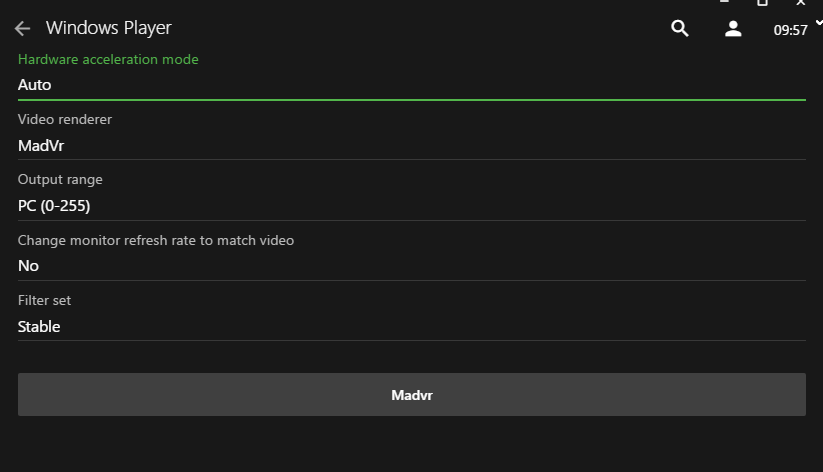

denz 501 Posted November 30, 2016 Posted November 30, 2016 The channel times are very slow for me as well developers will look into it. From your log it looks like you only tried to watch tv only once. Are you watching tv from external network or internal ? Have a look at the settings playback video and try to change hardware acceleration mode I have come across posts that this may cause issues. If this doesn't work that Luke will need to help you.
