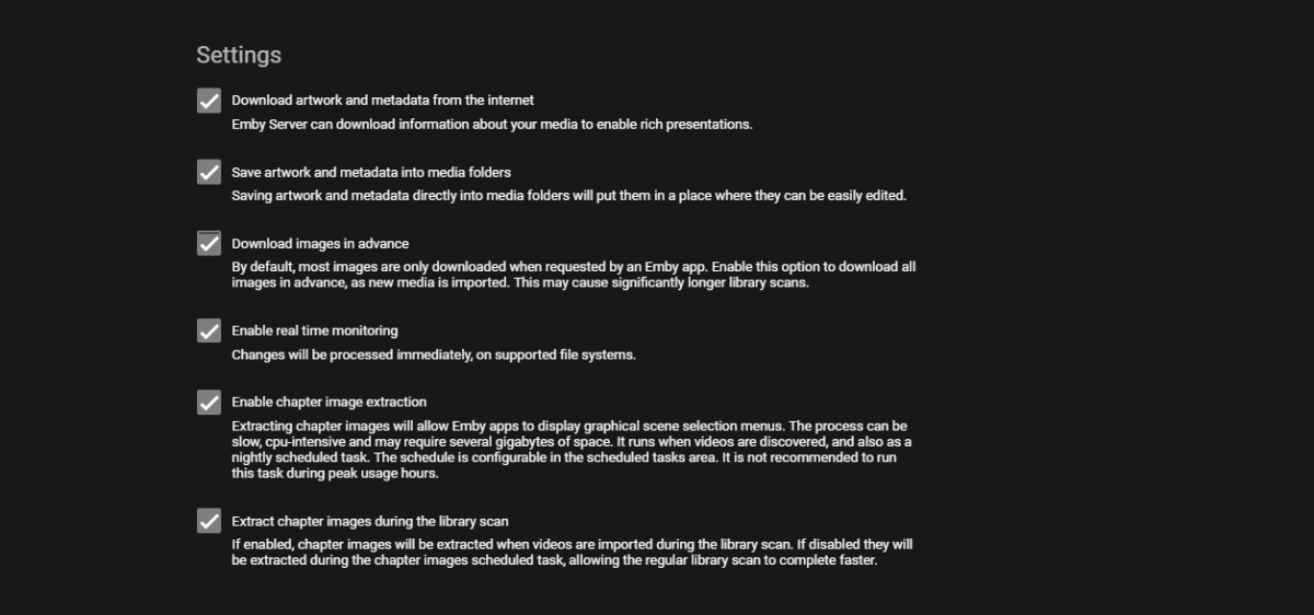

mediacowboy 438 Posted December 30, 2016 Author Posted December 30, 2016 (edited) @@ebr, is that the only setting I need to worry about? For now I am disabling the top 3 options. Since the stable version does them as well. Edited December 30, 2016 by mediacowboy

ebr 16354 Posted December 30, 2016 Posted December 30, 2016 @@ebr, is that the only setting I need to worry about? For now I am disabling the top 3 options. Since the stable version does them as well. Library Settings.PNG That should be fine. I run two servers pointing at the same library by disabling those options on my dev box and just letting the production one do all the work.
