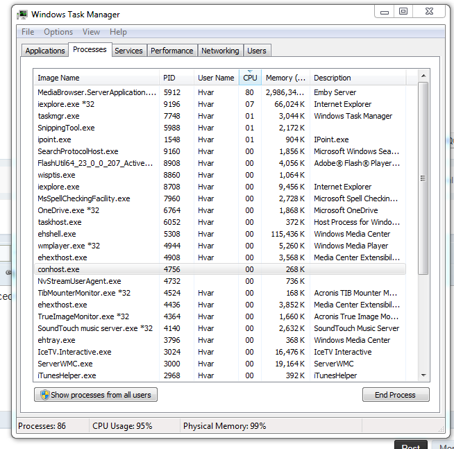

denz 501 Posted December 3, 2016 Posted December 3, 2016 I am on current beta 243 and noticed that emby is unresponsive and discovered that it is using 91% of cpu and nearly all the memory 1

RanmaCanada 503 Posted December 3, 2016 Posted December 3, 2016 I am on current beta 243 and noticed that emby is unresponsive and discovered that it is using 91% of cpu and nearly all the memory I am having the same issue lately, with no one on my server, my 8 core Xeon is at 51% usage with Emby. It has only started happening recently. I can end task it, but it will start going berserk within a few hours.
Luke 42288 Posted December 3, 2016 Posted December 3, 2016 I am having the same issue lately, with no one on my server, my 8 core Xeon is at 51% usage with Emby. It has only started happening recently. I can end task it, but it will start going berserk within a few hours. @@RanmaCanada please see How to report a problem.
denz 501 Posted December 4, 2016 Posted December 4, 2016 (edited) Luke should I post this in the testing server or is it ok here. It seems that scanning media library is the issue last night I restarted the server and it started scan media library and it got to 23.1% than I went to sleep and in the morning it was still stuck at 23.1%. I have just upgraded to 244 and again it is stuck at 23.1% it has been 10 minutes and no movement. server-63616350124.txt Edited December 4, 2016 by denz
