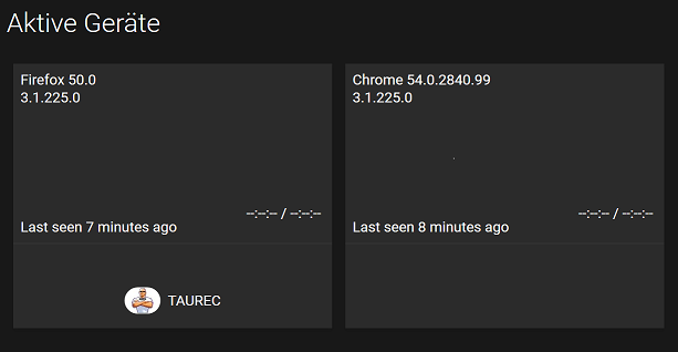

Taurec 60 Posted November 23, 2016 Posted November 23, 2016 Hi Luke, FYI After a couple of mounth i'm able to update the Emby Server on a Qnap TVS-871T The last working version is the 3.1.225.0 beta (running at the moment) All higher beta versions are not starting. Some other points: When a user disconnect from server the Info Field of the active devices show a empty field (see pic) The Emby Session show two <ArrayOfSessionInfoDto> The firstshow all data and Username, the second show all data but without UserId, UserPrimaryImageTag and the Username It takes 10 minutes to receive / show the correct connected Users. (Sorry for that but i user the Emby session xml for the rainmeter skin) (When you take a look at this, is it possible to implement the state of downloading a file at the sessions ? :-) ) As attachment the log files when the Server started. (Version Emby.Mono v3.1.234-beta) server-63615497094.txt unhandled_a2ad165d-f93b-4463-9d75-e173866f497f.txt Hope this can help cu Taurec
