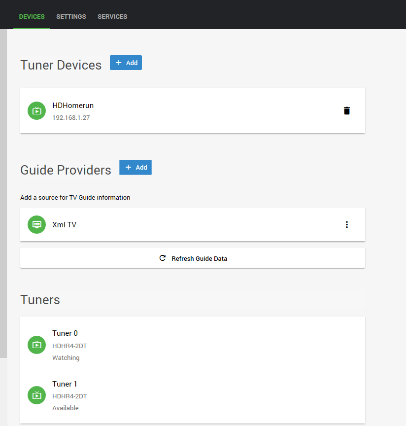

denz 501 Posted November 30, 2016 Posted November 30, 2016 (edited) Don't choose any services as you don't need them if you use hdhomerun. If you have installed nextpvr remove it. You choose xmltv in the guide providers and add the following in url substitute with your username and password you have to put http:// in front of username for some reason if I put http in front of the username then the link is hidden. username:password@iceguide.icetv.com.au/cgi-bin/epg/iceguide.cgi?op=xmlguideAlso put movie: in movie prefixThen you will need to map channels You should have something as similar as pictures attached Edited November 30, 2016 by denz 1

Nick's MCE 59 Posted December 7, 2016 Author Posted December 7, 2016 Hi Thanks for your help mate. So have the homerun working and can access live TV and all the channels in Emby Theatre. Having trouble with the guide and the mapping, guide just isnt downloading and no channel mapping is available. I have pasted the http//: into the browser and it takes me to a page of text which is clearly my guide data, emby just isnt downloading it. Also when playing in Emby Theatre the picture isnt full screen except on the HD channels, any pointers. Thanks Nick

denz 501 Posted December 7, 2016 Posted December 7, 2016 (edited) The screenshots are correct it starts like picture 2 then once it gets downloaded it gets formatted. Can you post the server log after running guide refresh just remember to replace your icetv username and password as it can be seen in the log files that will tell us what is happening it works for me there is no reason why doesnt for you. Can you try saving the icetv xmltv feed that is displayed on web page into xmltv file onto your pc and use that file as source and run import guide and try to map channels. Are you using beta or stable server i use beta Edited December 7, 2016 by denz

denz 501 Posted December 8, 2016 Posted December 8, 2016 (edited) I can see that it is not working "2016-12-08 10:34:20.7397 Info TaskManager: Refresh Guide Completed after 0 minute(s) and 0 seconds" there is something wrong with that url can you take a picture of your xmltv and PM it to me. Edited December 8, 2016 by denz
denz 501 Posted December 8, 2016 Posted December 8, 2016 This has been solved @@Luke the issue was in the username he had @ symbol once he got a new username it worked straight away.
Nick's MCE 59 Posted December 8, 2016 Author Posted December 8, 2016 Hi Yep it was the Ice TV username, when you setup the subsciption it defaults to your e-mail address for the username. You need to go in and change it. I did this and now it works. Thanks Nick
