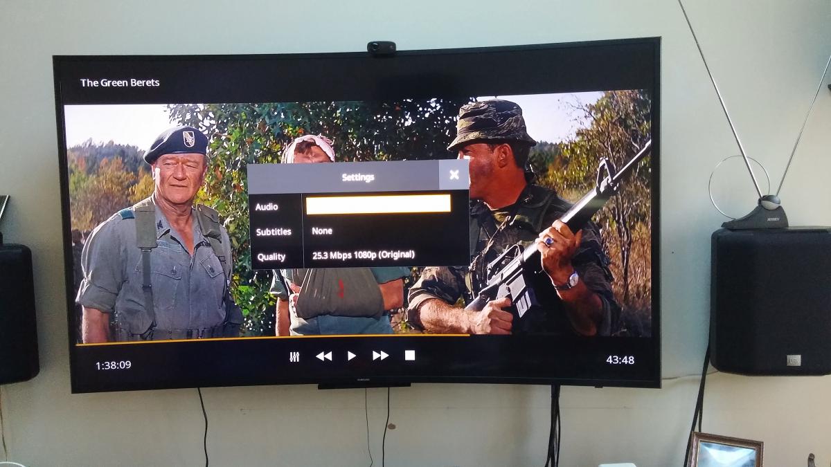

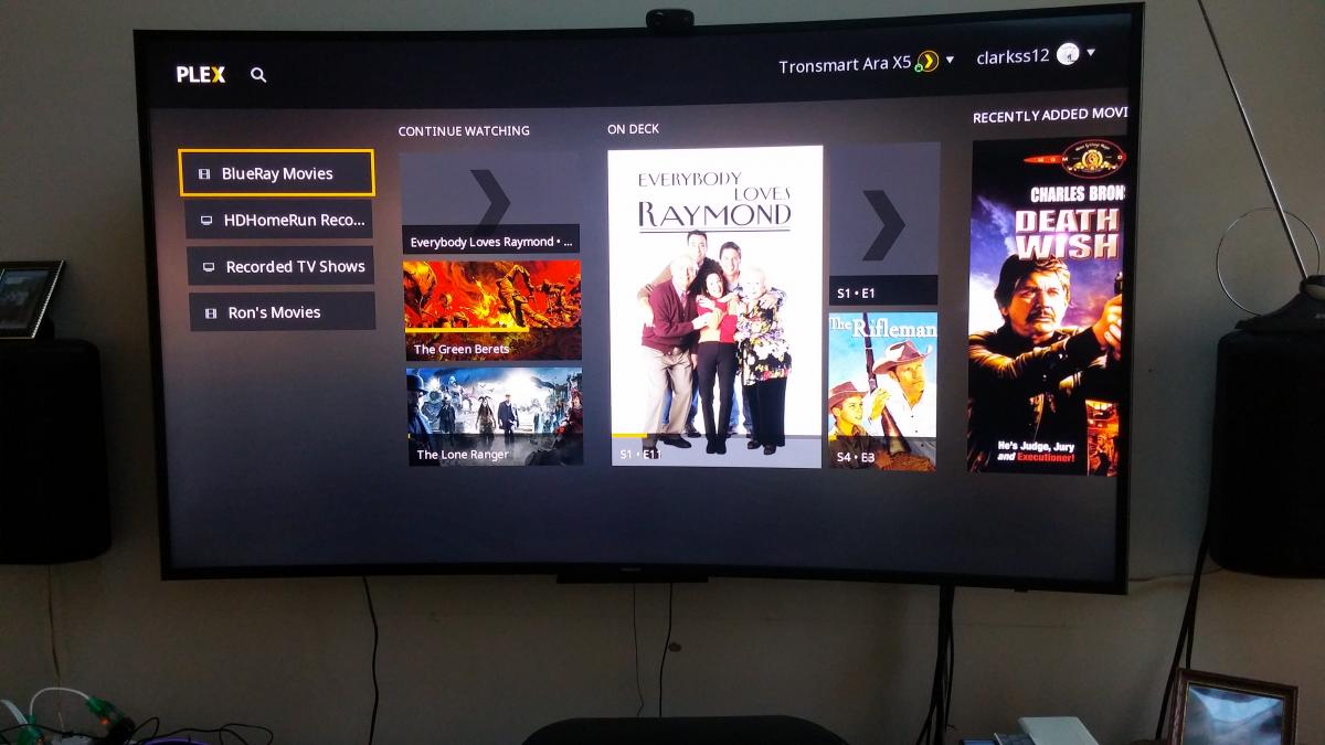

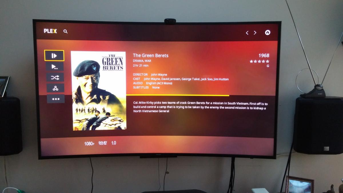

clarkss12 304 Posted November 21, 2016 Author Posted November 21, 2016 Last night I watched my BlueRay rip of "The Green Berets" all the way through using Plex and it played flawlessly. When I tried (several times) to play it using Emby, it buffers every 10 seconds, making it unwatchable. What I don't understand is why Plex can play it, but not Emby. I am using my low powered Tronsmart Ara X5 Windows 10 microPC as my server hardware. My client is my 2016 Samsung smart TV. I am sure that Emby is trying to transcode, but not sure how Plex is handling it. Again, I am trying to make my Samsung TV my primary client, and my inexpensive microPC as my server. The Green Berets mediainfo.txt ffmpeg log 1.txt ffmpeg log 2.txt ffmpeg log 3.txt ffmpeg log 4.txt
ebr 16334 Posted November 21, 2016 Posted November 21, 2016 What I don't understand is why Plex can play it, but not Emby. I am using my low powered Tronsmart Ara X5 Windows 10 microPC as my server hardware. My client is my 2016 Samsung smart TV. Hi. Luke answered that question here. Your continuing to report the details of items that cause transcoding when they maybe shouldn't will help us refine this. However, you have to also keep in mind the fairly glacial speed of getting new releases out on this particular platform .
SamES 1084 Posted November 21, 2016 Posted November 21, 2016 For Green Beret's, according to the Samsung K-series specs, VC1 is supported only to 20Mbps and TrueHD is not supported. I'm sure Plex must transcode this as well. Your transcoding at 11fps is a problem here. I think you can reduce the transcoding quality which may help if your box can't process it faster. This should make it play like Plex. If you can provide a short sample to download with the same format I can test it to confirm whether DirectPlay is possible but I expect not. For the Fugitive, DirectPlay of MPEG2 in mkv container was added recently, this release may be the version waiting to be published. DirectPlaying of subs without ffmpeg extraction is testing and will possibly be in the next submission after the current is released.

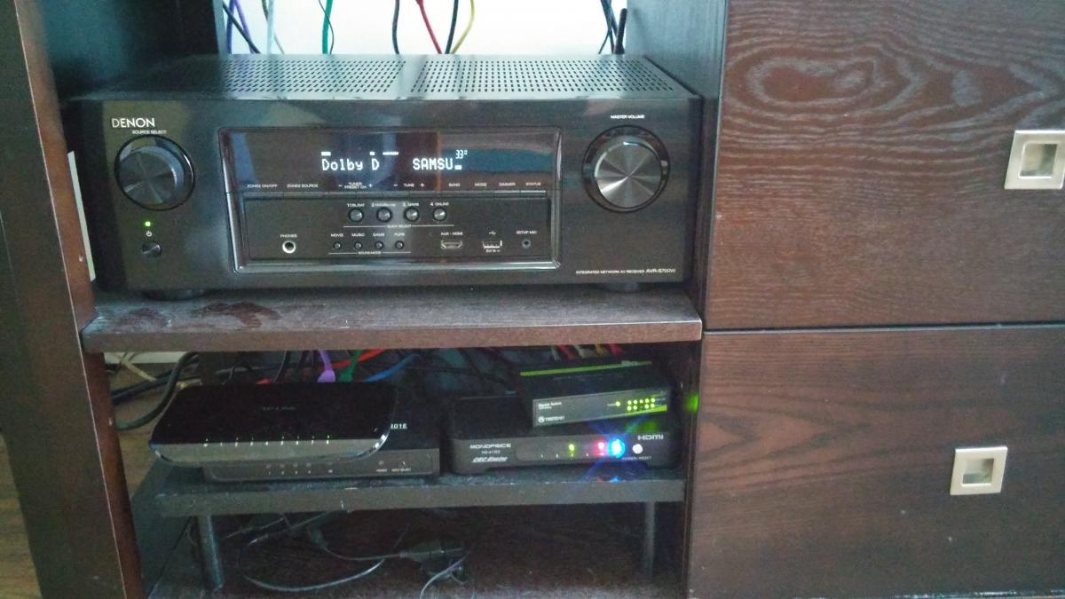

clarkss12 304 Posted November 21, 2016 Author Posted November 21, 2016 For Green Beret's, according to the Samsung K-series specs, VC1 is supported only to 20Mbps and TrueHD is not supported. I'm sure Plex must transcode this as well. Your transcoding at 11fps is a problem here. I think you can reduce the transcoding quality which may help if your box can't process it faster. This should make it play like Plex. If you can provide a short sample to download with the same format I can test it to confirm whether DirectPlay is possible but I expect not. For the Fugitive, DirectPlay of MPEG2 in mkv container was added recently, this release may be the version waiting to be published. DirectPlaying of subs without ffmpeg extraction is testing and will possibly be in the next submission after the current is released. I agree with what you said, however, Plex played "The Green Berets" flawlessly and my Denon AVR showed Dolby Digital. I don't understand how it showed Dolby Digital when "mediainfo" did not show as a audio format, but it did. How can I create a raw short section of that video? I added some pics of it.
SamES 1084 Posted November 21, 2016 Posted November 21, 2016 Possibly Plex is picking up the AC3 audio track, or it is transcoding audio only (for the TrueHD). Can you confirm whether Plex is really DirectPlaying the video? It may that it is transcoding but at a lower quality to Emby which is why you don't have buffering issues with Plex. You can try reducing the transcoding quality in the server settings and see if this fixes the buffering issue. To make a sample (by cutting/splitting) try: http://www.videohelp.com/software/MKVtoolnix Here is a quick guide, look at the split modes https://forums.plex.tv/discussion/173648/howto-splitting-multi-episode-files-with-mkvtoolnix-gui

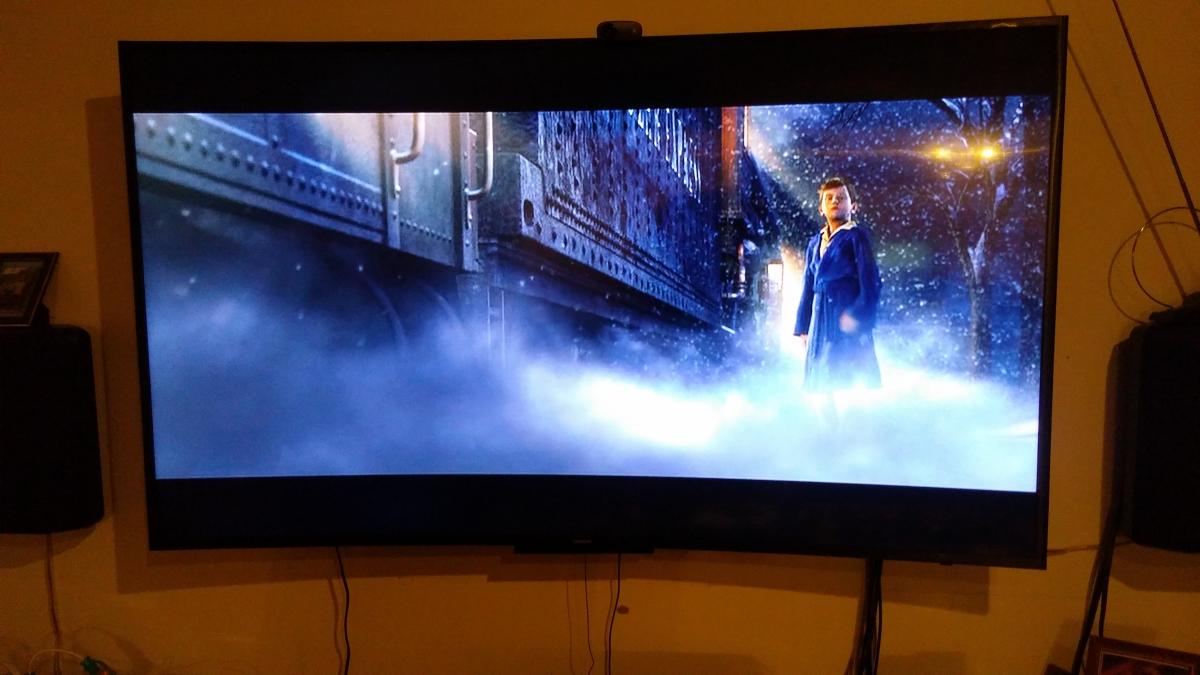

clarkss12 304 Posted November 22, 2016 Author Posted November 22, 2016 One more observation, I am getting ready for the holidays, so was testing "The Polar Express". The video plays great even though it is transcoding (37 fps), h264 ac3. It however, is playing in a rectangle on the screen (pic attached), instead of whole screen with black borders on top and bottom. My main issue is that it is not playing in Dolbly Digital. It shows PL2 C, instead of Dolby. The best part of the Polar Express is the surround sound. The Polar Express ffmpeg 1 Log1.txt The Polar Express ffmpeg 2 Log1.txt The Polar Express media info.txt The Polar Express server log.txt
SamES 1084 Posted November 23, 2016 Posted November 23, 2016 I think once the next version is released by Samsung it fixes these issues. Anamorphic content was not filling the screen in a previous version which is fixed for next release. MPEG2 in mkv container is also a recent fix. This is causing transcoding for you which is probably why your receiver is showing wrong audio stream type Please check again when the next version is released to the store.
