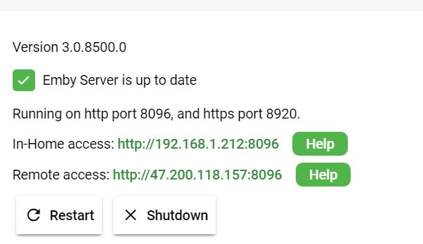

kidsensation20 0 Posted November 27, 2016 Posted November 27, 2016 I cannot connect externally, internal works fine. I have port forwarding rule established in router and in Norton. Can you provide the specific windows services required for external access? Not sure what else to try...
Luke 42290 Posted November 27, 2016 Posted November 27, 2016 I cannot connect externally, internal works fine. I have port forwarding rule established in router and in Norton. Can you provide the specific windows services required for external access? Not sure what else to try... Hi there, welcome. Sorry to hear about this. Please try the steps listed in our Connection Troubleshooter. Please let us know exactly what steps succeed and which ones fail, as that will help us narrow down the issue. Thanks !
kidsensation20 0 Posted November 28, 2016 Posted November 28, 2016 Went through Connection Troubleshooter. All internal setup steps worked successfully. Public port 8096 is unreachable or connection timed out. I performed traceroute from external address, my external IP is good just will not allow remote access to any services. I am confident in the firewall (hard/soft) being configured correctly with port forwarding. A list of required services would help, in my opinion, to ensure something is not disabled.

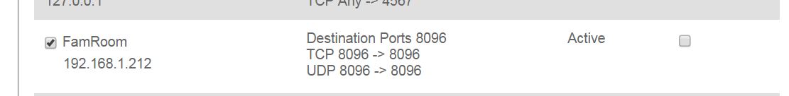

moviefan 187 Posted November 29, 2016 Posted November 29, 2016 These three screenshots would be helpful: Dashboard section where it shows URLs for Internal and External Access Router/Firewall configuration where the port forwarding or DMZ settings have been enabled as well as any inbound rules.
Happy2Play 9814 Posted December 3, 2016 Posted December 3, 2016 (edited) Well (http://www.yougetsignal.com/tools/open-ports/) show port closed. Your second screenshot what is the last checkbox? Edited December 3, 2016 by Happy2Play

moviefan 187 Posted December 4, 2016 Posted December 4, 2016 See attached It looks like the active box is unchecked from first glance.
kidsensation20 0 Posted December 4, 2016 Posted December 4, 2016 The word "active" is indicating the rule is active. The checkbox is to delete the rule only.
