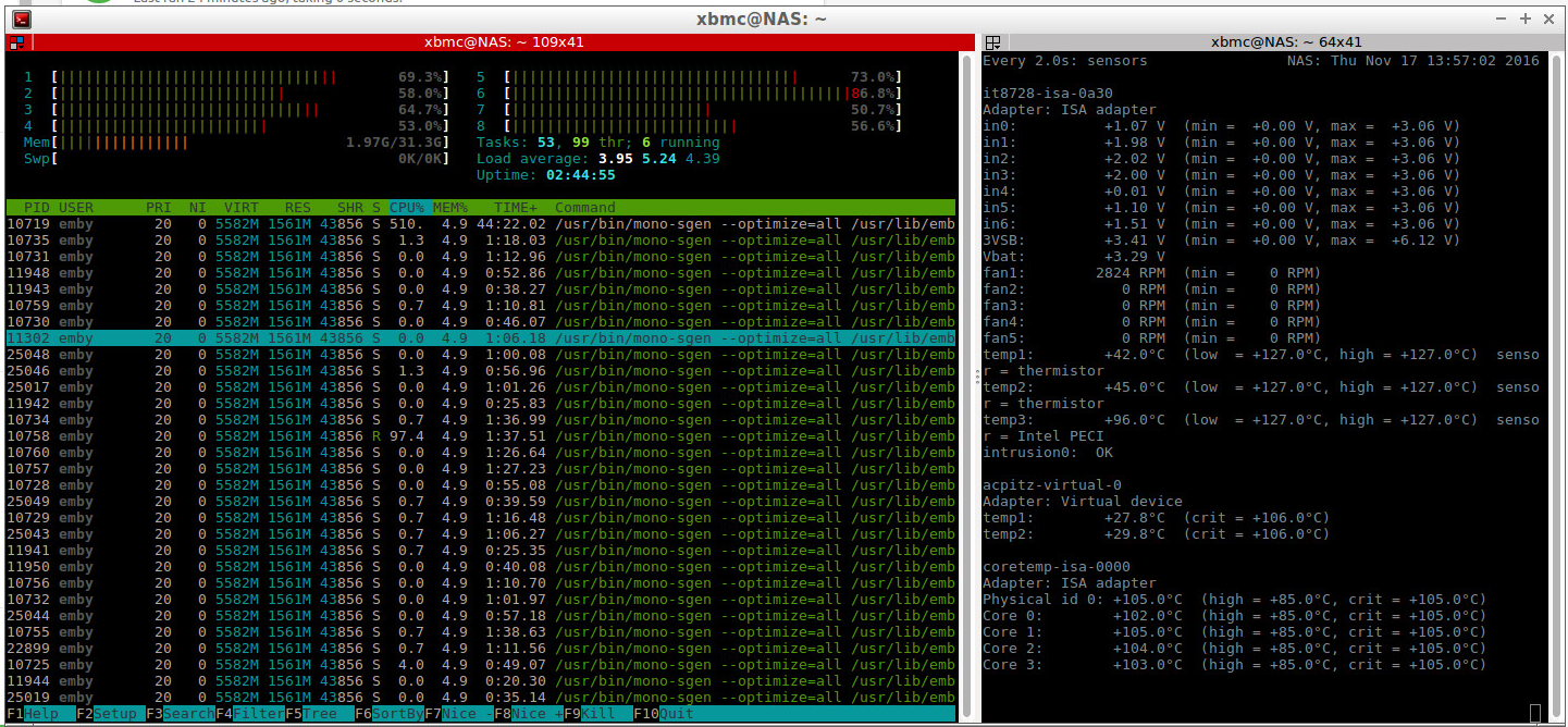

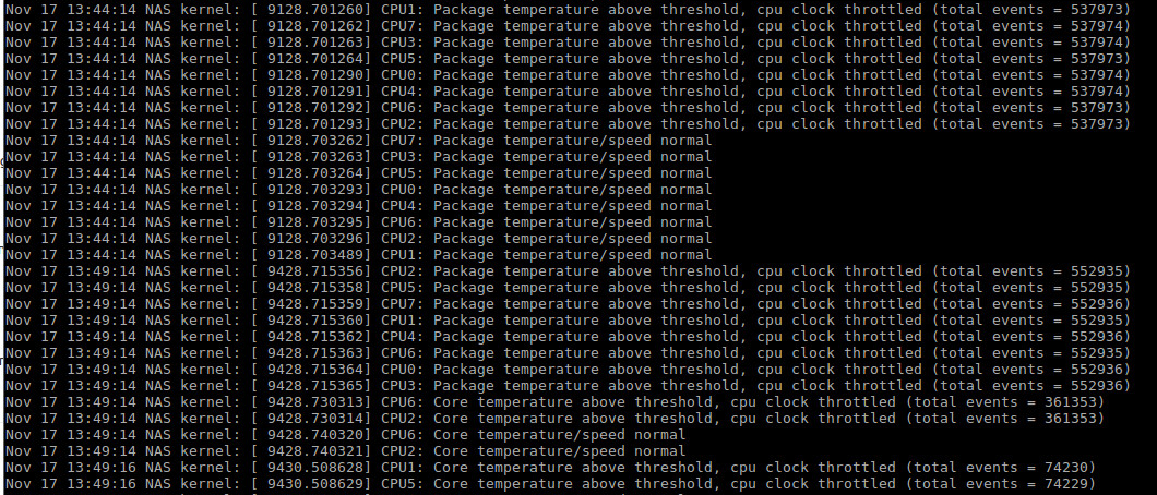

aenima99x 8 Posted November 17, 2016 Posted November 17, 2016 I've recently migrated from a MariaDB/MySQL server backend to Emby and am running into an issue. I absolutely love Emby and the integration with all of my Kodi setups and would like to keep this setup instead of going back to a MySQL setup. Any suggestions would be appreciated. Server/NAS Info Intel Core i7-3770 3.4GHz 32GB RAM Ubuntu 16.10 installed on mSSD (8) HDD setup in MDADM RAID for storage (20TB) Emby server version 3.0.8500 No Emby plugins installed besides Kodi Sync Queue Client Info Various Chromeboxes, laptops running LibreElec/Kodi 16.1 with Emby for Kodi addon version 2.3.6 Issue Primary issue is extremely high cpu usage during library scan task, refresh people task and transcoding. The high cpu usage is actually causing the cpu core temps to spike all the way to 105C and then the CPU is throttling down. Troubleshooting steps taken that haven't resolved issue I've uninstalled/reinstalled emby-server/mono/ffmpeg - no change. Disabled the Kodi plugin - no change Turned off the real-time monitoring for all libraries - no change DLNA is disabled Auto-Organize is disabled Current scenario test Emby is idle with no tasks running and no clients connected. CPU hovering around 165% usage, RAM is at 8G used by emby and all 4 cores of CPU over 100C temp Stop emby server ( systemctl stop emby-server.service) - CPU usage drops to 0%, RAM usage drops to 500MB, and all 4 cores of CPU are now at 50C temp Start emby server (systemctl start emby-server.service) - CPU usage at 4%, RAM usage at 800MB and all 4 cores of CPU at 50C temp Start the Refresh people task - within 1 minute the CPU usage has jumped to 140%, RAM usage now up to 1.2GB, all 4 cores of CPU now at 70C temp task at 20% complete - CPU usage now 280%, RAM at 1.6GB, all 4 cores of CPU at 80C temp task at 75% complete - CPU usage now 330%, RAM at 1.8GB, all 4 cores of CPU over 100C temp task at 99% complete - CPU usage now 510%, RAM at 1.9GB, all 4 cores of CPU over 103C temp (screenshot below) task finished after 22min & 48 seconds. CPU usage still hovering around 250%, RAM at 1.7GB, all 4 cores of CPU at 100C temp. AT this point, server is idle with no tasks running.

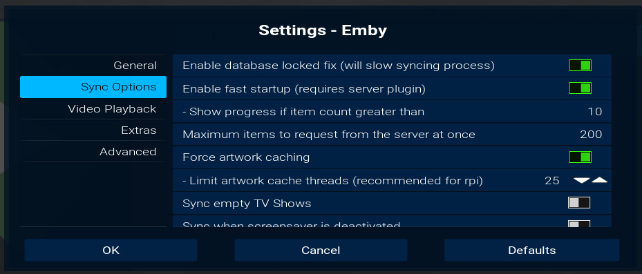

aenima99x 8 Posted November 18, 2016 Author Posted November 18, 2016 Yes understood about the transcoding, I'm not so worried about that. I seem to have gotten it under control for the time being by a combination of things including - disbaling real-time monitoring, disabling MusicBrainz lookups for Music and setting all the clients to use the "Enable database locked fix". Is there an ETA for the next release?
Luke 42244 Posted November 18, 2016 Posted November 18, 2016 What is this? Enable database locked fix
aenima99x 8 Posted November 18, 2016 Author Posted November 18, 2016 It's a setting in the Emby for Kodi plugin that is on the client machines

Angelblue05 4132 Posted November 22, 2016 Posted November 22, 2016 Yes understood about the transcoding, I'm not so worried about that. I seem to have gotten it under control for the time being by a combination of things including - disbaling real-time monitoring, disabling MusicBrainz lookups for Music and setting all the clients to use the "Enable database locked fix". Is there an ETA for the next release? Whats the issue you are having in Kodi? This option will drastically reduce the performance of the add-on. This is usually only needed if you have other addons or kodi content which causes conflict with Emby for Kodi adding things to the Kodi database at the same time. Let me know
aenima99x 8 Posted November 22, 2016 Author Posted November 22, 2016 Whats the issue you are having in Kodi? This option will drastically reduce the performance of the add-on. This is usually only needed if you have other addons or kodi content which causes conflict with Emby for Kodi adding things to the Kodi database at the same time. Let me know I was running into an issue where when the sync was happening on the clients, if I tried to go into a video node (Movies or TV), it would completely lock up the UI and the only way to fix it was by ssh'ing into it and rebooting.
Angelblue05 4132 Posted November 22, 2016 Posted November 22, 2016 How many items were syncing, a huge amount?
aenima99x 8 Posted November 22, 2016 Author Posted November 22, 2016 It happened several times, but I think it was a large amount each time. When i get home I can turn off the option and try again.
Angelblue05 4132 Posted November 22, 2016 Posted November 22, 2016 (edited) Your server is generating a huge amount of updates, then. You should fix the issue at the source, and it will lighten the amount of updates sent to emby for kodi. Things you can try: In the emby dashboard > metadata > nfo settings > uncheck save image paths to nfos. Do you have third party software that changes the last modified dates of your nfos? When nfos are modified, it forces the server to refresh the entry of that content. If all nfos are modified, this generates a pile of update for content, even though, nothing actually changed. In turn, the add-on is forced to update all those entries, putting a lot of strain on your clients. In reality, updates should only be for content you've watched, content you've added or actually updated (artwork, metadata), and content you've removed. Anything else that doesn't fit in these categories is superfluous and should be looked into to see why the server is updating those entries. Edited November 22, 2016 by Angelblue05
aenima99x 8 Posted November 22, 2016 Author Posted November 22, 2016 That would explain it then....I had a cron job running a bash script hourly against my media folders to fix the permissions. I've just disabled this in the last day after I finally set the emby user/group to the same account I'm using for other things on the server. I think I just hit several unrelated hiccups during my migration from MariaDB to Emby as my backend for all the Kodi clients. 1
