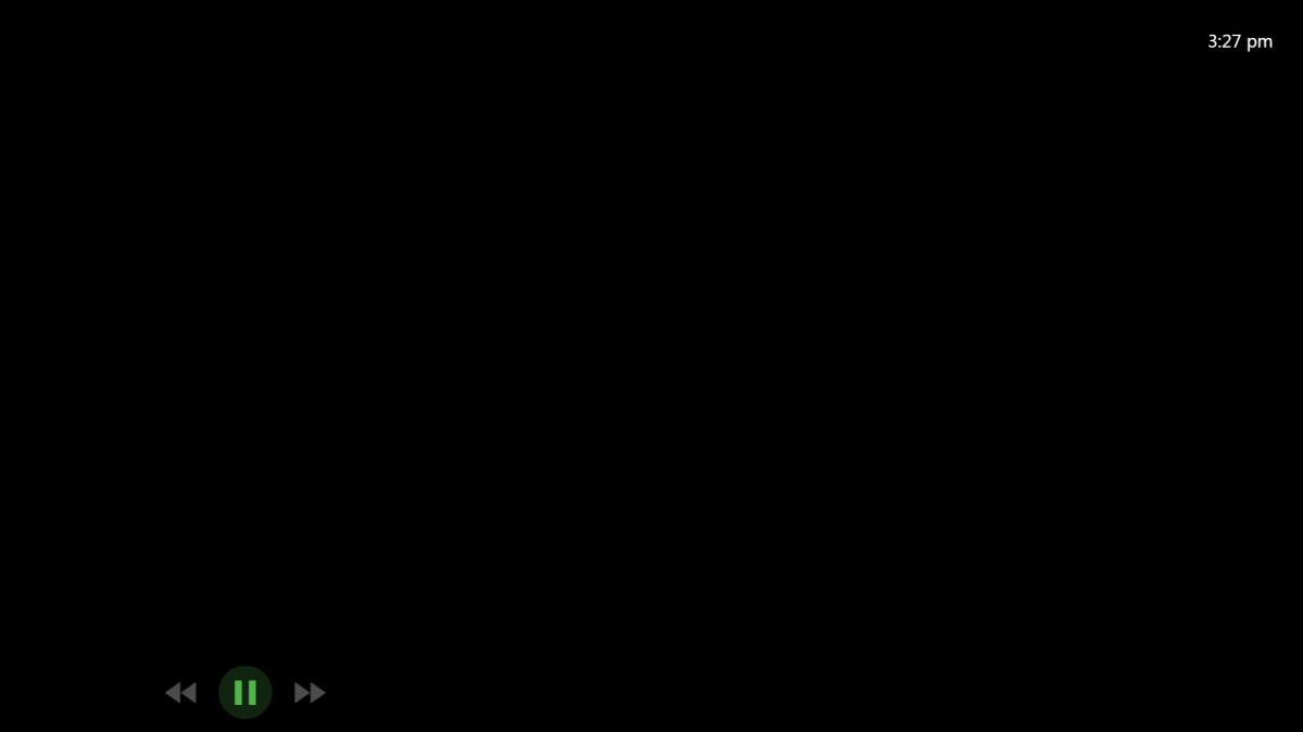

Guest asrequested Posted November 14, 2016 Posted November 14, 2016 Ok, I reinstalled the server, and it started working again. My suspicion had been correct - if using EVR+, in general it works (well, occasionally there would be a hiccup that would lead me back to here, but generally 99% is not only good enough, it's probably better than I had any right to except on those specs), when I started this thread EVR+ wasn't working at all, and I was using EVR (madvr gave unusable lag, I think I remember finding out from a previous problem that my pc just isn't strong enough to handle it). The problem now is that EVR+ stopped working again. When I try to play a movie with EVR+ now (it worked until I started installing plugins again), it does the same thing it did when this thread was started (screenshot attached), which holds at that screen until I exit out of the film, which was why I switched to EVR. To sum it all up, while I never make any absolute promises on anything, if I can get EVR+ working again, I'm reasonably certain that'll fix my problem. I just have no idea what changed (I uninstalled all of the plugins, so if it was a conflict there it should have been fixed). If anyone has any ideas, I'd be happy to hear them (also, on a different note, is there some way to backup watched status, special feature descriptions, that sort of thing? I reinstall server when I have to, but reentering all of that can be a bit of a pain). Also, since operating systems were brought up, I'm using Windows 7 Home Premium, for whatever that's worth. The only way the server would affect playback is if its transcoding or direct streaming. As for your plugins and screenshot, do you have cinema mode enabled in ET? A sample file would also really help, here.

rblu19 3 Posted November 14, 2016 Author Posted November 14, 2016 The only way the server would affect playback is if its transcoding or direct streaming. As for your plugins and screenshot, do you have cinema mode enabled in ET? A sample file would also really help, here. Ok, how would I capture this sample, or is it just a bit of raw video file? Really, the problem is pretty much now a bit of video lag at this point, just enough to be too noticeable, it's pretty much settled at video following audio. As I've said before, it's probably just that my computer is too underpowered to play it without any sort of compensation (e.g. a video processing setting or something of that nature), but that the problem comes down to that compensation has ceased to work, while it used to in the past.
