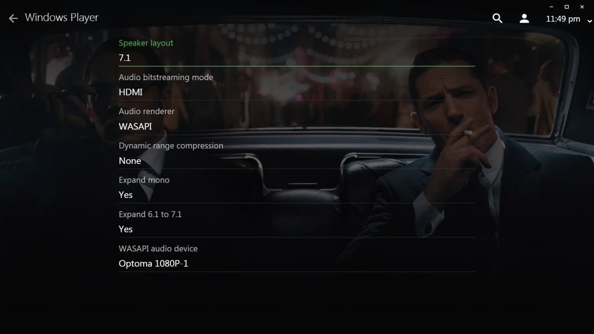

rblu19 3 Posted November 12, 2016 Author Posted November 12, 2016 Sorry it's taking so long, it's been a long day. For the record, while I've played around with the settings a bit (to no avail), when the problem started I was still using settings I had been using for awhile. I gave the test one more shot, and in addition to the settings screenshots, logs of the test are also attached, for whatever they may be worth. server-63614501887.txt theater-63614504517.txt
Guest asrequested Posted November 12, 2016 Posted November 12, 2016 So in your audio settings, the Optoma is a projector? If yes, is the projector connected directly to an AVR?
rblu19 3 Posted November 12, 2016 Author Posted November 12, 2016 Yes. The pc connects to the monitor through the avr. I mean, I'm open to the idea that my pc isn't fast enough (I'm running this on a nettop, and the movies used for the test are Blu-ray rips), but if that's the case there has to be some combination of settings that overcomes that obstacle, because I've been playing them fine for years.

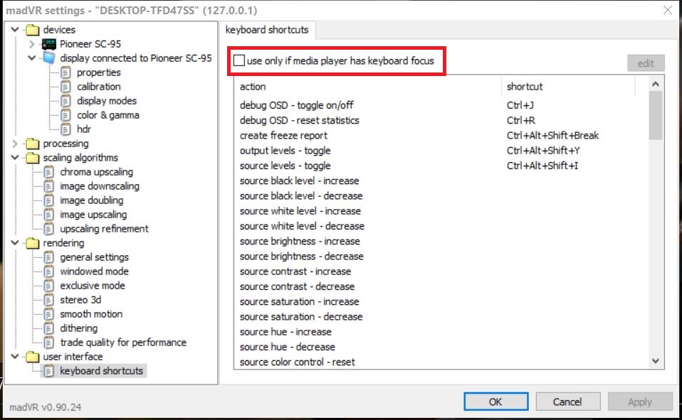

Guest asrequested Posted November 13, 2016 Posted November 13, 2016 Well, If you wanted to try, you can delete the LAV filters, download LAV from here and replace what you deleted. But there maybe a hardware issue in your computer, that is causing the GPU to drop frames, or something like that. If you use the MadVR filter, open the settings from the tray icon, uncheck the box in the picture below and press ctrl + j. You can look and see if it's dropping or repeating frames.
