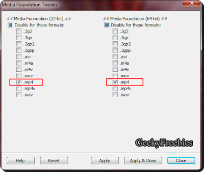

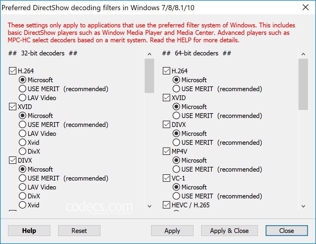

Deihmos 170 Posted January 22, 2014 Posted January 22, 2014 (edited) Windows can already play most of the video and audio formats with just the lav splitter. You need to use win7dsfilter to change the preferred codecs that are used for playback. For mp4, avi and some other formats you will need to disable them in media foundation for lav to take over. Why did you have to use a different player with XBMC? It can already play everything nice. Here are the screenshots. Edited January 22, 2014 by Deihmos
