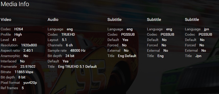

Hiller131 0 Posted November 11, 2016 Author Posted November 11, 2016 New log sent 11:24 EST. No fix using the beta app. Media Info is attached.

ebr 16337 Posted November 12, 2016 Posted November 12, 2016 Okay, please make sure you try the beta that went up last night (.75). It should play it as well. Also, does the AVR in question support TrueHD?
Hiller131 0 Posted November 13, 2016 Author Posted November 13, 2016 Working with the new beta! Thank you! Any idea what happened?
ebr 16337 Posted November 13, 2016 Posted November 13, 2016 I think it was related to the 3.3 update on the Shield. Before that, we were able to downmix TrueHD as straight DD. Now we can't.
