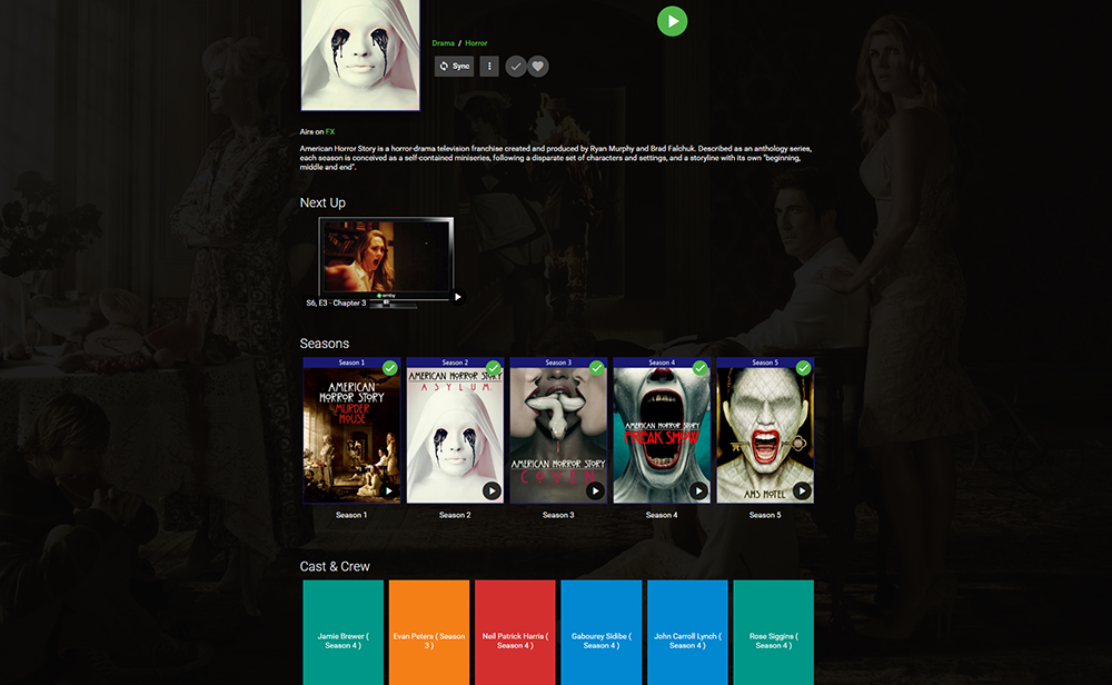

phi303 14 Posted November 10, 2016 Posted November 10, 2016 I too am having a metadata issue. Looking through the logs I don't seem to have the same write permissions issue as OP. My server doesn't seem to want to update metadata but new episodes do show up without "real" association (sorry if that doesn't make sense). I'm going to use "American Horror Story" as an example: I've attached both a log and a few screenshots. The first screenshot the server shows that a new episode from the new season is available as "next up" but the season associated with that new episode does not show up, nor does it show up in metadata manager. The second screenshot is where I land if I follow the "Season 6" breadcrumb (next to the show title): again there are episodes available there but there's a lot of missing data. This isn't really much of a problem when I'm viewing content locally (on Kodi) but trying to view remotely (on the android app) it is a huge issue. It seems that if there it isn't in the metadata content cannot be played remotely. The last screenshot is of the metadata manager, there is no "Season 6". Log.txt
Luke 42288 Posted November 10, 2016 Posted November 10, 2016 I too am having a metadata issue. Looking through the logs I don't seem to have the same write permissions issue as OP. My server doesn't seem to want to update metadata but new episodes do show up without "real" association (sorry if that doesn't make sense). I'm going to use "American Horror Story" as an example: I've attached both a log and a few screenshots. The first screenshot the server shows that a new episode from the new season is available as "next up" but the season associated with that new episode does not show up, nor does it show up in metadata manager. The second screenshot is where I land if I follow the "Season 6" breadcrumb (next to the show title): again there are episodes available there but there's a lot of missing data. This isn't really much of a problem when I'm viewing content locally (on Kodi) but trying to view remotely (on the android app) it is a huge issue. It seems that if there it isn't in the metadata content cannot be played remotely. The last screenshot is of the metadata manager, there is no "Season 6". Hi, interesting. What does the folder structure for that series look like? have you tried running a library scan?

phi303 14 Posted November 10, 2016 Posted November 10, 2016 (edited) Hi, interesting. What does the folder structure for that series look like? have you tried running a library scan? The folder structure is Series>episodes Each season does not have their own folder, is that an issue? Edited November 10, 2016 by phi303
Luke 42288 Posted November 10, 2016 Posted November 10, 2016 The folder structure is Series>episodes Each season does not have their own folder, is that an issue? Can we see a screenshot of that series folder? thanks !
phi303 14 Posted November 10, 2016 Posted November 10, 2016 Can we see a screenshot of that series folder? thanks ! yes of course. attached below. this isn't the only series that this happens to, it's nearly everything.
Luke 42288 Posted November 10, 2016 Posted November 10, 2016 Have you tried running a library scan? when you first import the episode file does it already come with an nfo or is there none?
phi303 14 Posted November 10, 2016 Posted November 10, 2016 Have you tried running a library scan? when you first import the episode file does it already come with an nfo or is there none? Yes I have run library scan multiple times. Info file is generated by the emby server - I just drop in the media by itself. I noticed that in the series that there's a specified "end date" and for some reason that field seems to have been automatically populated, if I delete the end date and then refresh the metadata, it seems to fix the issue for that one series. is there a way for me to batch delete "end date:"?
Luke 42288 Posted November 10, 2016 Posted November 10, 2016 It's not related to end date, it's just related to the act of refreshing. if you do that for now it may help fill in those missing season numbers. I will look into why that's not happening on the import. thanks.
phi303 14 Posted November 10, 2016 Posted November 10, 2016 (edited) It's not related to end date, it's just related to the act of refreshing. if you do that for now it may help fill in those missing season numbers. I will look into why that's not happening on the import. thanks. Thank you. Is there a way to mass update the metadata or do I have to go into each individual series and manually refresh? Edit: I also do not use the automatic import because that feature doesn't seem to work correctly for me, I manually drop new media into their folders. (if that's any help). Edited November 10, 2016 by phi303
Luke 42288 Posted November 10, 2016 Posted November 10, 2016 Yes, use the metadata manager tool and just select a top level folder and then refresh that folder. Please note, there will be no way to monitor the process but it will do the job. You may just want to let it go for a couple hours. 1
