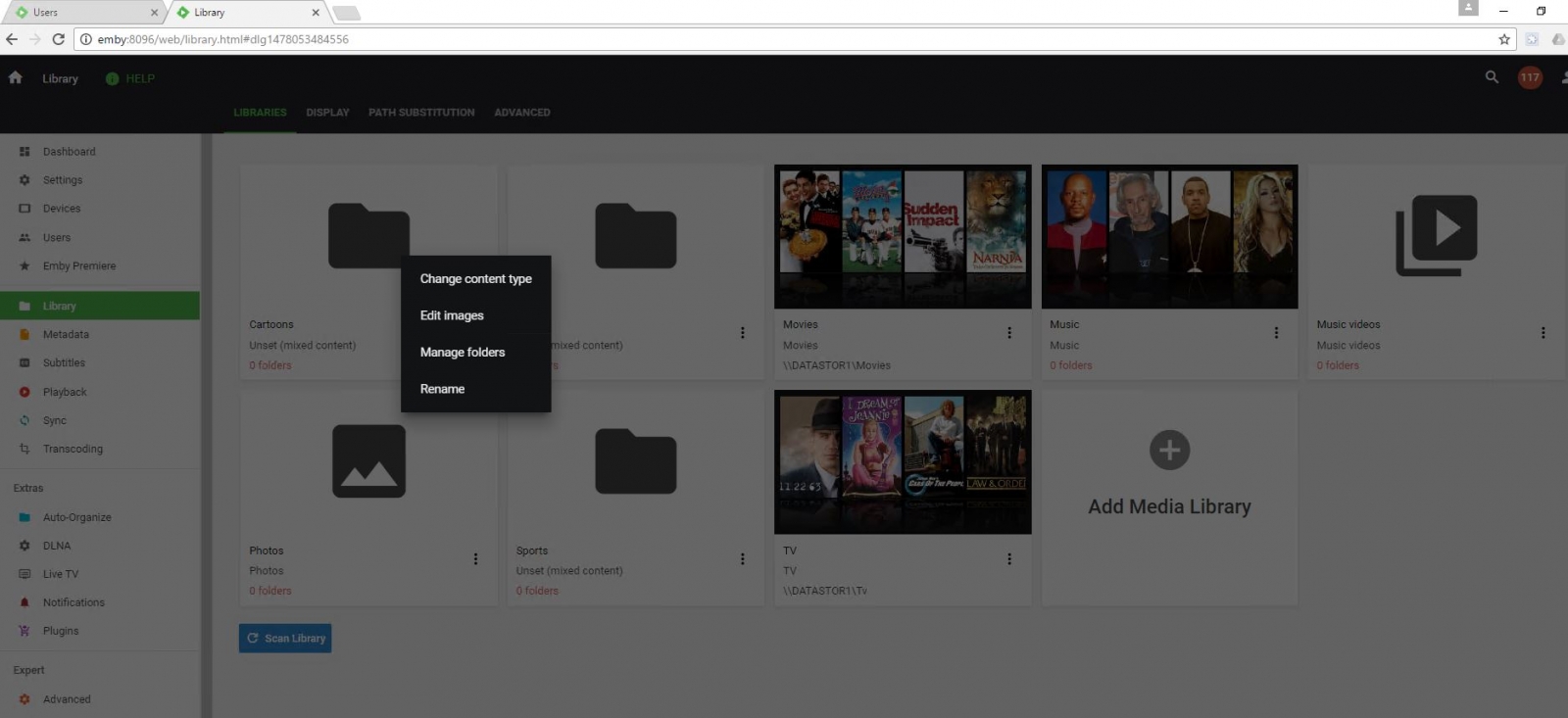

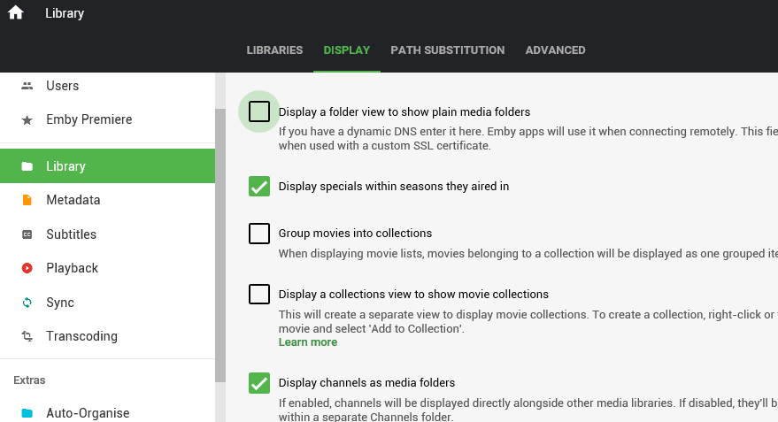

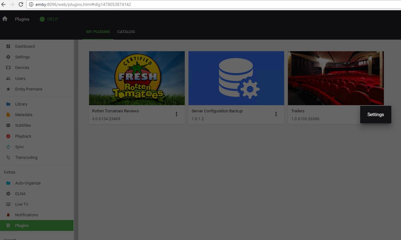

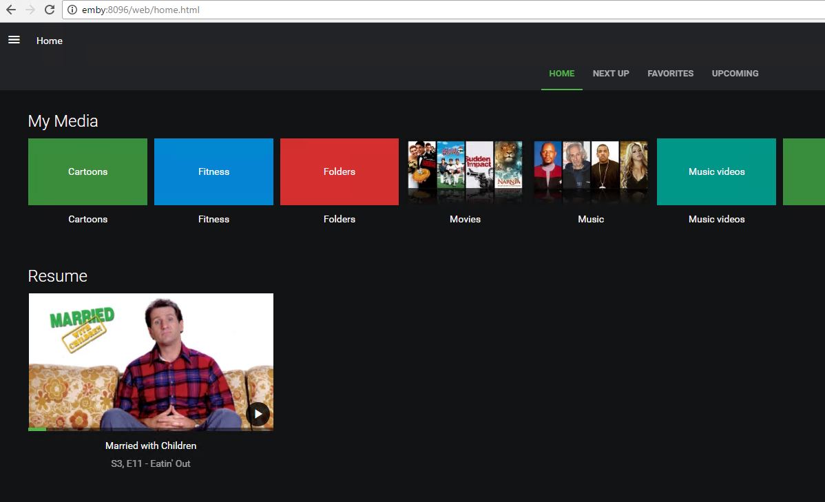

dcook 303 Posted November 2, 2016 Posted November 2, 2016 (edited) So I just updated to Version 3.0.8400.0 and now have some issues. 1) I can no longer delete libraries, I tried restarting, tried different users, checked everywhere in settings I can think of, and while there is an Add Library button, but the delete library option is missing. I was able to remove the folders from the library, but not remove the library itself. Screen capture: 2) I now have a Folder icon on my home screen for users, how do I remove that? I didn't choose to to have that I did a quick search on here and there were some posts that this can be disabled in user preferences, but I could not find the setting. Screen capture; 3) When I goto my plugins, there is no uninstall option anymore for any of the plugins, only a settings option. Screen Capture: Also on another note, I had my library scan settings all setup how I wanted, and now I find that all my settings have been changed for each library, for example the real time monitoring was turned back on when I had specifically turned it off. When you are updating the server, can you please respect the user settings and don't change them? We as users should not have to go through and change back all settings after server updates. Edited November 2, 2016 by dcook
denz 501 Posted November 2, 2016 Posted November 2, 2016 (edited) To remove folder you have to go to library and under display. I had trouble finding it at first. Not sure about the plugins or the delete as I am on beta server. Edited November 2, 2016 by denz
Luke 42186 Posted November 2, 2016 Posted November 2, 2016 That's really quite strange. It appears on two different screens your action menus are missing options. If you try the online web app, does the issue occur there? http://app.emby.media Thanks.
dcook 303 Posted November 2, 2016 Author Posted November 2, 2016 When I connect via app.emby.media the Remove Library and Uninstall plugin options are there. When I connect like I always did in the past: servername:8096 those options are not there.
dcook 303 Posted November 2, 2016 Author Posted November 2, 2016 Luke any idea what the issue is? I have restarted and no change when using the Server Management locally http://servername:8096
Koleckai Silvestri 1154 Posted November 2, 2016 Posted November 2, 2016 Do you have custom CSS installed? If so, do the missing options appear if you remove it?
