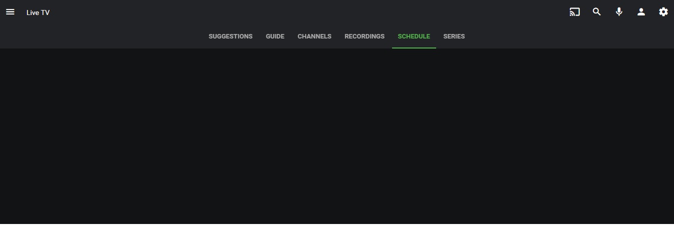

mjktg99 35 Posted November 1, 2016 Posted November 1, 2016 I cannot see any scheduled recordings. IE, Chrome, Android, Ember.. I am using ServerWMC and on server Version 3.0.8400.0 The scheduled tab is just blank. I can see recordings as they are happening and after they are recorded, just not the schedule.

Noel-M 11 Posted November 11, 2016 Posted November 11, 2016 I am using Emby Server 3.0.8500.0 with ServerWMC 1.0.0.73 Just wanted to say that I also have an empty SCHEDULE screen

Noel-M 11 Posted November 13, 2016 Posted November 13, 2016 I have installed the stable release - nothing else. Server log attached showing - restart - login - live tv / channels (scheduled recordings show correctly) - live tv / schedule (empty) server-63614654171.txt

Noel-M 11 Posted November 13, 2016 Posted November 13, 2016 Guys, I am in timezone UTC+10 - so responses not immediate. Log attached - created while I took the attached pics. ServerWMC.log
krustyreturns 191 Posted November 14, 2016 Posted November 14, 2016 From the serverwmc log: 2016/11/14 09:14:53.759 Received client request: MediaBrowser^@BUSTER@|::1|GetTimers 2016/11/14 09:14:53.759 GetTimersCached> Cached timers[52] returned to 'Emby^BUSTER' in 0.00 sec 2016/11/14 09:14:53.759 Finished request GetTimers in 0.00s The above says it returned 52 timers (upcoming scheduled recordings) to emby when it requested them. So I am sticking with my idea that you are actually running emby's new tv interface even though that's not supposed to be the case. If you want to test this, download the emby beta and then you'll get serverwmc plugin version 1.0.0.81, and I bet this problem goes away. I certainly understand why you'd rather not do this, but unless some emby guy can say why this is happening, its really all I can think of. Disclaimer: I am frequently wrong.
