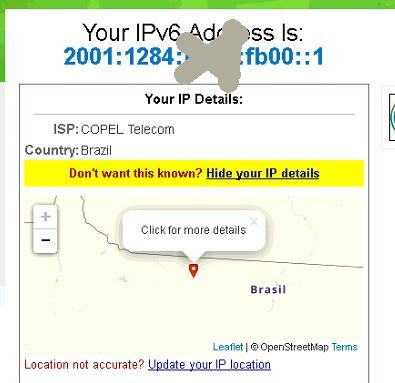

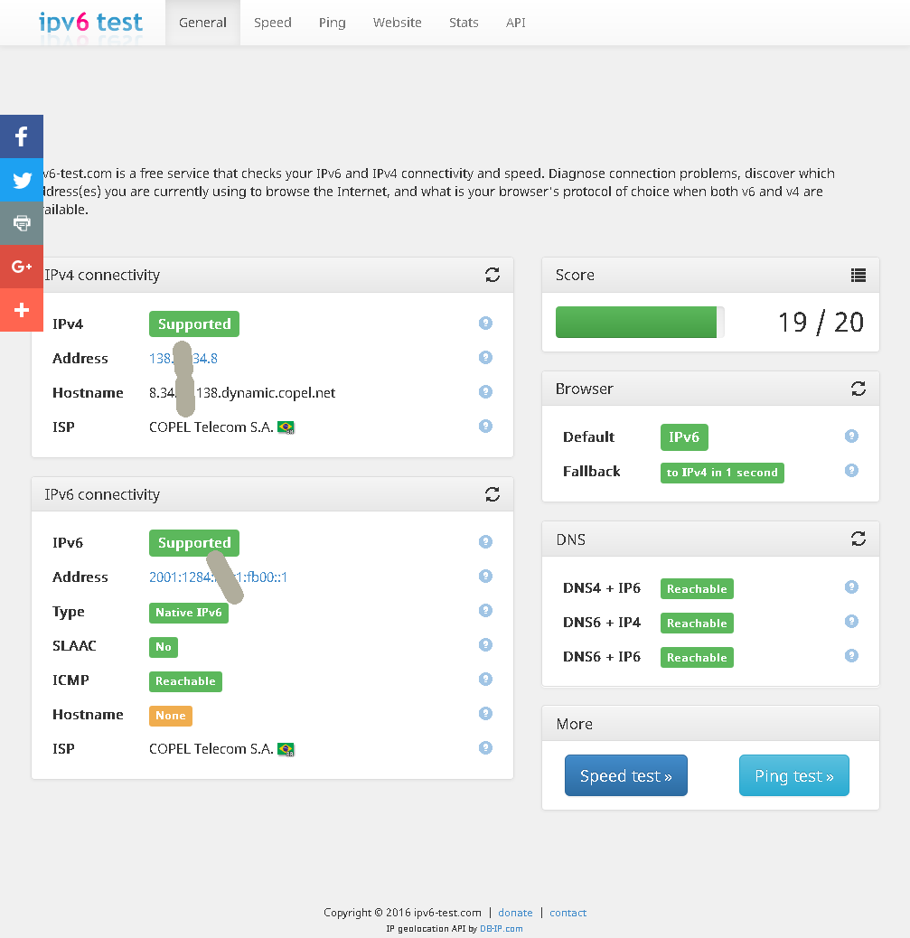

gsites 14 Posted October 30, 2016 Posted October 30, 2016 Hello, I found the EMBY and I'm amazed how fantastic this project. But, I have some problems for external connection. My ISP provides only CGNAT along with IPV6. I'm sending the images to see if I can find help if anyone can help me or show any tutorial, I will be even happier. My friends can't watch outside of my network. Thank you

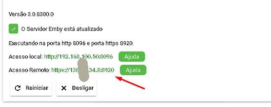

gsites 14 Posted November 2, 2016 Author Posted November 2, 2016 Thanks for the tips, I tested all of them, but it didn't work right for me. Please see the image below, and tell me how to put the IPV6 address in the place where only appears the IPV4 http://image.prntscr.com/image/dec2b99b05014fa99d2e6fdfae576b29.jpeg Thanks again

gsites 14 Posted November 8, 2016 Author Posted November 8, 2016 Now I was able to open the doors to the emby, but it does not connect, see the images please I created a user for you take the test, please user: x6apass: 112233 Thanks for your helping

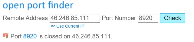

Happy2Play 9801 Posted November 8, 2016 Posted November 8, 2016 (edited) Unable to connect, when I check that ip it shows closed. Edited November 8, 2016 by Happy2Play
gsites 14 Posted November 8, 2016 Author Posted November 8, 2016 Hello, The emby server was disconnected. Please see that this opened the door I'm putting a standard user so they can try to access and tell me if they can. user: x6apass: 112233 Thank you
Happy2Play 9801 Posted November 8, 2016 Posted November 8, 2016 Unless your offline, that ip shows closed also.
Luke 42186 Posted November 9, 2016 Posted November 9, 2016 What about 8096? Remember, 8096 is for http, 8920 for https.
gsites 14 Posted November 9, 2016 Author Posted November 9, 2016 Thanks for the tips and support. I think now it's working Please visit if possible USER pcx6 PASS 111222333 Thank you
