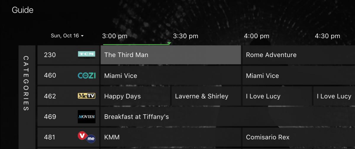

Vitale4 15 Posted October 16, 2016 Author Posted October 16, 2016 (edited) I don't see any grid icon to the left of the date... I have attached a photo from EMBY... Edited October 16, 2016 by Vitale4

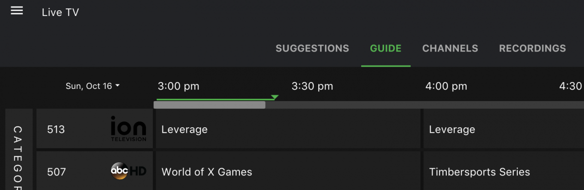

Vitale4 15 Posted October 16, 2016 Author Posted October 16, 2016 and this image is from EMBY Theatre
blade005 185 Posted October 17, 2016 Posted October 17, 2016 (edited) I don't see any grid icon to the left of the date... I have attached a photo from EMBY... Vitale4, I had the same issue when they first implemented this feature. The issue is with the DIsplay Resolution of your system. I have a HTPC that runs at 1920 x 1080 and the grid icon that ebr mentions shows up in both the Web UI and Emby Theater. I have another HTPC that has a display resolution of 1280 x 800 that matches the native resolution of the projector it is running on and the grid icon does not show in either the Web UI or Emby Theater. It also does not show up in the Android App on my 8-inch nVidia tablet. I usually just make the changes on my 1080p system, or I have to temporarily adjust the display resolution on my other system to something higher to view this grid icon and make any changes. I think your setting has probably defaulted to sort by RECENTLY WATCHED. If you change your display resolution to a higher setting, if possible, then you will see this grid and can change sort to CHANNEL NUMBER and also make the selection to place your FAVORITE channels at the top of the grid. I hope the devs may consider a different location and/or placement of this setting to avoid this in the future with lower resolution systems. Edited October 17, 2016 by blade005
Vitale4 15 Posted October 17, 2016 Author Posted October 17, 2016 That did the trick. Was not aware that the grid was there. Changed resolution and voila, it appeared. After changing it from recently recently watched to Channel order moved some of the channels. I then realized I had to uncheck the show favorites first. Not sure how the favorites got set, will need to look into it. In any regards - thanks for the help - I am good now...
