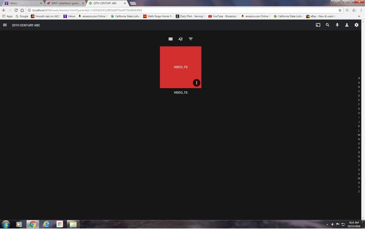

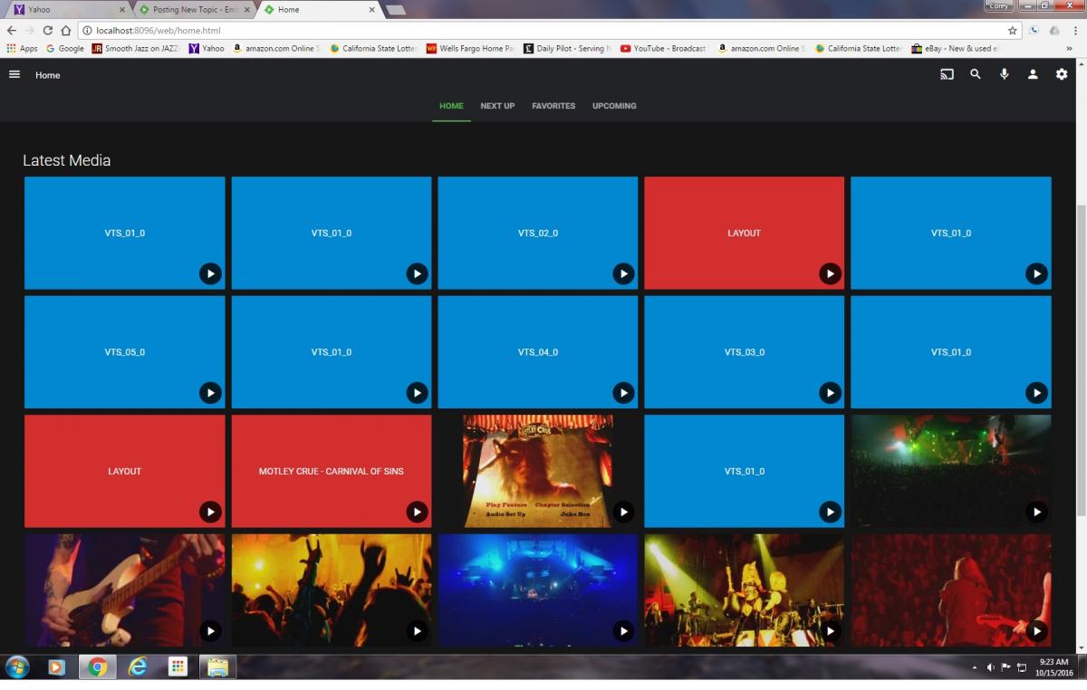

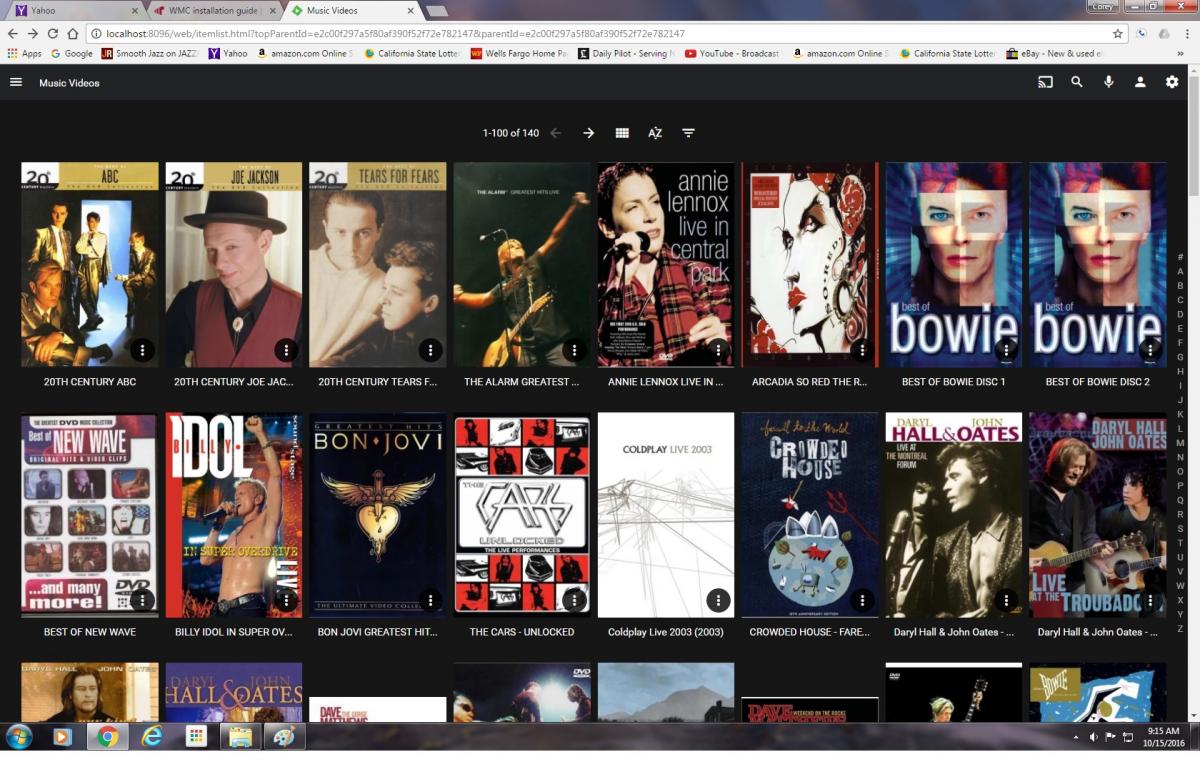

topraider 0 Posted October 15, 2016 Posted October 15, 2016 Ok having a problem with my DVD Music videos, I cannot print the screen in WMC for what's going on, but I did print it from the dash board. When I open Emby WMC and try to play a DVD Music video all it shows me is Video_TS and Audio_TS folder cannot played them. Also the cover art will not work also? It work great all the time until the new update for the Emby Server. I attach the server if this helps. server-63612086400.txt

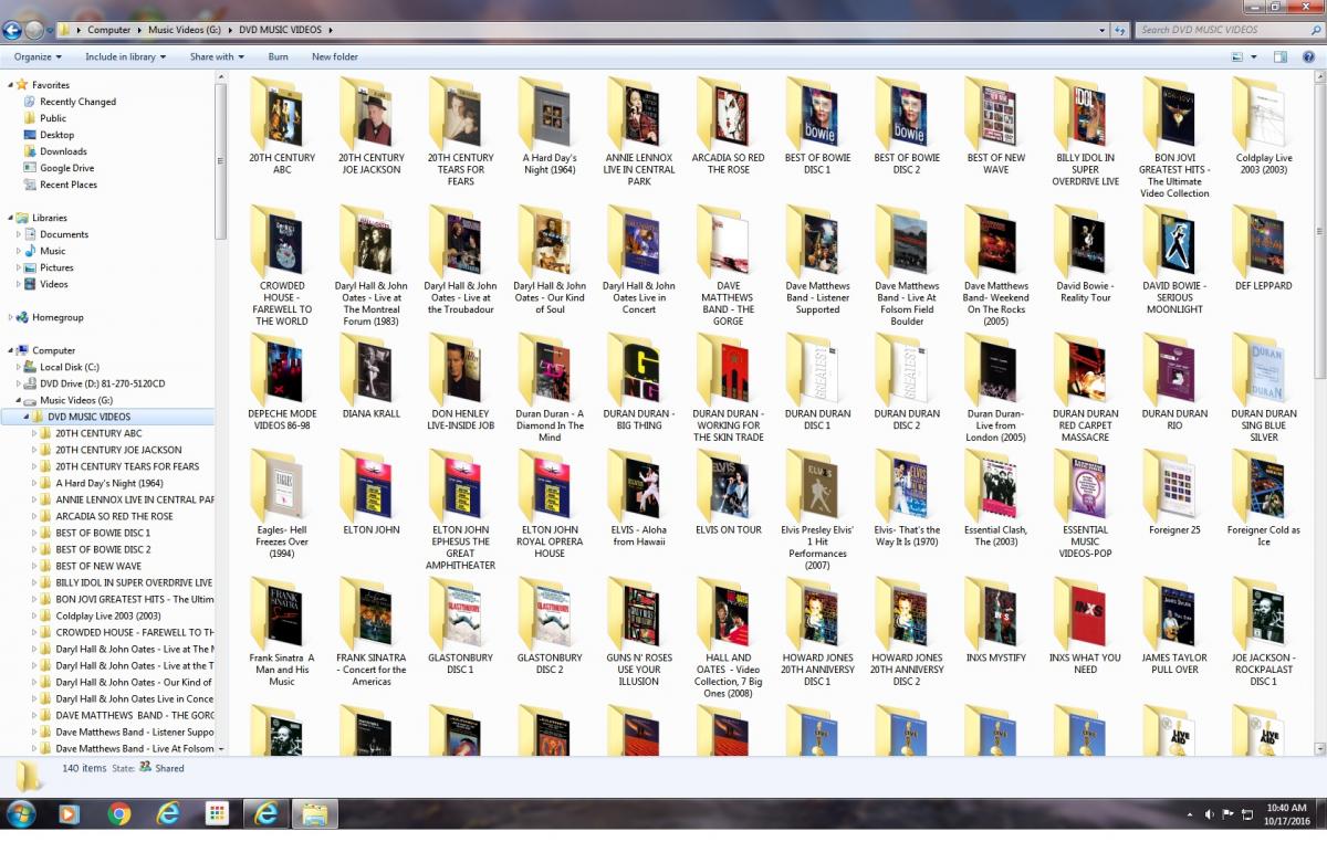

ebr 16307 Posted October 15, 2016 Posted October 15, 2016 This is some sort of library structure issue I'm sure. Please post screen shots of the structure and contents of the physical folders and details of how you have the library setup. Thanks.

topraider 0 Posted October 17, 2016 Author Posted October 17, 2016 Before I install the dev. release, here's the folder structure, I have had this set up this way for years even when it was Media Browser.
