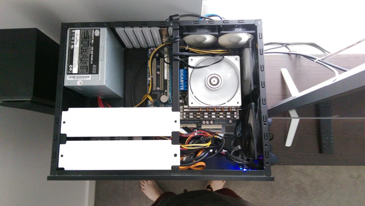

ultimatejoe 0 Posted October 15, 2016 Author Posted October 15, 2016 The client/server are the same machine, and I'm monitoring with Task Manager. Ideally I like it running at under 30% during video playback, with Emby Theatre it's between 30-45% and with the browser interface it's between 40-55%. My HTPC case is really tight and I have trouble cooling it; sustained activity over 40% causes it to run hotter than I would like.
jds828 24 Posted October 16, 2016 Posted October 16, 2016 Without doubt the live TV picture isn't up to the mark on Emby. I find I use Kodi at home and Emby when I'm out and about. As for your heat and performance issues, it might be worth letting us know what system build you're running and from there we might be able to offer you some ideas on getting it leveled out.
ultimatejoe 0 Posted October 16, 2016 Author Posted October 16, 2016 Thanks, but I'm afraid there's not too much mystery to it. I'm running an AMD Phenom 2 x965 BE, for Windows 10. There's no video card so the onboard chip does all the video processing. The issue is the case, which is a Fractal Designs Node 605 htpc. Looks great, but only has about 2 inches of clearance above the CPU fan, and it just doesn't cool enough. There's no room for a liquid cooler either.
jds828 24 Posted October 17, 2016 Posted October 17, 2016 I think you'd get a small liquid cooler in there without too much trouble. That's pretty much like one I did for a friend. Same thing with a toasty AMD chip in a case with low air flow. What worked best was a single 120mm Antec liquid cooler that cost about £35 from Scan UK. He had spend on good air coolers but it still go very hot. In his case, liquid sorted it and quietened it down too. I'm sure you know your system better than I do but it might be worth having another look at liquid (single fan-120mm rad) Getting the pipes right is usually the most trouble in small cases.
ultimatejoe 0 Posted October 23, 2016 Author Posted October 23, 2016 Thanks for the suggestion, but I've looked. There are three spots for 120MM fans, and none of them have more than an inch of clearance before you run into a motherboard component or the optical drive. I could fit a dual 80mmx80m, but I don't think there are any to buy.
jds828 24 Posted October 23, 2016 Posted October 23, 2016 Cant say I've ever seen a twin 80mm one. Not sure what's inside the Corsair Mini ITX one but they are quite expensive. If I see anything, I'll let you know.
ultimatejoe 0 Posted October 23, 2016 Author Posted October 23, 2016 You can buy radiator blocks online, but no all-in-one solutions. There's also this sucker, but it only works on Mini-ATX and I've got a micro board... http://www.corsair.com/en-ca/hydro-series-h5-sf-low-profile-liquid-cpu-cooler
