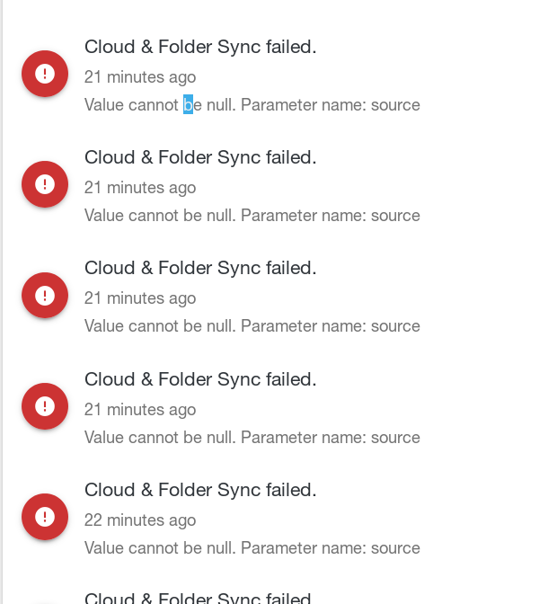

tobedeleted 4 Posted October 11, 2016 Posted October 11, 2016 All of sudden, with no change that I'm aware of, Emby gives me lots of errors. I noticed it because no sync is possible, but looking in the logs I found lots of other, similar issues which are not so obvious as they give no error in the Emby UI. So the error might indeed be there since longer and I just didn't notice it. The usually stuff works, but a lot of things seem to fail in the background. This is on openSUSE Tumbleweed 64bit with all current packages. I include a few excerpts of the log file. Unfortunately, the logs don't give me a hint where to look for a solution.Maybe somebody can give me a hint?! errors.txt
tobedeleted 4 Posted October 11, 2016 Author Posted October 11, 2016 Here the error message concerning the cloud and folder sync.

tobedeleted 4 Posted October 17, 2016 Author Posted October 17, 2016 (edited) Cannot anybody explain me why every sync I try ends with the following error: 2016-10-17 05:36:04.3093 Info TaskManager: Executing Cloud & Folder Sync 2016-10-17 05:36:04.3332 Error TaskManager: Error *** Error Report *** Version: 3.0.8100.0 Command line: /usr/lib/emby-server/bin/MediaBrowser.Server.Mono.exe -programdata /var/lib/emby-server -ffmpeg /usr/bin/ffmpeg -ffprobe /usr/bin/ffprobe -restartpath /usr/lib/emby-server/restart.sh Operating system: Unix 4.7.6.1 Processor count: 4 64-Bit OS: True 64-Bit Process: True Program data path: /var/lib/emby-server Mono: 4.6.1 (Stable 4.6.1.3/abb06f1 Tue Oct 4 15:17:01 UTC 2016) Application Path: /usr/lib/emby-server/bin/MediaBrowser.Server.Mono.exe Value cannot be null. Parameter name: source System.ArgumentNullException at System.Linq.Enumerable.ToList[TSource] (System.Collections.Generic.IEnumerable`1[T] source) [0x00010] in <63992662b765477a898ef49cdcc99ee2>:0 at MediaBrowser.Server.Implementations.Sync.TargetDataProvider+<GetData>c__async3`1[T].MoveNext () [0x0009f] in <4a59339cc47b4bd9b6c247a3d8356650>:0 --- End of stack trace from previous location where exception was thrown --- at System.Runtime.ExceptionServices.ExceptionDispatchInfo.Throw () [0x0000c] in <dca3b561b8ad4f9fb10141d81b39ff45>:0 at System.Runtime.CompilerServices.TaskAwaiter.ThrowForNonSuccess (System.Threading.Tasks.Task task) [0x0004e] in <dca3b561b8ad4f9fb10141d81b39ff45>:0 at System.Runtime.CompilerServices.TaskAwaiter.HandleNonSuccessAndDebuggerNotification (System.Threading.Tasks.Task task) [0x0002e] in <dca3b561b8ad4f9fb10141d81b39ff45>:0 at System.Runtime.CompilerServices.TaskAwaiter.ValidateEnd (System.Threading.Tasks.Task task) [0x0000b] in <dca3b561b8ad4f9fb10141d81b39ff45>:0 at System.Runtime.CompilerServices.ConfiguredTaskAwaitable`1+ConfiguredTaskAwaiter[TResult].GetResult () [0x00000] in <dca3b561b8ad4f9fb10141d81b39ff45>:0 at MediaBrowser.Server.Implementations.Sync.MediaSync+<SyncData>c__async1.MoveNext () [0x0008a] in <4a59339cc47b4bd9b6c247a3d8356650>:0 --- End of stack trace from previous location where exception was thrown --- at System.Runtime.ExceptionServices.ExceptionDispatchInfo.Throw () [0x0000c] in <dca3b561b8ad4f9fb10141d81b39ff45>:0 at System.Runtime.CompilerServices.TaskAwaiter.ThrowForNonSuccess (System.Threading.Tasks.Task task) [0x0004e] in <dca3b561b8ad4f9fb10141d81b39ff45>:0 at System.Runtime.CompilerServices.TaskAwaiter.HandleNonSuccessAndDebuggerNotification (System.Threading.Tasks.Task task) [0x0002e] in <dca3b561b8ad4f9fb10141d81b39ff45>:0 at System.Runtime.CompilerServices.TaskAwaiter.ValidateEnd (System.Threading.Tasks.Task task) [0x0000b] in <dca3b561b8ad4f9fb10141d81b39ff45>:0 at System.Runtime.CompilerServices.ConfiguredTaskAwaitable+ConfiguredTaskAwaiter.GetResult () [0x00000] in <dca3b561b8ad4f9fb10141d81b39ff45>:0 at MediaBrowser.Server.Implementations.Sync.MediaSync+<Sync>c__async0.MoveNext () [0x000ed] in <4a59339cc47b4bd9b6c247a3d8356650>:0 --- End of stack trace from previous location where exception was thrown --- at System.Runtime.ExceptionServices.ExceptionDispatchInfo.Throw () [0x0000c] in <dca3b561b8ad4f9fb10141d81b39ff45>:0 at System.Runtime.CompilerServices.TaskAwaiter.ThrowForNonSuccess (System.Threading.Tasks.Task task) [0x0004e] in <dca3b561b8ad4f9fb10141d81b39ff45>:0 at System.Runtime.CompilerServices.TaskAwaiter.HandleNonSuccessAndDebuggerNotification (System.Threading.Tasks.Task task) [0x0002e] in <dca3b561b8ad4f9fb10141d81b39ff45>:0 at System.Runtime.CompilerServices.TaskAwaiter.ValidateEnd (System.Threading.Tasks.Task task) [0x0000b] in <dca3b561b8ad4f9fb10141d81b39ff45>:0 at System.Runtime.CompilerServices.ConfiguredTaskAwaitable+ConfiguredTaskAwaiter.GetResult () [0x00000] in <dca3b561b8ad4f9fb10141d81b39ff45>:0 at MediaBrowser.Server.Implementations.Sync.MultiProviderSync+<Sync>c__async0.MoveNext () [0x0024f] in <4a59339cc47b4bd9b6c247a3d8356650>:0 --- End of stack trace from previous location where exception was thrown --- at System.Runtime.ExceptionServices.ExceptionDispatchInfo.Throw () [0x0000c] in <dca3b561b8ad4f9fb10141d81b39ff45>:0 at System.Runtime.CompilerServices.TaskAwaiter.ThrowForNonSuccess (System.Threading.Tasks.Task task) [0x0004e] in <dca3b561b8ad4f9fb10141d81b39ff45>:0 at System.Runtime.CompilerServices.TaskAwaiter.HandleNonSuccessAndDebuggerNotification (System.Threading.Tasks.Task task) [0x0002e] in <dca3b561b8ad4f9fb10141d81b39ff45>:0 at System.Runtime.CompilerServices.TaskAwaiter.ValidateEnd (System.Threading.Tasks.Task task) [0x0000b] in <dca3b561b8ad4f9fb10141d81b39ff45>:0 at System.Runtime.CompilerServices.ConfiguredTaskAwaitable+ConfiguredTaskAwaiter.GetResult () [0x00000] in <dca3b561b8ad4f9fb10141d81b39ff45>:0 at MediaBrowser.Common.Implementations.ScheduledTasks.ScheduledTaskWorker+<ExecuteInternal>c__async2.MoveNext () [0x0019c] in <4e270818b95c41dcb6171e3a9c599552>:0 2016-10-17 05:36:04.3332 Info TaskManager: Cloud & Folder Sync Failed after 0 minute(s) and 0 seconds Edited October 17, 2016 by Larx
Luke 42244 Posted October 17, 2016 Posted October 17, 2016 Well that's what I'm trying to figure out. What is the sync destination? Is it folder sync?

tobedeleted 4 Posted October 17, 2016 Author Posted October 17, 2016 I'm using folder sync. The permissions of the destination folder are OK.

tobedeleted 4 Posted October 17, 2016 Author Posted October 17, 2016 OK, so this isn't the reason why I cannot transcode anymore. I just deleted all sync jobs, but also when adding any new folder sync job I get the error "value cannot be null. Parameter: source". The source files are readable (and playable) by Emby, btw.
tobedeleted 4 Posted November 6, 2016 Author Posted November 6, 2016 Answer took a bit because my Internet access was broken, sorry. In the meanwhile, I also have Emby updated to the latest release, and there is no change. I attach the log right after - restart the emby server - manually starting the (usually scheduled) sync job (folder sync) - and the sync doesn't even really start but fails after 0 secs. I don't get any clue out of the logs! 2016-11-06 12:13:24.5443 Info Main: Emby Command line: /usr/lib/emby-server/bin/MediaBrowser.Server.Mono.exe -programdata /var/lib/emby-server -ffmpeg /usr/bin/ffmpeg -ffprobe /usr/bin/ffprobe -restartpath /usr/lib/emby-server/restart.sh Operating system: Unix 4.8.6.1 Processor count: 4 64-Bit OS: True 64-Bit Process: True Program data path: /var/lib/emby-server Mono: 4.6.1 (Stable 4.6.1.5/ef43c15 Sat Oct 22 13:52:40 UTC 2016) Application Path: /usr/lib/emby-server/bin/MediaBrowser.Server.Mono.exe 2016-11-06 12:13:24.7910 Info App: Application version: 3.0.8500.0 2016-11-06 12:13:24.8494 Info App: Application configuration: {"EnableUPnP":false,"PublicPort":8096,"Public":8443,"HttpServerPortNumber":8096,"Number":8443,"EnableHttps":false,"CertificatePath":"/usr/local/share/security/server.pfx","EnableInternetProviders":true,"IsPortAuthorized":true,"EnableCaseSensitiveItemIds":false,"MetadataPath":"","SeasonZeroDisplayName":"Specials","SaveLocalMeta":false,"PreferredMetadataLanguage":"de","MetadataCountryCode":"DE","SortReplaceCharacters":[".","+","%"],"SortRemoveCharacters":[",","&","-","{","}","'"],"SortRemoveWords":["the","a","an"],"MinResumePct":5,"MaxResumePct":90,"MinResumeDurationSeconds":300,"LibraryMonitorDelay":60,"EnableDashboardResponseCaching":true,"EnableDashboardResourceMinification":true,"DashboardSourcePath":"","ImageSavingConvention":"Compatible","MetadataOptions":[{"ItemType":"Book","ImageOptions":[{"Type":"Backdrop","Limit":1,"MinWidth":1280}],"DisabledMetadataSavers":[],"LocalMetadataReaderOrder":[],"DisabledMetadataFetchers":[],"MetadataFetcherOrder":[],"DisabledImageFetchers":[],"ImageFetcherOrder":[]},{"ItemType":"Movie","ImageOptions":[{"Type":"Primary","Limit":1,"MinWidth":0},{"Type":"Art","Limit":1,"MinWidth":0},{"Type":"BoxRear","Limit":1,"MinWidth":0},{"Type":"Banner","Limit":1,"MinWidth":0},{"Type":"Box","Limit":1,"MinWidth":0},{"Type":"Disc","Limit":1,"MinWidth":0},{"Type":"Logo","Limit":1,"MinWidth":0},{"Type":"Menu","Limit":1,"MinWidth":0},{"Type":"Thumb","Limit":1,"MinWidth":0},{"Type":"Backdrop","Limit":2,"MinWidth":800},{"Type":"Screenshot","Limit":1,"MinWidth":0}],"DisabledMetadataSavers":[],"LocalMetadataReaderOrder":["Nfo","Emby Xml"],"DisabledMetadataFetchers":[],"MetadataFetcherOrder":["The Open Movie Database","TheMovieDb"],"DisabledImageFetchers":[],"ImageFetcherOrder":["TheMovieDb","FanArt","The Open Movie Database","Screen Grabber"]},{"ItemType":"MusicVideo","ImageOptions":[{"Type":"Primary","Limit":1,"MinWidth":0},{"Type":"Art","Limit":1,"MinWidth":0},{"Type":"Banner","Limit":1,"MinWidth":0},{"Type":"Disc","Limit":1,"MinWidth":0},{"Type":"Logo","Limit":1,"MinWidth":0},{"Type":"Thumb","Limit":1,"MinWidth":0},{"Type":"Backdrop","Limit":2,"MinWidth":1280},{"Type":"Screenshot","Limit":1,"MinWidth":0}],"DisabledMetadataSavers":[],"LocalMetadataReaderOrder":["Nfo","Emby Xml"],"DisabledMetadataFetchers":[],"MetadataFetcherOrder":["TheMovieDb"],"DisabledImageFetchers":[],"ImageFetcherOrder":["TheMovieDb","FanArt","Screen Grabber"]},{"ItemType":"Series","ImageOptions":[{"Type":"Primary","Limit":1,"MinWidth":0},{"Type":"Art","Limit":1,"MinWidth":0},{"Type":"Banner","Limit":1,"MinWidth":0},{"Type":"Logo","Limit":1,"MinWidth":0},{"Type":"Thumb","Limit":1,"MinWidth":0},{"Type":"Backdrop","Limit":2,"MinWidth":1280},{"Type":"Screenshot","Limit":1,"MinWidth":0}],"DisabledMetadataSavers":[],"LocalMetadataReaderOrder":["Nfo","Emby Xml"],"DisabledMetadataFetchers":[],"MetadataFetcherOrder":["The Open Movie Database","TheTVDB","TheMovieDb"],"DisabledImageFetchers":[],"ImageFetcherOrder":["TheTVDB","FanArt","TheMovieDb"]},{"ItemType":"MusicAlbum","ImageOptions":[{"Type":"Primary","Limit":1,"MinWidth":0},{"Type":"Disc","Limit":1,"MinWidth":0},{"Type":"Backdrop","Limit":0,"MinWidth":1280},{"Type":"Screenshot","Limit":1,"MinWidth":0}],"DisabledMetadataSavers":[],"LocalMetadataReaderOrder":[],"DisabledMetadataFetchers":[],"MetadataFetcherOrder":["MusicBrainz","TheAudioDB"],"DisabledImageFetchers":[],"ImageFetcherOrder":["Image Extractor","FanArt","TheAudioDB"]},{"ItemType":"MusicArtist","ImageOptions":[{"Type":"Primary","Limit":1,"MinWidth":0},{"Type":"Art","Limit":1,"MinWidth":0},{"Type":"Banner","Limit":1,"MinWidth":0},{"Type":"Logo","Limit":1,"MinWidth":0},{"Type":"Backdrop","Limit":2,"MinWidth":1280},{"Type":"Screenshot","Limit":1,"MinWidth":0}],"DisabledMetadataSavers":[],"LocalMetadataReaderOrder":[],"DisabledMetadataFetchers":[],"MetadataFetcherOrder":["MusicBrainz","TheAudioDB"],"DisabledImageFetchers":[],"ImageFetcherOrder":["FanArt","TheAudioDB"]},{"ItemType":"BoxSet","ImageOptions":[{"Type":"Primary","Limit":1,"MinWidth":0},{"Type":"Art","Limit":1,"MinWidth":0},{"Type":"Banner","Limit":1,"MinWidth":0},{"Type":"Disc","Limit":1,"MinWidth":0},{"Type":"Logo","Limit":1,"MinWidth":0},{"Type":"Thumb","Limit":1,"MinWidth":0},{"Type":"Backdrop","Limit":2,"MinWidth":1280},{"Type":"Screenshot","Limit":1,"MinWidth":0}],"DisabledMetadataSavers":[],"LocalMetadataReaderOrder":[],"DisabledMetadataFetchers":[],"MetadataFetcherOrder":["TheMovieDb"],"DisabledImageFetchers":[],"ImageFetcherOrder":["TheMovieDb","FanArt"]},{"ItemType":"Season","ImageOptions":[{"Type":"Primary","Limit":1,"MinWidth":0},{"Type":"Banner","Limit":1,"MinWidth":0},{"Type":"Thumb","Limit":1,"MinWidth":0},{"Type":"Backdrop","Limit":1,"MinWidth":1280},{"Type":"Screenshot","Limit":1,"MinWidth":0}],"DisabledMetadataSavers":[],"LocalMetadataReaderOrder":["Nfo","Emby Xml"],"DisabledMetadataFetchers":[],"MetadataFetcherOrder":["TheMovieDb"],"DisabledImageFetchers":[],"ImageFetcherOrder":["TheTVDB","FanArt"]},{"ItemType":"Episode","ImageOptions":[{"Type":"Backdrop","Limit":0,"MinWidth":1280},{"Type":"Screenshot","Limit":1,"MinWidth":0}],"DisabledMetadataSavers":[],"LocalMetadataReaderOrder":["Nfo","Emby Xml"],"DisabledMetadataFetchers":["TheMovieDb"],"MetadataFetcherOrder":["TheTVDB","The Open Movie Database"],"DisabledImageFetchers":[],"ImageFetcherOrder":["TheTVDB","TheMovieDb","Screen Grabber"]},{"ItemType":"Video","ImageOptions":[{"Type":"Backdrop","Limit":3,"MinWidth":1280},{"Type":"Screenshot","Limit":1,"MinWidth":0}],"DisabledMetadataSavers":[],"LocalMetadataReaderOrder":["Nfo","Emby Xml"],"DisabledMetadataFetchers":[],"MetadataFetcherOrder":[],"DisabledImageFetchers":[],"ImageFetcherOrder":["Screen Grabber"]}],"EnableAutomaticRestart":false,"SkipDeserializationForBasicTypes":false,"SkipDeserializationForPrograms":false,"PathSubstitutions":[{"From":" /mnt/raid/Multimedia/","To":"/mnt/wolke/Multimedia/"},{"From":"/mnt/raid/Multimedia/","To":"nfs://wolke/srv/nfs/Multimedia/"}],"ServerName":"Dahoam-Medienserver","WanDdns":"dahoamnetz.selfhost.eu","UICulture":"de","PeopleMetadataOptions":{"DownloadActorMetadata":true,"DownloadDirectorMetadata":true,"DownloadProducerMetadata":true,"DownloadWriterMetadata":true,"DownloadComposerMetadata":true,"DownloadOtherPeopleMetadata":true,"DownloadGuestStarMetadata":true},"SaveMetadataHidden":false,"ContentTypes":[],"RemoteClientBitrateLimit":0,"SharingExpirationDays":30,"Migrations":["5767.1","MediaBrowser.Server.Startup.Common.Migrations.OmdbEpisodeProviderMigration","MediaBrowser.Server.Startup.Common.Migrations.MovieDbEpisodeProviderMigration","FolderViewSettingMigration","CollectionGroupingMigration","CollectionsViewMigration"],"MigrationVersion":23,"SchemaVersion":109,"SqliteCacheSize":0,"EnableAnonymousUsageReporting":false,"EnableStandaloneMusicKeys":false,"EnableLocalizedGuids":true,"EnableFolderView":false,"EnableGroupingIntoCollections":true,"DisplaySpecialsWithinSeasons":true,"DisplayCollectionsView":false,"LocalNetworkAddresses":[],"CodecsUsed":[],"EnableChannelView":false,"EnableExternalContentInSuggestions":true,"EnableSimpleArtistDetection":false,"ImageExtractionTimeoutMs":0,"EnableDebugLevelLogging":false,"EnableAutoUpdate":true,"SystemUpdateLevel":"Release","LogFileRetentionDays":3,"RunAtStartup":false,"IsStartupWizardCompleted":true,"CachePath":""} 2016-11-06 12:13:24.8652 Info App: Loading AutoBoxSets, Version=1.1.0.2, Culture=neutral, PublicKeyToken=null 2016-11-06 12:13:24.8652 Info App: Loading CoverArt, Version=4.0.19.0, Culture=neutral, PublicKeyToken=null 2016-11-06 12:13:24.8652 Info App: Loading Emby.Kodi.SyncQueue, Version=1.3.6140.33416, Culture=neutral, PublicKeyToken=null 2016-11-06 12:13:24.8652 Info App: Loading FolderSync, Version=3.0.6111.31141, Culture=neutral, PublicKeyToken=null 2016-11-06 12:13:24.8652 Info App: Loading MBBackup, Version=1.0.1.2, Culture=neutral, PublicKeyToken=null 2016-11-06 12:13:24.8652 Info App: Loading MBBookshelf, Version=1.0.6124.22284, Culture=neutral, PublicKeyToken=null 2016-11-06 12:13:24.8652 Info App: Loading MediaBrowser.Plugins.RottenTomatoes, Version=3.0.6134.23469, Culture=neutral, PublicKeyToken=null 2016-11-06 12:13:24.8652 Info App: Loading MediaBrowser.Plugins.SmtpNotifications, Version=3.0.6119.41073, Culture=neutral, PublicKeyToken=null 2016-11-06 12:13:24.8652 Info App: Loading MediaBrowser.Plugins.Trailers, Version=1.0.6103.26386, Culture=neutral, PublicKeyToken=null 2016-11-06 12:13:24.8652 Info App: Loading XmlMetadata, Version=3.0.6134.23484, Culture=neutral, PublicKeyToken=null 2016-11-06 12:13:24.8652 Info App: Loading MediaBrowser.Api, Version=3.0.8500.0, Culture=neutral, PublicKeyToken=null 2016-11-06 12:13:24.8652 Info App: Loading MediaBrowser.WebDashboard, Version=3.0.8500.0, Culture=neutral, PublicKeyToken=null 2016-11-06 12:13:24.8652 Info App: Loading MediaBrowser.Model, Version=3.0.8500.0, Culture=neutral, PublicKeyToken=null 2016-11-06 12:13:24.8652 Info App: Loading MediaBrowser.Common, Version=3.0.8500.0, Culture=neutral, PublicKeyToken=null 2016-11-06 12:13:24.8652 Info App: Loading MediaBrowser.Controller, Version=3.0.8500.0, Culture=neutral, PublicKeyToken=null 2016-11-06 12:13:24.8652 Info App: Loading MediaBrowser.Providers, Version=3.0.8500.0, Culture=neutral, PublicKeyToken=null 2016-11-06 12:13:24.8652 Info App: Loading MediaBrowser.Common.Implementations, Version=3.0.8500.0, Culture=neutral, PublicKeyToken=null 2016-11-06 12:13:24.8652 Info App: Loading MediaBrowser.Server.Implementations, Version=3.0.8500.0, Culture=neutral, PublicKeyToken=null 2016-11-06 12:13:24.8652 Info App: Loading MediaBrowser.MediaEncoding, Version=3.0.8500.0, Culture=neutral, PublicKeyToken=null 2016-11-06 12:13:24.8652 Info App: Loading MediaBrowser.Dlna, Version=3.0.8500.0, Culture=neutral, PublicKeyToken=null 2016-11-06 12:13:24.8652 Info App: Loading MediaBrowser.LocalMetadata, Version=3.0.8500.0, Culture=neutral, PublicKeyToken=null 2016-11-06 12:13:24.8652 Info App: Loading MediaBrowser.XbmcMetadata, Version=3.0.8500.0, Culture=neutral, PublicKeyToken=null 2016-11-06 12:13:24.8652 Info App: Loading MediaBrowser.IsoMounting.Linux, Version=1.0.5131.24779, Culture=neutral, PublicKeyToken=null 2016-11-06 12:13:24.8652 Info App: Loading MediaBrowser.Server.Mono, Version=3.0.8500.0, Culture=neutral, PublicKeyToken=null 2016-11-06 12:13:24.8652 Info App: Loading MediaBrowser.Server.Startup.Common, Version=3.0.8500.0, Culture=neutral, PublicKeyToken=null 2016-11-06 12:13:25.0321 Info ImageMagick: ImageMagick version: ImageMagick 6.9.5-5 Q8 x86_64 2016-11-06 http://www.imagemagick.org 2016-11-06 12:13:25.1520 Info ImageProcessor: ImageProcessor started with 4 max concurrent image processes 2016-11-06 12:13:25.1532 Info ConnectManager: Loading data from /var/lib/emby-server/data/connect.txt 2016-11-06 12:13:25.1773 Info App: Sqlite 3.15.0 opening page size=4096;cache size=-100000;synchronous=Normal;data source=/var/lib/emby-server/data/library.db;journal mode=Wal;pooling=False;read only=False 2016-11-06 12:13:25.3277 Info App: Emby.Kodi.SyncQueue IS NOW STARTING!!! 2016-11-06 12:13:25.3531 Info App: Emby.Kodi.SyncQueue: SyncAPI Created and Listening at "/Emby.Kodi.SyncQueue/{UserID}/{LastUpdateDT}/GetItems?format=json" - {LastUpdateDT} must be a UTC DateTime formatted as yyyy-MM-ddTHH:mm:ssZ 2016-11-06 12:13:25.3531 Info App: Emby.Kodi.SyncQueue: SyncAPI Created and Listening at "/Emby.Kodi.SyncQueue/{UserID}/GetItems?LastUpdateDT={LastUpdateDT}&format=json" - {LastUpdateDT} must be a UTC DateTime formatted as yyyy-MM-ddTHH:mm:ssZ 2016-11-06 12:13:25.3531 Info App: Emby.Kodi.SyncQueue: The following parameters also exist to filter the results: 2016-11-06 12:13:25.3531 Info App: Emby.Kodi.SyncQueue: filter=movies,tvshows,music,musicvideos,boxsets 2016-11-06 12:13:25.3531 Info App: Emby.Kodi.SyncQueue: Results will be included by default and only filtered if added to the filter query... 2016-11-06 12:13:25.3531 Info App: Emby.Kodi.SyncQueue: the filter query must be lowercase in both the name and the items... 2016-11-06 12:13:25.4457 Info HttpServer: Calling ServiceStack AppHost.Init 2016-11-06 12:13:27.6048 Info ServiceStackHost: Initializing Application Emby took 2592.013ms. No errors detected. 2016-11-06 12:13:27.6159 Info ServerManager: Loading Http Server 2016-11-06 12:13:27.6186 Info HttpServer: attempting to load pfx: /usr/local/share/security/server.pfx 2016-11-06 12:13:27.6438 Info HttpServer: Adding HttpListener prefix http://+:8096/ 2016-11-06 12:13:27.6438 Info HttpServer: Adding HttpListener prefix https://+:8443/ 2016-11-06 12:13:27.6469 Info HttpServer: Enabling non-DualMode socket 2016-11-06 12:13:27.6545 Info HttpServer: Enabling non-DualMode socket 2016-11-06 12:13:27.9299 Info HttpClient: HttpClientManager GET: https://api.github.com/repos/MediaBrowser/Emby/releases 2016-11-06 12:13:28.9794 Info App: Emby.Kodi.SyncQueue.Task: Retention Task Scheduled! 2016-11-06 12:13:29.0027 Info TaskManager: Daily trigger for Remove Old Sync Data set to fire at 11/07/2016 00:01:00, which is 707.516621666667 minutes from now. 2016-11-06 12:13:29.0039 Info TaskManager: Daily trigger for Refresh people set to fire at 11/07/2016 02:00:00, which is 826.516600283333 minutes from now. 2016-11-06 12:13:29.0045 Info TaskManager: Daily trigger for Configuration Backup set to fire at 11/07/2016 00:10:00, which is 716.5165905 minutes from now. 2016-11-06 12:13:29.0045 Info TaskManager: Daily trigger for Chapter image extraction set to fire at 11/07/2016 01:00:00, which is 766.51657945 minutes from now. 2016-11-06 12:13:29.0057 Info TaskManager: Daily trigger for Start new log file set to fire at 11/07/2016 00:00:00, which is 706.51657075 minutes from now. 2016-11-06 12:13:29.0268 Info MediaEncoder: FFMpeg: /usr/bin/ffmpeg 2016-11-06 12:13:29.0268 Info MediaEncoder: FFProbe: /usr/bin/ffprobe 2016-11-06 12:13:29.0268 Info MediaEncoder: Validating media encoder at /usr/bin/ffmpeg 2016-11-06 12:13:29.0280 Info MediaEncoder: Running /usr/bin/ffmpeg -decoders 2016-11-06 12:13:29.0740 Info MediaEncoder: Running /usr/bin/ffmpeg -encoders 2016-11-06 12:13:29.1018 Info MediaEncoder: Encoder available: libx264 2016-11-06 12:13:29.1018 Info MediaEncoder: Encoder available: libx265 2016-11-06 12:13:29.1030 Info MediaEncoder: Encoder available: mpeg4 2016-11-06 12:13:29.1037 Info MediaEncoder: Encoder available: msmpeg4 2016-11-06 12:13:29.1048 Info MediaEncoder: Encoder available: libvpx 2016-11-06 12:13:29.1059 Info MediaEncoder: Encoder available: libvpx-vp9 2016-11-06 12:13:29.1072 Info MediaEncoder: Encoder available: aac 2016-11-06 12:13:29.1087 Info MediaEncoder: Encoder available: libmp3lame 2016-11-06 12:13:29.1103 Info MediaEncoder: Encoder available: libopus 2016-11-06 12:13:29.1123 Info MediaEncoder: Encoder available: libvorbis 2016-11-06 12:13:29.1144 Info MediaEncoder: Encoder available: srt 2016-11-06 12:13:29.1149 Info MediaEncoder: Encoder available: h264_nvenc 2016-11-06 12:13:29.1197 Info MediaEncoder: Encoder available: h264_vaapi 2016-11-06 12:13:29.1209 Info MediaEncoder: Encoder validation complete 2016-11-06 12:13:29.1209 Info App: ServerId: xxxxxxx 2016-11-06 12:13:29.1209 Info App: Core startup complete 2016-11-06 12:13:29.1229 Info App: Post-init migrations complete 2016-11-06 12:13:29.1667 Info App: Starting entry point MediaBrowser.Api.ApiEntryPoint 2016-11-06 12:13:29.1667 Info App: Entry point completed: MediaBrowser.Api.ApiEntryPoint. Duration: 0.000533 seconds 2016-11-06 12:13:29.1667 Info App: Starting entry point MediaBrowser.Providers.TV.CleanMissingEpisodesEntryPoint 2016-11-06 12:13:29.1667 Info App: Entry point completed: MediaBrowser.Providers.TV.CleanMissingEpisodesEntryPoint. Duration: 0.000225 seconds 2016-11-06 12:13:29.1667 Info App: Starting entry point MediaBrowser.Server.Implementations.Sync.SyncNotificationEntryPoint 2016-11-06 12:13:29.1675 Info App: Entry point completed: MediaBrowser.Server.Implementations.Sync.SyncNotificationEntryPoint. Duration: 8.1E-05 seconds 2016-11-06 12:13:29.1675 Info App: Starting entry point AutoBoxSets.ServerEntryPoint 2016-11-06 12:13:29.1710 Info App: Entry point completed: AutoBoxSets.ServerEntryPoint. Duration: 0.003408 seconds 2016-11-06 12:13:29.1710 Info App: Starting entry point MediaBrowser.WebDashboard.ServerEntryPoint 2016-11-06 12:13:29.1817 Info App: Entry point completed: MediaBrowser.WebDashboard.ServerEntryPoint. Duration: 0.010716 seconds 2016-11-06 12:13:29.1817 Info App: Starting entry point MediaBrowser.Server.Implementations.EntryPoints.ActivityLogEntryPoint 2016-11-06 12:13:29.1833 Info App: Entry point completed: MediaBrowser.Server.Implementations.EntryPoints.ActivityLogEntryPoint. Duration: 0.001579 seconds 2016-11-06 12:13:29.1833 Info App: Starting entry point MediaBrowser.Server.Implementations.News.NewsEntryPoint 2016-11-06 12:13:29.1837 Info App: Entry point completed: MediaBrowser.Server.Implementations.News.NewsEntryPoint. Duration: 0.000373 seconds 2016-11-06 12:13:29.1837 Info App: Starting entry point CoverArt.ServerEntryPoint 2016-11-06 12:13:29.1837 Info CoverArt: ImageMagick version: ImageMagick 6.9.5-5 Q8 x86_64 2016-11-06 http://www.imagemagick.org 2016-11-06 12:13:29.2009 Info CoverArt: CoverArt Version 4.0.19.0 Loaded. 2016-11-06 12:13:29.2009 Info App: Entry point completed: CoverArt.ServerEntryPoint. Duration: 0.017207 seconds 2016-11-06 12:13:29.2009 Info App: Starting entry point MediaBrowser.Server.Implementations.EntryPoints.AutomaticRestartEntryPoint 2016-11-06 12:13:29.2009 Info App: Entry point completed: MediaBrowser.Server.Implementations.EntryPoints.AutomaticRestartEntryPoint. Duration: 0.000358 seconds 2016-11-06 12:13:29.2009 Info App: Starting entry point MediaBrowser.Dlna.DlnaProfileEntryPoint 2016-11-06 12:13:29.2009 Info App: Entry point completed: MediaBrowser.Dlna.DlnaProfileEntryPoint. Duration: 2.2E-05 seconds 2016-11-06 12:13:29.2009 Info App: Starting entry point Emby.Kodi.SyncQueue.EntryPoints.UserSyncNotification 2016-11-06 12:13:29.2015 Info App: Emby.Kodi.SyncQueue: UserSyncNotification Startup... 2016-11-06 12:13:29.2015 Info App: Entry point completed: Emby.Kodi.SyncQueue.EntryPoints.UserSyncNotification. Duration: 0.000208 seconds 2016-11-06 12:13:29.2015 Info App: Starting entry point MediaBrowser.Server.Implementations.EntryPoints.ExternalPortForwarding 2016-11-06 12:13:29.2131 Info App: Entry point completed: MediaBrowser.Server.Implementations.EntryPoints.ExternalPortForwarding. Duration: 0.011646 seconds 2016-11-06 12:13:29.2131 Info App: Starting entry point MediaBrowser.Dlna.Main.DlnaEntryPoint 2016-11-06 12:13:29.2652 Info App: Entry point completed: MediaBrowser.Dlna.Main.DlnaEntryPoint. Duration: 0.052001 seconds 2016-11-06 12:13:29.2652 Info App: Starting entry point Emby.Kodi.SyncQueue.EntryPoints.LibrarySyncNotification 2016-11-06 12:13:29.2660 Info App: Emby.Kodi.SyncQueue: LibrarySyncNotification Startup... 2016-11-06 12:13:29.2660 Info App: Entry point completed: Emby.Kodi.SyncQueue.EntryPoints.LibrarySyncNotification. Duration: 0.000828 seconds 2016-11-06 12:13:29.2660 Info App: Starting entry point MediaBrowser.Server.Implementations.EntryPoints.LibraryChangedNotifier 2016-11-06 12:13:29.2660 Info App: Entry point completed: MediaBrowser.Server.Implementations.EntryPoints.LibraryChangedNotifier. Duration: 0.000144 seconds 2016-11-06 12:13:29.2660 Info App: Starting entry point MediaBrowser.XbmcMetadata.EntryPoint 2016-11-06 12:13:29.2660 Info App: Entry point completed: MediaBrowser.XbmcMetadata.EntryPoint. Duration: 9.5E-05 seconds 2016-11-06 12:13:29.2660 Info App: Starting entry point MBBackup.ServerEntryPoint 2016-11-06 12:13:29.2660 Info App: Entry point completed: MBBackup.ServerEntryPoint. Duration: 2.1E-05 seconds 2016-11-06 12:13:29.2660 Info App: Starting entry point MediaBrowser.Server.Implementations.EntryPoints.LoadRegistrations 2016-11-06 12:13:29.2660 Info App: Entry point completed: MediaBrowser.Server.Implementations.EntryPoints.LoadRegistrations. Duration: 9.4E-05 seconds 2016-11-06 12:13:29.2660 Info App: Starting entry point MediaBrowser.Server.Startup.Common.EntryPoints.KeepServerAwake 2016-11-06 12:13:29.2665 Info App: Entry point completed: MediaBrowser.Server.Startup.Common.EntryPoints.KeepServerAwake. Duration: 9.7E-05 seconds 2016-11-06 12:13:29.2665 Info App: Starting entry point MediaBrowser.Plugins.Trailers.EntryPoint 2016-11-06 12:13:29.2780 Info App: Entry point completed: MediaBrowser.Plugins.Trailers.EntryPoint. Duration: 0.011465 seconds 2016-11-06 12:13:29.2780 Info App: Starting entry point MediaBrowser.Server.Implementations.EntryPoints.Notifications.Notifications 2016-11-06 12:13:29.2798 Info App: Entry point completed: MediaBrowser.Server.Implementations.EntryPoints.Notifications.Notifications. Duration: 0.001834 seconds 2016-11-06 12:13:29.2798 Info App: Starting entry point MediaBrowser.Server.Startup.Common.EntryPoints.StartupWizard 2016-11-06 12:13:29.2798 Info App: Entry point completed: MediaBrowser.Server.Startup.Common.EntryPoints.StartupWizard. Duration: 0.000143 seconds 2016-11-06 12:13:29.2798 Info App: Starting entry point MediaBrowser.Server.Implementations.EntryPoints.Notifications.WebSocketNotifier 2016-11-06 12:13:29.2798 Info App: Entry point completed: MediaBrowser.Server.Implementations.EntryPoints.Notifications.WebSocketNotifier. Duration: 0.000434 seconds 2016-11-06 12:13:29.2798 Info App: Starting entry point MediaBrowser.Server.Implementations.EntryPoints.RecordingNotifier 2016-11-06 12:13:29.2811 Info App: Entry point completed: MediaBrowser.Server.Implementations.EntryPoints.RecordingNotifier. Duration: 0.000662 seconds 2016-11-06 12:13:29.2811 Info App: Starting entry point MediaBrowser.Server.Implementations.EntryPoints.RefreshUsersMetadata 2016-11-06 12:13:29.4485 Info App: Entry point completed: MediaBrowser.Server.Implementations.EntryPoints.RefreshUsersMetadata. Duration: 0.167401 seconds 2016-11-06 12:13:29.4485 Info App: Starting entry point MediaBrowser.Server.Implementations.EntryPoints.UsageEntryPoint 2016-11-06 12:13:29.4485 Info App: Entry point completed: MediaBrowser.Server.Implementations.EntryPoints.UsageEntryPoint. Duration: 0.000658 seconds 2016-11-06 12:13:29.4485 Info App: Starting entry point MediaBrowser.Server.Implementations.Connect.ConnectEntryPoint 2016-11-06 12:13:29.4495 Info App: Loading data from /var/lib/emby-server/data/wan.txt 2016-11-06 12:13:29.4646 Info App: Entry point completed: MediaBrowser.Server.Implementations.Connect.ConnectEntryPoint. Duration: 0.015352 seconds 2016-11-06 12:13:29.4646 Info App: Starting entry point MediaBrowser.Server.Implementations.FileOrganization.FileOrganizationNotifier 2016-11-06 12:13:29.4646 Info App: Entry point completed: MediaBrowser.Server.Implementations.FileOrganization.FileOrganizationNotifier. Duration: 0.000582 seconds 2016-11-06 12:13:29.4646 Info App: Starting entry point MediaBrowser.Server.Implementations.EntryPoints.UdpServerEntryPoint 2016-11-06 12:13:29.4663 Info App: Entry point completed: MediaBrowser.Server.Implementations.EntryPoints.UdpServerEntryPoint. Duration: 0.001135 seconds 2016-11-06 12:13:29.4663 Info App: Starting entry point MediaBrowser.Server.x.EntryPoints.ServerEventNotifier 2016-11-06 12:13:29.4671 Info App: Entry point completed: MediaBrowser.Server.Implementations.EntryPoints.ServerEventNotifier. Duration: 0.000767 seconds 2016-11-06 12:13:29.4671 Info App: Starting entry point MediaBrowser.Server.Implementations.EntryPoints.UserDataChangeNotifier 2016-11-06 12:13:29.4671 Info App: Entry point completed: MediaBrowser.Server.Implementations.EntryPoints.UserDataChangeNotifier. Duration: 7.5E-05 seconds 2016-11-06 12:13:29.4671 Info App: Starting entry point MediaBrowser.Server.Implementations.IO.LibraryMonitorStartup 2016-11-06 12:13:29.5296 Info App: Entry point completed: MediaBrowser.Server.Implementations.IO.LibraryMonitorStartup. Duration: 0.062414 seconds 2016-11-06 12:13:29.5296 Info App: Starting entry point MediaBrowser.Server.Implementations.LiveTv.EmbyTV.EntryPoint 2016-11-06 12:13:29.5315 Info App: Loading live tv data from /var/lib/emby-server/data/livetv/timers 2016-11-06 12:13:29.5398 Info App: Entry point completed: MediaBrowser.Server.Implementations.LiveTv.EmbyTV.EntryPoint. Duration: 0.0102 seconds 2016-11-06 12:13:29.5398 Info App: Starting entry point MediaBrowser.Server.Implementations.LiveTv.TunerHosts.HdHomerun.HdHomerunDiscovery 2016-11-06 12:13:29.5398 Info App: Entry point completed: MediaBrowser.Server.Implementations.LiveTv.TunerHosts.HdHomerun.HdHomerunDiscovery. Duration: 0.000304 seconds 2016-11-06 12:13:29.5398 Info App: Starting entry point MediaBrowser.Server.Implementations.LiveTv.TunerHosts.SatIp.SatIpDiscovery 2016-11-06 12:13:29.5398 Info App: Entry point completed: MediaBrowser.Server.Implementations.LiveTv.TunerHosts.SatIp.SatIpDiscovery. Duration: 6E-05 seconds 2016-11-06 12:13:29.5398 Info App: All entry points have started 2016-11-06 12:13:29.6854 Info HttpClient: HttpClientManager GET: http://emby.media/community/index.php?/blog/rss/1-media-browser-developers-blog 2016-11-06 12:13:30.1005 Info HttpClient: HttpClientManager POST: https://connect.emby.media/service/Servers?id=75425a081d22ecb5376017271978ebac 2016-11-06 12:13:30.3697 Info HttpClient: HttpClientManager GET: https://connect.emby.media/service/ServerAuthorizations?serverId=75425a081d22ecb5376017271978ebac 2016-11-06 12:13:32.0108 Info TaskManager: StartupTrigger fired for task: Check for plugin updates 2016-11-06 12:13:32.0145 Info TaskManager: Queueing task PluginUpdateTask 2016-11-06 12:13:32.0145 Info TaskManager: StartupTrigger fired for task: Scan media library 2016-11-06 12:13:32.0145 Info TaskManager: Queueing task RefreshMediaLibraryTask 2016-11-06 12:13:32.0155 Info TaskManager: StartupTrigger fired for task: Check for application updates 2016-11-06 12:13:32.0155 Info TaskManager: Queueing task SystemUpdateTask 2016-11-06 12:13:32.0207 Info TaskManager: Executing Check for plugin updates 2016-11-06 12:13:32.0330 Info InstallationManager: Opening /var/lib/emby-server/cache/serverpackages.json 2016-11-06 12:13:32.0936 Info HttpClient: HttpClientManager.GetTempFileResponse url: https://www.mb3admin.com/admin/service/MB3Packages.json 2016-11-06 12:13:32.0997 Info TaskManager: Check for plugin updates Completed after 0 minute(s) and 0 seconds 2016-11-06 12:13:32.1107 Info TaskManager: ExecuteQueuedTasks 2016-11-06 12:13:32.1107 Info TaskManager: Executing Scan media library 2016-11-06 12:13:32.1150 Info App: Validating media library 2016-11-06 12:13:34.4664 Info HttpClient: HttpClientManager GET: http://bot.whatismyipaddress.com 2016-11-06 12:13:34.8220 Info HttpClient: HttpClientManager POST: https://connect.emby.media/service/Servers?id=xx 2016-11-06 12:13:34.8921 Info HttpServer: WS wss://myserver:8443/embywebsocket?api_key=xxx. UserAgent: Mozilla/5.0 (X11; Linux x86_64; rv:49.0) Gecko/20100101 Firefox/49.0 2016-11-06 12:13:35.0216 Info HttpServer: HTTP GET https://myserver:8443/emby/ScheduledTasks?isHidden=false. UserAgent: Mozilla/5.0 (X11; Linux x86_64; rv:49.0) Gecko/20100101 Firefox/49.0 2016-11-06 12:13:35.0499 Info HttpClient: HttpClientManager GET: https://connect.emby.media/service/ServerAuthorizations?serverId=75425a081d22ecb5376017271978ebac 2016-11-06 12:13:35.0736 Info HttpServer: HTTP Response 200 to 93.203.225.119. Time: 53ms. https://myserver:8443/emby/ScheduledTasks?isHidden=false 2016-11-06 12:13:42.1419 Info HttpServer: HTTP POST https://myserver:8443/emby/ScheduledTasks/Running/d2abaeece4b6c98c888bb52f637151a8. UserAgent: Mozilla/5.0 (X11; Linux x86_64; rv:49.0) Gecko/20100101 Firefox/49.0 2016-11-06 12:13:42.1487 Info TaskManager: Executing Cloud & Folder Sync 2016-11-06 12:13:42.1721 Error TaskManager: Error *** Error Report *** Version: 3.0.8500.0 Command line: /usr/lib/emby-server/bin/MediaBrowser.Server.Mono.exe -programdata /var/lib/emby-server -ffmpeg /usr/bin/ffmpeg -ffprobe /usr/bin/ffprobe -restartpath /usr/lib/emby-server/restart.sh Operating system: Unix 4.8.6.1 Processor count: 4 64-Bit OS: True 64-Bit Process: True Program data path: /var/lib/emby-server Mono: 4.6.1 (Stable 4.6.1.5/ef43c15 Sat Oct 22 13:52:40 UTC 2016) Application Path: /usr/lib/emby-server/bin/MediaBrowser.Server.Mono.exe Value cannot be null. Parameter name: source System.ArgumentNullException at System.Linq.Enumerable.ToList[TSource] (System.Collections.Generic.IEnumerable`1[T] source) [0x00010] in <63992662b765477a898ef49cdcc99ee2>:0 at MediaBrowser.Server.Implementations.Sync.TargetDataProvider+<GetData>c__async3`1[T].MoveNext () [0x0009f] in <5f52323923d14541af0ff808a42a1dbd>:0 --- End of stack trace from previous location where exception was thrown --- at System.Runtime.ExceptionServices.ExceptionDispatchInfo.Throw () [0x0000c] in <dca3b561b8ad4f9fb10141d81b39ff45>:0 at System.Runtime.CompilerServices.TaskAwaiter.ThrowForNonSuccess (System.Threading.Tasks.Task task) [0x0004e] in <dca3b561b8ad4f9fb10141d81b39ff45>:0 at System.Runtime.CompilerServices.TaskAwaiter.HandleNonSuccessAndDebuggerNotification (System.Threading.Tasks.Task task) [0x0002e] in <dca3b561b8ad4f9fb10141d81b39ff45>:0 at System.Runtime.CompilerServices.TaskAwaiter.ValidateEnd (System.Threading.Tasks.Task task) [0x0000b] in <dca3b561b8ad4f9fb10141d81b39ff45>:0 at System.Runtime.CompilerServices.ConfiguredTaskAwaitable`1+ConfiguredTaskAwaiter[TResult].GetResult () [0x00000] in <dca3b561b8ad4f9fb10141d81b39ff45>:0 at MediaBrowser.Server.Implementations.Sync.MediaSync+<SyncData>c__async1.MoveNext () [0x0008a] in <5f52323923d14541af0ff808a42a1dbd>:0 --- End of stack trace from previous location where exception was thrown --- at System.Runtime.ExceptionServices.ExceptionDispatchInfo.Throw () [0x0000c] in <dca3b561b8ad4f9fb10141d81b39ff45>:0 at System.Runtime.CompilerServices.TaskAwaiter.ThrowForNonSuccess (System.Threading.Tasks.Task task) [0x0004e] in <dca3b561b8ad4f9fb10141d81b39ff45>:0 at System.Runtime.CompilerServices.TaskAwaiter.HandleNonSuccessAndDebuggerNotification (System.Threading.Tasks.Task task) [0x0002e] in <dca3b561b8ad4f9fb10141d81b39ff45>:0 at System.Runtime.CompilerServices.TaskAwaiter.ValidateEnd (System.Threading.Tasks.Task task) [0x0000b] in <dca3b561b8ad4f9fb10141d81b39ff45>:0 at System.Runtime.CompilerServices.ConfiguredTaskAwaitable+ConfiguredTaskAwaiter.GetResult () [0x00000] in <dca3b561b8ad4f9fb10141d81b39ff45>:0 at MediaBrowser.Server.Implementations.Sync.MediaSync+<Sync>c__async0.MoveNext () [0x000ed] in <5f52323923d14541af0ff808a42a1dbd>:0 --- End of stack trace from previous location where exception was thrown --- at System.Runtime.ExceptionServices.ExceptionDispatchInfo.Throw () [0x0000c] in <dca3b561b8ad4f9fb10141d81b39ff45>:0 at System.Runtime.CompilerServices.TaskAwaiter.ThrowForNonSuccess (System.Threading.Tasks.Task task) [0x0004e] in <dca3b561b8ad4f9fb10141d81b39ff45>:0 at System.Runtime.CompilerServices.TaskAwaiter.HandleNonSuccessAndDebuggerNotification (System.Threading.Tasks.Task task) [0x0002e] in <dca3b561b8ad4f9fb10141d81b39ff45>:0 at System.Runtime.CompilerServices.TaskAwaiter.ValidateEnd (System.Threading.Tasks.Task task) [0x0000b] in <dca3b561b8ad4f9fb10141d81b39ff45>:0 at System.Runtime.CompilerServices.ConfiguredTaskAwaitable+ConfiguredTaskAwaiter.GetResult () [0x00000] in <dca3b561b8ad4f9fb10141d81b39ff45>:0 at MediaBrowser.Server.Implementations.Sync.MultiProviderSync+<Sync>c__async0.MoveNext () [0x0024f] in <5f52323923d14541af0ff808a42a1dbd>:0 --- End of stack trace from previous location where exception was thrown --- at System.Runtime.ExceptionServices.ExceptionDispatchInfo.Throw () [0x0000c] in <dca3b561b8ad4f9fb10141d81b39ff45>:0 at System.Runtime.CompilerServices.TaskAwaiter.ThrowForNonSuccess (System.Threading.Tasks.Task task) [0x0004e] in <dca3b561b8ad4f9fb10141d81b39ff45>:0 at System.Runtime.CompilerServices.TaskAwaiter.HandleNonSuccessAndDebuggerNotification (System.Threading.Tasks.Task task) [0x0002e] in <dca3b561b8ad4f9fb10141d81b39ff45>:0 at System.Runtime.CompilerServices.TaskAwaiter.ValidateEnd (System.Threading.Tasks.Task task) [0x0000b] in <dca3b561b8ad4f9fb10141d81b39ff45>:0 at System.Runtime.CompilerServices.ConfiguredTaskAwaitable+ConfiguredTaskAwaiter.GetResult () [0x00000] in <dca3b561b8ad4f9fb10141d81b39ff45>:0 at MediaBrowser.Common.Implementations.ScheduledTasks.ScheduledTaskWorker+<ExecuteInternal>c__async2.MoveNext () [0x0019c] in <0038e6318ee94551828e37fd569b145e>:0 2016-11-06 12:13:42.1721 Info TaskManager: Cloud & Folder Sync Failed after 0 minute(s) and 0 seconds 2016-11-06 12:13:42.1960 Info ServerManager: Sending web socket message NotificationAdded 2016-11-06 12:13:42.2011 Info ServerManager: Sending web socket message ScheduledTaskEnded 2016-11-06 12:13:42.2049 Info TaskManager: ExecuteQueuedTasks 2016-11-06 12:13:42.3148 Info HttpServer: HTTP GET https://myserver:8443/emby/Notifications/2e894a0931434c9aaf9302747d29e4e5/Summary. UserAgent: Mozilla/5.0 (X11; Linux x86_64; rv:49.0) Gecko/20100101 Firefox/49.0 2016-11-06 12:13:42.3282 Info HttpServer: HTTP Response 200 to 93.203.225.119. Time: 13ms. https://myserver:8443/emby/Notifications/2e894a0931434c9aaf9302747d29e4e5/Summary 2016-11-06 12:13:45.6540 Info HttpServer: HTTP GET https://myserver:8443/emby/System/Configuration. UserAgent: Mozilla/5.0 (X11; Linux x86_64; rv:49.0) Gecko/20100101 Firefox/49.0 2016-11-06 12:13:45.6550 Info HttpServer: HTTP GET https://myserver:8443/emby/System/Logs. UserAgent: Mozilla/5.0 (X11; Linux x86_64; rv:49.0) Gecko/20100101 Firefox/49.0 2016-11-06 12:13:45.6591 Info HttpServer: HTTP Response 200 to 93.203.225.119. Time: 5ms. https://myserver:8443/emby/System/Configuration 2016-11-06 12:13:45.6778 Info HttpServer: HTTP Response 200 to 93.203.225.119. Time: 23ms. https://myserver:8443/emby/System/Logs
Luke 42244 Posted November 7, 2016 Posted November 7, 2016 Thanks for the report. We're looking into this for the next release of the server.
