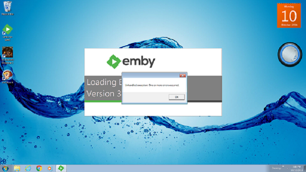

topraider 0 Posted October 10, 2016 Posted October 10, 2016 I installed the new Emby server update but when I tried to launch it. It only goes 3/4 way and stops. Also I get a error "Unhandled exception. One or more errors" I tried to re install from the website and get the same problem. Also uninstalled and tried to reinstall it, no luck.

Solution Happy2Play 9800 Posted October 11, 2016 Solution Posted October 11, 2016 Prefix already in use. Are you sure something else on that system isn't using the same ports? Did Emby by chance get installed twice? Legacy install "MediaBrowser-Server" and new install "Emby-Server" 1
topraider 0 Posted October 12, 2016 Author Posted October 12, 2016 After uninstalling Emby server and Emby WMC, I finally got it to work. Looks like what Happy2Play said maybe Emby was installed twice? On thing I want to say, I could not uniinstall Emby server completely, I would get a error about the shortcuts to Emby Server. But what I did do, I restarted the computer and re installed Emby Server and Emy WMC and was good to go. Thank you for all the help.
