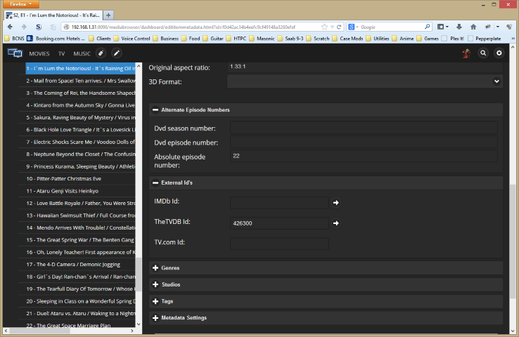

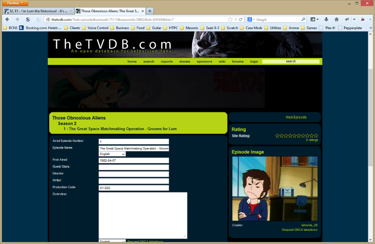

robsch 45 Posted January 18, 2014 Posted January 18, 2014 (edited) Hello This is been bothering me, and I am not sure how to resolve this issue? MB3 Server - Version 3.0.5115.35703 Windows 7 x64 I use MakeMKV to rip my discs. I use Media Center Master to tag/rename the MKVs. I then copy them to my MB3 Server. Content ID's from thetvdb.com : Those Obnoxious Aliens TV (TVDB - 75113) Season 2 (TVDB - 39602) Episode 1 (TVDB - 426300) After I do a media scan, it shows the content (Specials/Season 1/Season 2). Season 1 shows up perfectly, all the names and descriptions are correct. When I go into Season 2, it shows all the titles for Season 1, though when I got into the metadata manager, under External Id's it shows the proper TVDB ID's. Anyone have any ideas on how to resolve this? Thanks! - Robert Edited January 17, 2014 by robsch
Luke 42289 Posted January 18, 2014 Posted January 18, 2014 need to see the entire page of the second screnshot, as well as one from season 1 and 2

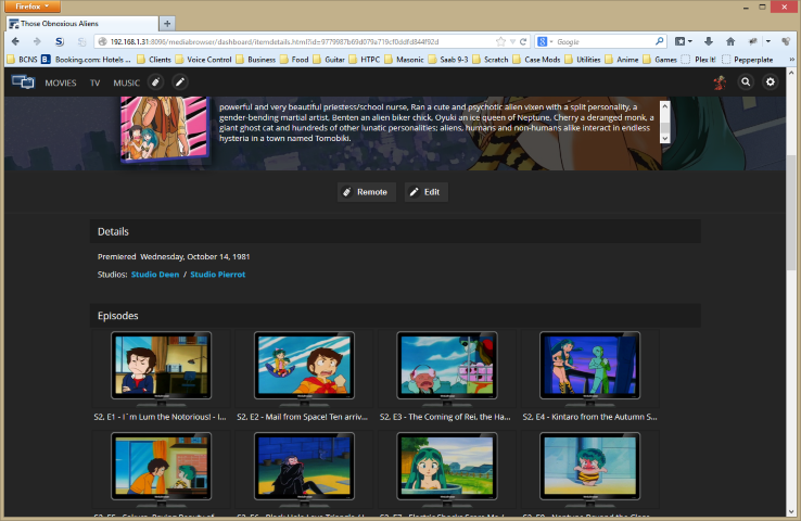

robsch 45 Posted January 18, 2014 Author Posted January 18, 2014 Here are some better images (and higher Res) (excuse my bad Photoshopping, I had to take 2 screenshots per item) Top Level (The show itself) Season 1 Season 2 Season 1 Episode 1 Season 2 Episode 2 - If you notice the path line, its //<blah>/Those Obnoxious Aliens - S02E01 - The Great Space Matchmaking Operation - Grooms for Lum [1982-04-07].mkv
bigjohn 754 Posted January 18, 2014 Posted January 18, 2014 I created a mock-up folder for this show, put a few sample episode files out there in seasons 1 and 2, and let MBS create all metadata. No problems at all, the episodes are named correctly, IDs are correct, etc. Seems like maybe MCM did something weird with the metadata. I notice that the seasons of the show are titled "Those Obnoxious Aliens" instead of Season 1, Season 2, etc. Something there is causing the seasons to be misidentified, so it certainly would not identify the episodes correctly. If you click Refresh Metadata on the top level of the show (making sure to leave the "Refresh Child Items" box checked), does it change anything? 3
