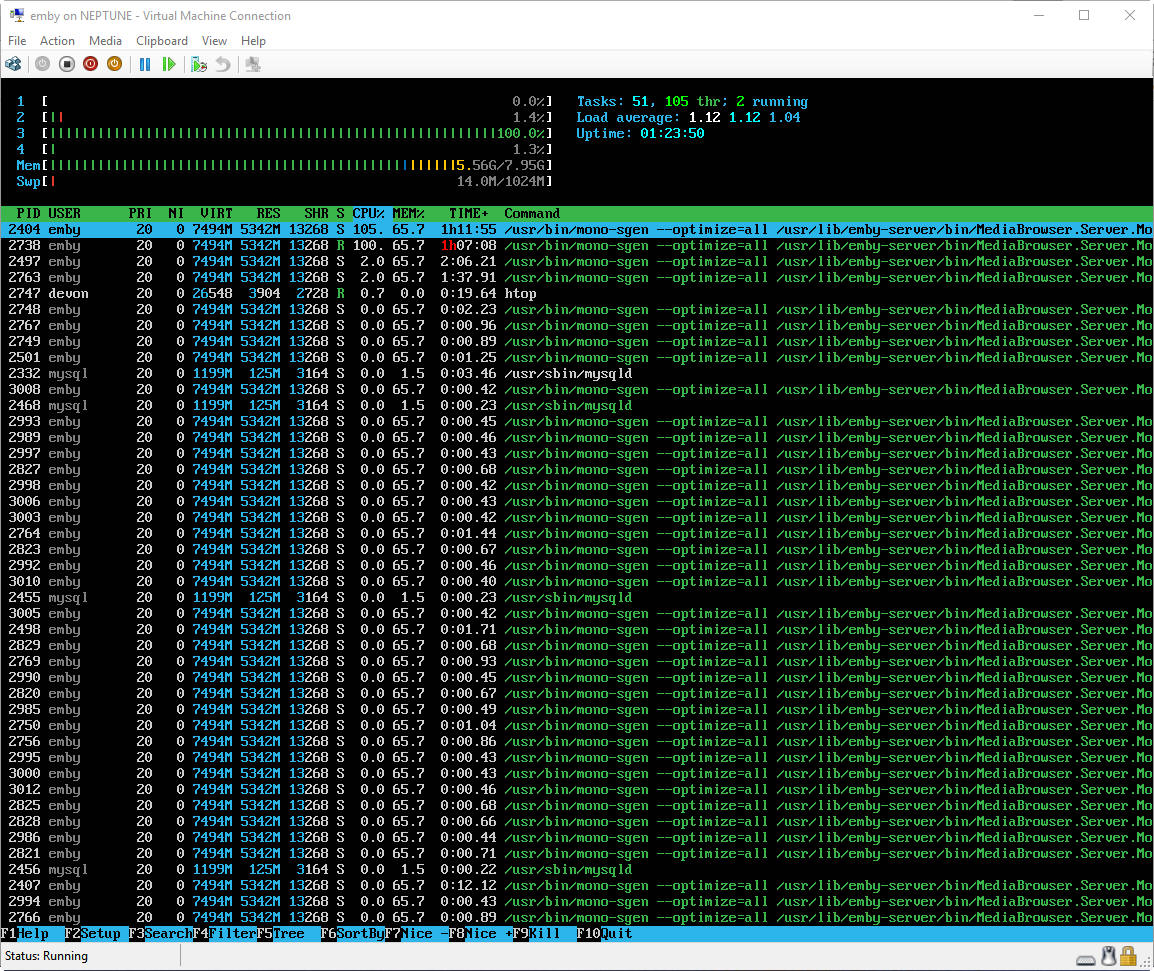

So I finally got my library scan to finish (After 7 hours!).  I'm running my Ubuntu 16.04 Emby server on a Hyper-V VM. When I had it set to 4GB RAM, it would crash on a library scan after about 45mins.  This was because it would run out of RAM every time.  I tried many things including upgrading from Ubuntu 15.10 to 16.04, then Mono 4.2.1 to now 4.4.2.  Then I finally said, if its running out of RAM....just add more!  I then set the VM to 2GB of initial RAM and up to 8GB of Dynamic RAM. This allowed the scan to finish.  The next day, while the server was still operational, I noticed that it would still fill up, all 8GB used!  So there still something causing Emby to use so much RAM.  I've read on other posts that they've seen Emby consume about 512MB RAM.
Below is a screenshot of what the processes looked like with 4GB RAM.  It's similar when 8GB is being used.  Are there supposed to be so many mono-sgen processes spawned?

That's the mono garbage collector.
Can this be tweaked for better performance?  I've seen other threads where some people modified the following.  I think my environment is set to 250/128 respectfully.
MONO_THREADS_PER_CPU="500",MONO_GC_PARAMS="nursery-size=512m"
Thoughts?  I'm dying here.  Scans are now taking 7+ hours and often still crashes.

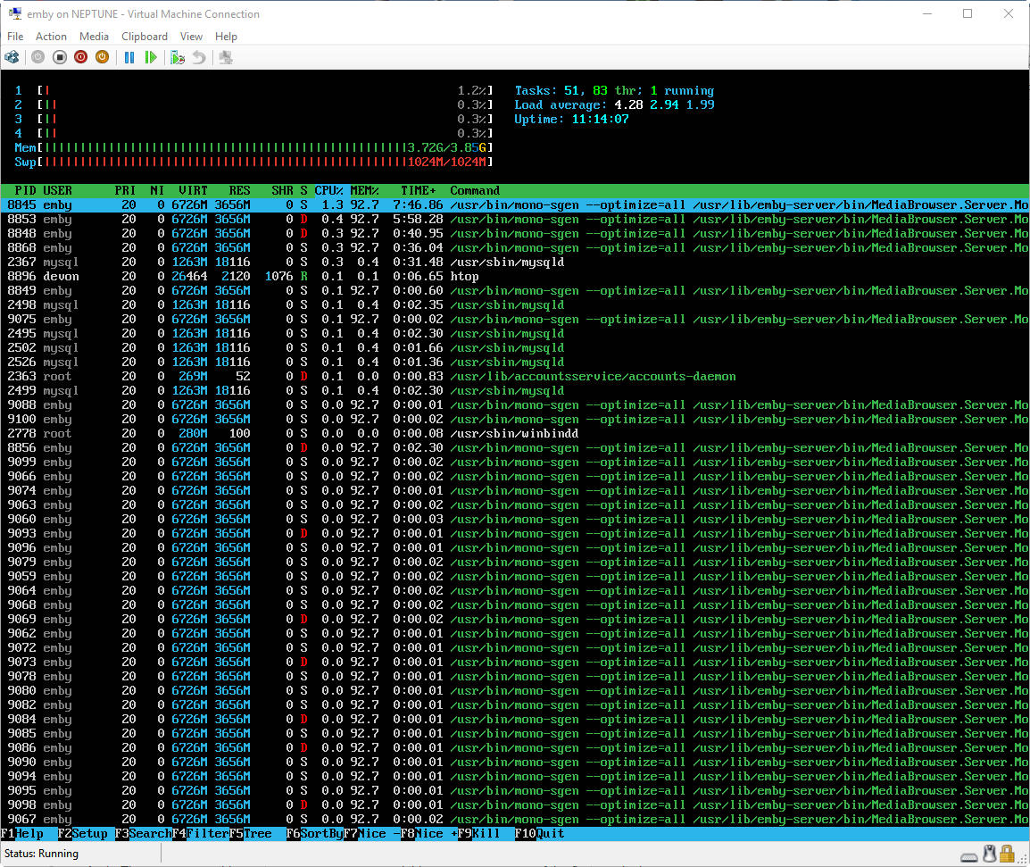

There's definitely something wrong with Emby and Mono 4.4.2.  I've done everything I can think of and this server is still not running right.  I've completely removed/re-installed Mono and Emby, same results.  Scans are taking 4+ hours (Really?).  Mono is taking up way too much RAM.  When the system is idle (no current scheduled tasks running or media playing), Emby/Mono is using 70%+ RAM (Why?).  Response from the web console is extremely slow when trying to display the My Media page (I get the spinning circle for minutes before anything shows up.  I checked the size of the library.db file, 3GB+ (is this normal?),  I'm out of ideas and have no clue what to try next.
