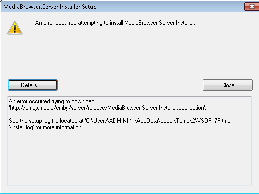

apriliaedd 0 Posted September 20, 2016 Posted September 20, 2016 (edited) Hi I'm trying to install emby server on my WHS 2011 media server but when i ran the set up file it installed the .net framework then asked for a reboot. once the server rebooted nothing more happened. if i run the installer again i get an error the log file it refers to is install.log I've tried rebooting again and downloading the setup file again but it just keeps on giving the same error, internet access is working, ive disabled any downloads on the network and tried again but still the same error. any suggestions? Cheers Edd Edited September 20, 2016 by apriliaedd
Luke 42186 Posted September 20, 2016 Posted September 20, 2016 Hi, we've updated the installers on the website: https://emby.media/windows-server.html Please try again. thanks.

Happy2Play 9800 Posted September 20, 2016 Posted September 20, 2016 (edited) Can you post a new log or error message then. The new installer should be pointing to GitHub not Emby. Edited September 20, 2016 by Happy2Play
apriliaedd 0 Posted September 20, 2016 Author Posted September 20, 2016 its working now, sort of. i rebooted the server and re downloaded the file using the server and it installed ok. its stalled at adding the library and pressing next does not seem to be doing anything
