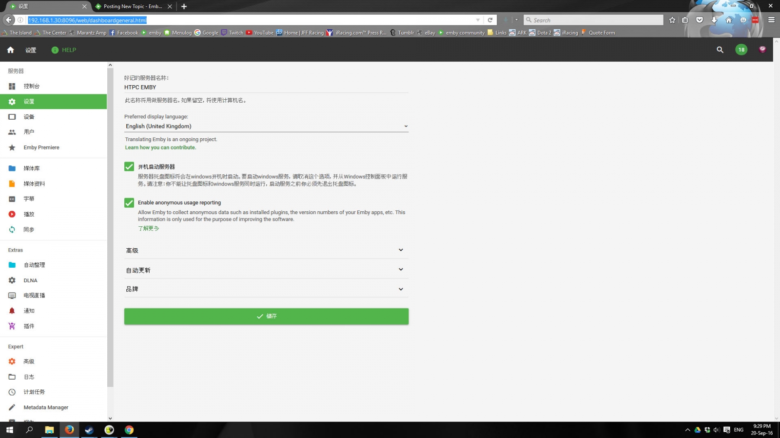

Tremas 205 Posted September 30, 2016 Posted September 30, 2016 Unfortunately, I experienced the exact same issue. For me, it occurred sometime between September 27, and the 29th. I was using the web client to listen to music at work on the 27th, and most everything was in Simplified Chinese late on the 28th. I saw this thread on the 29th and pulled my logs which I've attached below (they were big enough that I had to zip them, sorry). Just like philman84, I didn't have any luck with the display language. I used the workaround mentioned above (creating a new Admin User) and it did resolve the issue. Another thing that is worth noting is that while the web client gave me Chinese, the Roku client was displaying in English. Hope this helps find the problem. Images below from firefox and edge browsers on two different machines (windows 7 client and windows 10 server). Emby Server Logs.zip
Luke 42186 Posted September 30, 2016 Posted September 30, 2016 Unfortunately, I experienced the exact same issue. For me, it occurred sometime between September 27, and the 29th. I was using the web client to listen to music at work on the 27th, and most everything was in Simplified Chinese late on the 28th. I saw this thread on the 29th and pulled my logs which I've attached below (they were big enough that I had to zip them, sorry). Just like philman84, I didn't have any luck with the display language. I used the workaround mentioned above (creating a new Admin User) and it did resolve the issue. Another thing that is worth noting is that while the web client gave me Chinese, the Roku client was displaying in English. Hope this helps find the problem. Images below from firefox and edge browsers on two different machines (windows 7 client and windows 10 server). Can you browse to this folder C:\Users\Aaron\AppData\Roaming\MediaBrowser-Server\System\dashboard-ui\strings Then check the language file for your configured language. Does it have chinese contents?

Tremas 205 Posted October 1, 2016 Posted October 1, 2016 Hmm.. Looks normal to me. The modified date on all files in this directory is 9/17/2016, so it doesn't look like any of them were changed during the time period in which the problem happened. Sorry it's not more helpful. en-US.zip
Luke 42186 Posted October 1, 2016 Posted October 1, 2016 If you change the language setting to something else, does it remain in Chinese?
Tremas 205 Posted October 2, 2016 Posted October 2, 2016 Unfortunately, I've already deleted the user account that was displaying the problem. If I remember correctly, when I tried to change the language before I deleted the user, it had no effect. It would stay Chinese no matter what I selected. It was very difficult trying to find the option to change the language when all of the menus were in Chinese, so I'm not 100% sure I was doing it correctly. Sorry. I shouldn't have been so quick to delete the account, but I was in a hurry to resolve the issue because I wanted to use the system at a party this weekend. I certainly didn't think it through.
