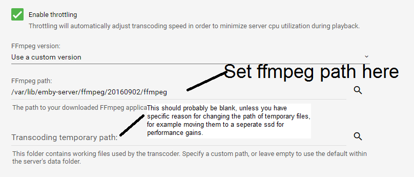

dcrdev 255 Posted September 19, 2016 Posted September 19, 2016 (edited) Luke, the smallest file I am trying to view is ~300MB so I will set up a dropbox or some such and send you the details. dcrdev, good point. I've copied the new ffmpeg to the folder you suggested (which existed but was empty?) and updated the Playback -> Transcoding -> Transcoding temporary path to reflect that. I also renamed the original files in /usr/bin but now the transcoding logs show that I am using the original files again? Thanks for your help so far. Much appreciated and can't wait to get this workig properly. Just hoping the problem isn't something dumb I've done. I'll try to find time tomorrow to rip a DVD and see if a different file format makes any difference. Peculiar from start to finish do this: # Just in case you wiped anything before (optional) sudo yum -y reinstall ffmpeg sudo rm -rf /var/lib/emby-server/ffmpeg/* sudo wget https://johnvansickle.com/ffmpeg/builds/ffmpeg-git-64bit-static.tar.xz -O /var/lib/emby-server/ffmpeg/20160919.tar.xz sudo tar -xvf /var/lib/emby-server/ffmpeg/20160919.tar.xz -C /var/lib/emby-server/ffmpeg/ sudo mv /var/lib/emby-server/ffmpeg/ffmpeg-git-20160919-64bit-static /var/lib/emby-server/ffmpeg/20160919 sudo chown -R emby:emby /var/lib/emby-server/ffmpeg/ --------- Set ffmpeg path to /var/lib/emby-server/ffmpeg/20160919/ffmpeg in Emby --------- sudo systemctl restart emby-server Also you don't need to be setting the transcoding temporary path unless you absolutely want to - leave it blank, you only need to set the ffmpeg path. Edit: Infact you might as well start with my configuration (paste the entire line into the terminal): sudo rm -rf /var/lib/emby-server/config/encoding.xml && sudo wget https://www.dcrdev.com/encoding.xml -O /var/lib/emby-server/config/encoding.xml && sudo chown emby:emby /var/lib/emby-server/config/encoding.xml && sudo systemctl restart emby-server Edited September 19, 2016 by dcrdev

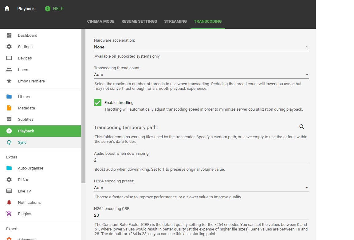

jmangan 11 Posted September 20, 2016 Author Posted September 20, 2016 dcrdev, okay I have part ripped a DVD (*.mkv) and that appears to play fine so it may be something odd about my .avi files. I followed you instructions above until I got to: Set ffmpeg path to /var/lib/emby-server/ffmpeg/20160919/ffmpeg in Emby This is what I thought I was doing "setting the transcoding temporary path" following Luke's posting at 4:35pm yesterday: "then customize the path under playback -> transcoding" Obviously I misunderstood something. Where and how should I set the ffmpeg path? Thanks for the use of your config file but, at the moment, I am treating this as a learning exercise as much as getting things working so I would like to know what was wrong and how to fix it. At least until your patience with me runs out ;-) I'm uploading a sample file (which plays in VLC) to Google Drive and I will add another post with the link when I get that done. Thanks again.

dcrdev 255 Posted September 20, 2016 Posted September 20, 2016 dcrdev, okay I have part ripped a DVD (*.mkv) and that appears to play fine so it may be something odd about my .avi files. I followed you instructions above until I got to: Set ffmpeg path to /var/lib/emby-server/ffmpeg/20160919/ffmpeg in Emby This is what I thought I was doing "setting the transcoding temporary path" following Luke's posting at 4:35pm yesterday: "then customize the path under playback -> transcoding" Obviously I misunderstood something. Where and how should I set the ffmpeg path? Thanks for the use of your config file but, at the moment, I am treating this as a learning exercise as much as getting things working so I would like to know what was wrong and how to fix it. At least until your patience with me runs out ;-) I'm uploading a sample file (which plays in VLC) to Google Drive and I will add another post with the link when I get that done. Thanks again. See annotations below:
Luke 42244 Posted September 20, 2016 Posted September 20, 2016 I meant customize the ffmpeg path, sorry, not the temporary path. I am sorry that I was not specific enough.
jmangan 11 Posted September 20, 2016 Author Posted September 20, 2016 I don't have that. The first line under the 'Enable throttling' option is Transcoding temporary path. Weird.

dcrdev 255 Posted September 20, 2016 Posted September 20, 2016 I don't have that. The first line under the 'Enable throttling' option is Transcoding temporary path. Weird. Select "Use custom version" from the "Ffmpeg version:" dropdown, then you'll see it.
