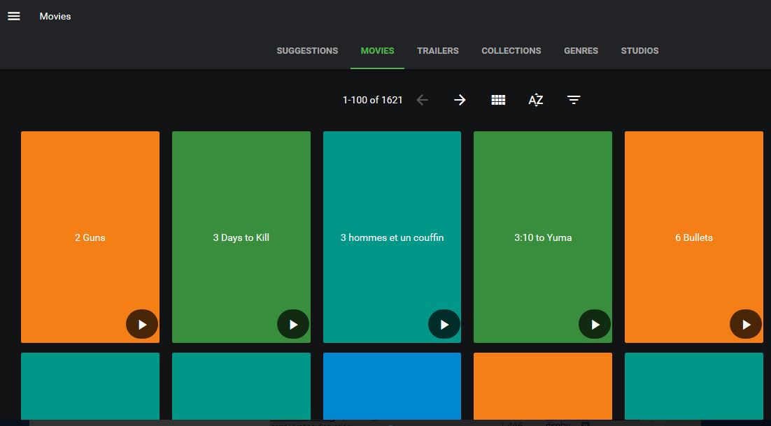

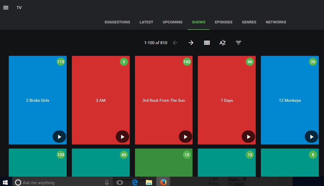

w3man 0 Posted September 13, 2016 Posted September 13, 2016 I installed emby, and added two libraries. I noticed on the main screen, the images for movies are not being displayed. Is there a reason why the movie or tv episode images are not downloading? Any thoughts on what to check? Thanks
Luke 42244 Posted September 13, 2016 Posted September 13, 2016 Hi, welcome! Can you discuss some specific examples, and perhaps show a screenshot? Thanks !
w3man 0 Posted September 13, 2016 Author Posted September 13, 2016 Here is what i see. They are just blank..
Luke 42244 Posted September 13, 2016 Posted September 13, 2016 Has the initial library scan completed after setting up the server?
