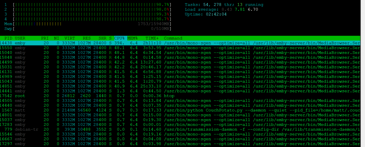

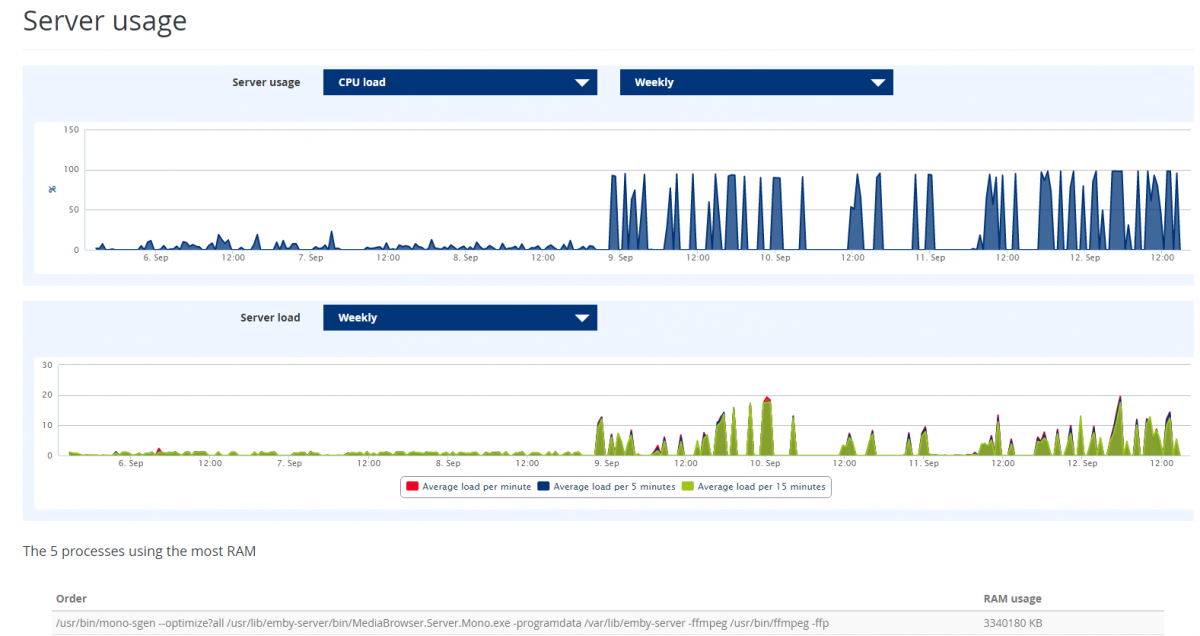

matty87a 8 Posted September 12, 2016 Posted September 12, 2016 (edited) Ubuntu 14.04 Version 3.0.7100.0 Since the 09/09 and subsequent updates emby's mono services seem to be absoltuetly hammering my CPU - the attached pics should show the uptick and the ram/cpu useage. Is fine on initial start of service and then builds and builds within minutes. any idea on causes/where to look? http://imgur.com/a/FzJmf EDIT: Appears to be triggered upon first playback and remains even after playback ceased Edited September 12, 2016 by matty87a

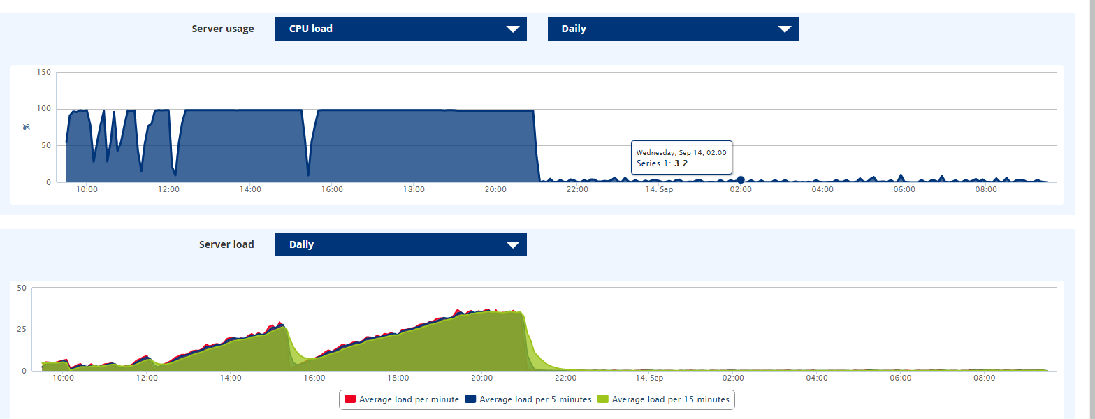

matty87a 8 Posted September 14, 2016 Author Posted September 14, 2016 Your entire log in post #4 is LibraryMonitor refreshing libraries. Does disabling Real Time Monitoring help or resolve your issue? Dashboard-Library- Click on each library (Enable real time monitoring) so you may notice a slight difference after i disabled real time monitoring....
