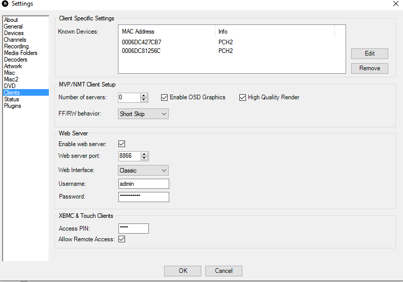

MarcoB 0 Posted September 6, 2016 Author Posted September 6, 2016 Thank you both for responding so quickly. I'm giving up on MediaPortal, I can't get it to function properly on my PC. For NextPVR, everything seems to be set up properly on my PC. I did find that Allow Remote Access setting earlier when I was trying to figure this out, but it didn't seem to do the trick (screencap below). Is there any issue having a username/password populated?
PenkethBoy 2068 Posted September 6, 2016 Posted September 6, 2016 No same as mine - have been experimenting and it appears you need NextPVR actually open not just the try app for emby to pick it up - im using the Dev version of the server so that might be different - Luke would have to chip in on that it might be there is another setting elsewhere or we are not waiting long enough need to read up a bit more on NextPVr forums tomorrow if you figure it out - let us know

jordy 284 Posted September 6, 2016 Posted September 6, 2016 Just check to see that you have the nextpvr recording service active. Pretty sure that you don't need NPVR app running but you do need the service. Sent from my HUAWEI MT7-L09 using Tapatalk
MarcoB 0 Posted September 6, 2016 Author Posted September 6, 2016 Just check to see that you have the nextpvr recording service active. Pretty sure that you don't need NPVR app running but you do need the service. Sent from my HUAWEI MT7-L09 using Tapatalk I'm fairly certain I have this active, but how do I check for sure?
jordy 284 Posted September 6, 2016 Posted September 6, 2016 Check the icon in the taskbar by the clock - black with white N. R click and restart service to be sure. Sent from my HUAWEI MT7-L09 using Tapatalk
sub3 64 Posted September 6, 2016 Posted September 6, 2016 (edited) I'm fairly certain I have this active, but how do I check for sure? If you open http://127.0.0.1:8866 on your web browser (on the machine that has NextPVR installed), you should see it's web app. See that will tell you the web server is running, and the API that EMBY uses will be available. Edited September 6, 2016 by sub3

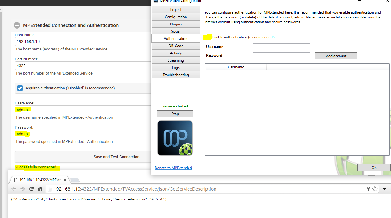

MarcoB 0 Posted September 6, 2016 Author Posted September 6, 2016 I re-installed MediaPortal1 and was able to get that to function on my PC, but I still receive an unavailable status on the Plugin page of Emby. My host (192.168.1.10) and port (4322) appear to be configured properly for MediaPortal in Emby. Is there anything else that needs to be done to configure MP? Is there something on my PC that is blocking both of these plugins??
pünktchen 1411 Posted September 6, 2016 Posted September 6, 2016 (edited) Firewall maybe? Test the second link from MPExtended Configurator -> Troubleshooting on the machine where MPExtended is installed as well as on a remote machine. Also have you checked your authentication settings in Emby MediaPortal Live TV plugin? Authentication is enabled by default in MPExtended - user: admin, password: admin. Edited September 6, 2016 by pünktchen 1
MarcoB 0 Posted September 6, 2016 Author Posted September 6, 2016 (edited) Firewall maybe? Test the second link from MPExtended Configurator -> Troubleshooting on the machine where MPExtended is installed as well as on a remote machine. Also have you checked your authentication settings in Emby MediaPortal Live TV plugin? Authentication is enabled by default in MPExtended - user: admin, password: admin. Some progress! I had authentication disabled in MPExtended, but after putting in admin/admin in Emby, it does let me connect to it now. Now, on to the next issue... When I open the Emby Live TV folder in my PS4's media player, I see a message of 'No Playable Media' Edit - I'm now seeing the MP Plugin go randomly to Unavailable on the LiveTV section of Emby, every time i go into the PlugIn's settings and test the connection there, it is successful. Edited September 6, 2016 by MarcoB
pünktchen 1411 Posted September 6, 2016 Posted September 6, 2016 If authentication is disabled in MPExtended you really should disable it in the plugin also! For your random connection aborts i can only guess it's still some security software. Before getting to the Playstation, we should concentrate to get things working in a browser on your Emby machine.
MarcoB 0 Posted September 6, 2016 Author Posted September 6, 2016 (edited) Ok, I believe I have a stable connection here now. I disabled authentication on MPExtended and on the Plug In and haven't had any issues seeing my active tuners on the Live TV section of the Emby Server page. I also set up my recorded TV folder to be added to my Library on the Emby Server. When I go into Live TV or Recorded TV on my Media Center on my PS4, both places it says there is no available media. Also, not sure if this is related or not, but when I went into my Windows Firewall settings to look for the Apps that were allowed, I tried finding for Emby, but I couldn't find it. When attempting to add it to the list manually, it says it was already in the list, which was odd. Edit - I also noticed Emby Server installed to C:\Users\USERNAME\AppData\Roaming\Microsoft\Windows\Start Menu\Emby, rather than program files. I tried reinstalling to get it under program files, but I couldn't make it happen. Not sure if this is an issue. Edited September 6, 2016 by MarcoB

pünktchen 1411 Posted September 6, 2016 Posted September 6, 2016 (edited) @@MarcoB Do not add your recording folder to Emby's library, nor add it in the general live tv settings page!!! Instead you can define your recording share in the MediaPortal Live TV plugin settings. This is better for direct playback, but you don't have to do this just to get it working. Do not forget to do a "guide refresh" at least one time manually, or you will not see any channels or recordings! Edited September 6, 2016 by pünktchen
MarcoB 0 Posted September 6, 2016 Author Posted September 6, 2016 @@MarcoB Do not add your recording folder to Emby's library, nor add it in the general live tv settings page!!! Instead you can define your recording share in the MediaPortal Live TV plugin settings. This is better for direct playback, but you don't have to do this just to get it working. Do not forget to do a "guide refresh" at least one time manually, or you will not see any channels or recordings! Ok - I removed all folders from Emby's library. It looks like I do in fact have no guide data on MediaPortal (screencap), but I can't figure out how to do a guide refresh. Nothing is sticking out in the TV Server Config tool for MP to do this. Will keep searching..
pünktchen 1411 Posted September 6, 2016 Posted September 6, 2016 Ok - I removed all folders from Emby's library. It looks like I do in fact have no guide data on MediaPortal (screencap), but I can't figure out how to do a guide refresh. Nothing is sticking out in the TV Server Config tool for MP to do this. Will keep searching.. http://wiki.team-mediaportal.com/1_MEDIAPORTAL_1/13_Setup_Guides/2_TV_Setup/4_TV_Guide_Setup_(EPG)
