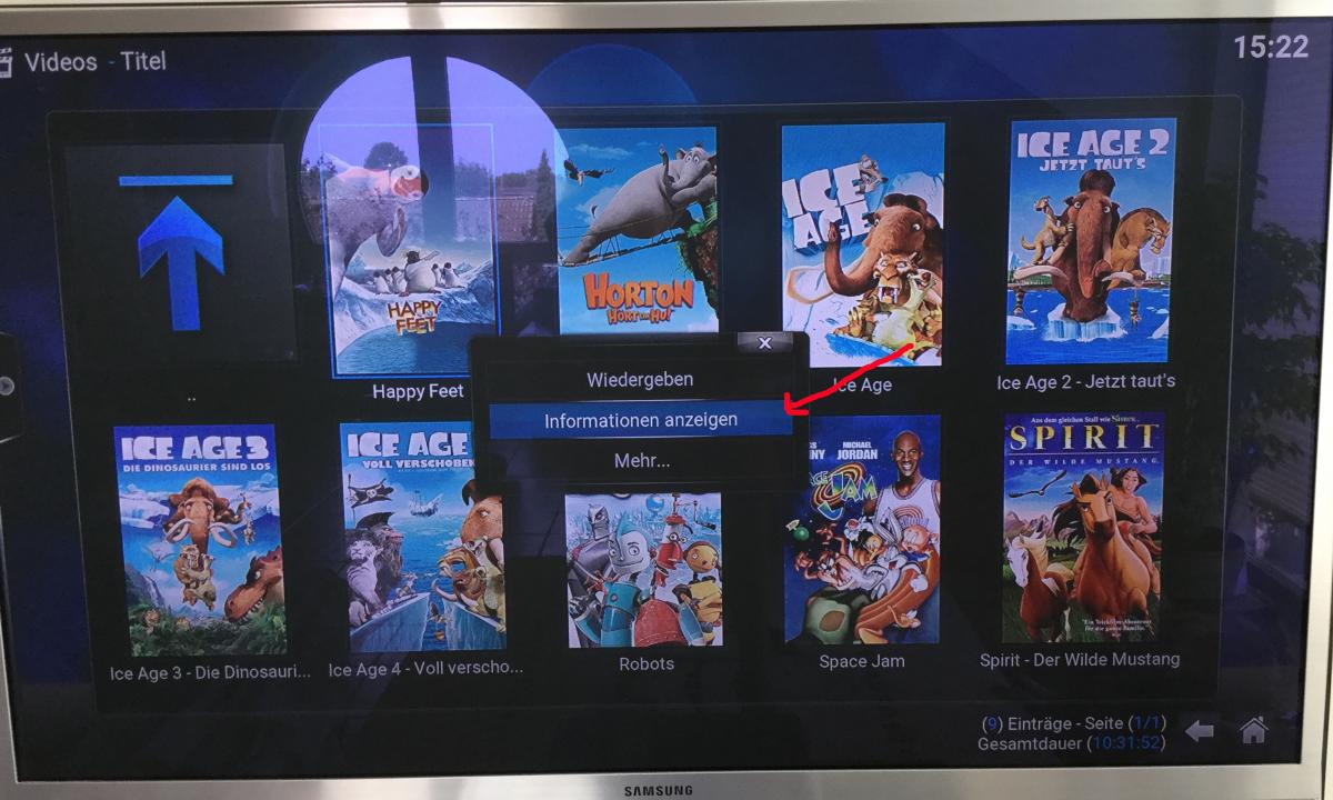

I only have made some settings about the language and when I start a movie that I make a choice to see more information:
Then I add a movie folder (NFS)
I can see the added Movies
When highlight a Movie and press "OK" I can make a choice to "show information"
Pushing that button will show an extra window with more information

I pusk "OK" to see my Movie, I can make my choice to see "more Information", but pressing this button will not show the Information Window... it only shows a window where I can start the Movie
