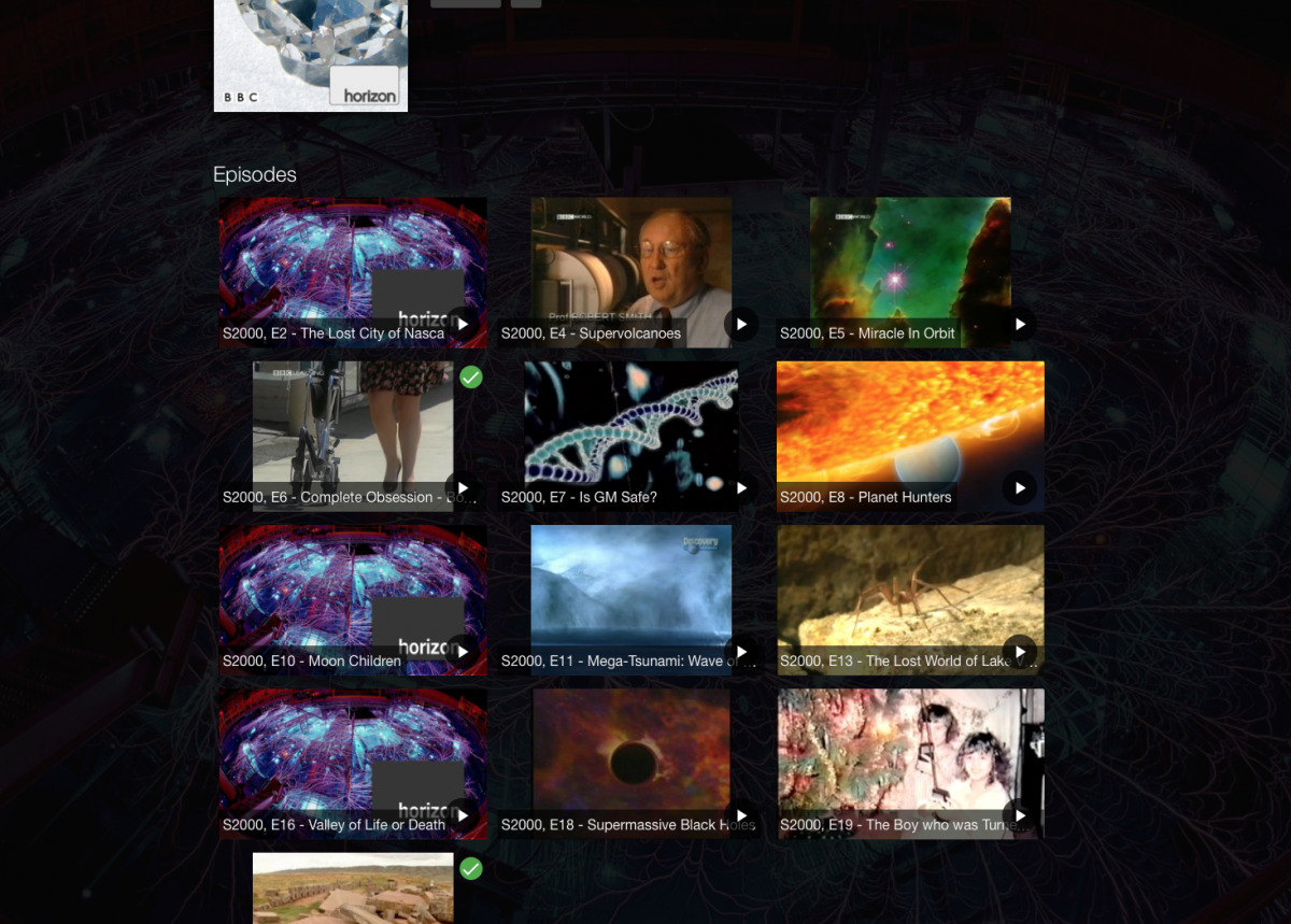

grumpygamer 0 Posted August 20, 2016 Author Posted August 20, 2016 As you might notice the thumbnails are not there, not sure but I think it's applying the fanart instead. Thanks
Luke 42186 Posted August 20, 2016 Posted August 20, 2016 well there is something there. what is the problem exactly? it is probably getting them from tvdb. I don't understand the issue.
grumpygamer 0 Posted August 20, 2016 Author Posted August 20, 2016 Well the problem is there are no thumbnails on thetvdb, so I'm not sure why it's replacing it with the fan-art, ideally it would be great if Emby could generate the thumbnails instead directly from the video stream!
Luke 42186 Posted August 20, 2016 Posted August 20, 2016 that's what it does. it would only use the series fanart if the thumbnail generation for that video happened to fail for whatever reason.
