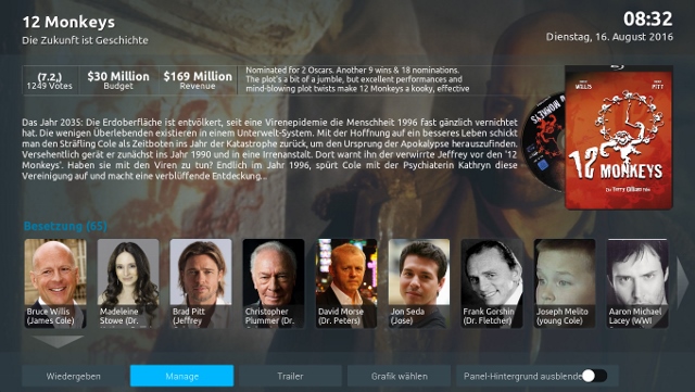

sh0rty 727 Posted August 16, 2016 Posted August 16, 2016 It just doesn't work. It's because with add-on paths, we actually masking the end path because it's pulled in real time from the emby server at the moment of playback. Check the readme/wiki out: https://github.com/MediaBrowser/plugin.video.emby Are we talking about this script? If so, it seems to work with Titan Skin in combination with Addon mode.
Angelblue05 4132 Posted August 16, 2016 Posted August 16, 2016 Interesting. I am not sure anymore [emoji52] Sent from my iPhone using Tapatalk
mikeB2210 26 Posted August 16, 2016 Author Posted August 16, 2016 Are we talking about this script? If so, it seems to work with Titan Skin in combination with Addon mode. @@shorty1483 Looks great, is there somewhere a wiki about this script? Can I change the looking and behavior in a setting panel when I have installed it? 1

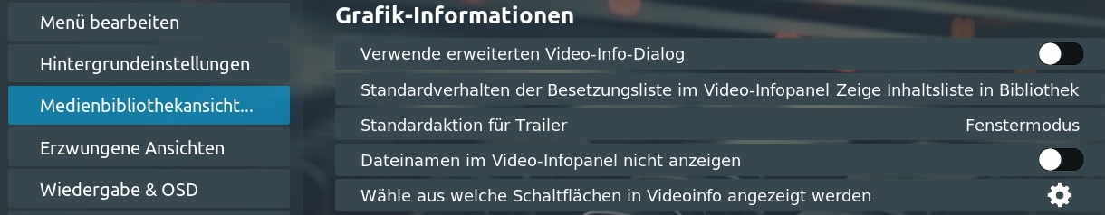

sh0rty 727 Posted August 16, 2016 Posted August 16, 2016 (edited) Are we talking about this script? If so, it seems to work with Titan Skin in combination with Addon mode. @@shorty1483 Looks great, is there somewhere a wiki about this script? Can I change the looking and behavior in a setting panel when I have installed it? http://kodi.wiki/view/Add-on:ExtendedInfo_Script http://forum.kodi.tv/showthread.php?tid=160558 Interesting. I am not sure anymore [emoji52] Sent from my iPhone using Tapatalk There a few Titan Skin Settings regarding extended info. You can choose to open extended infos by default instead of the native movie details. The 4th entry let the movie details show the regular file name ov the movie on HDD also when you're in Addon mode. Perhaps that's the trick or @@marcelveldt can clear up this? I personally can open the extended info from withing the native movie details using a switch in the bottom bar. The only thing is that it takes a few seconds to load when watching ext info for a movie for the first time cause Kodi needs to gather the infos from tmdb. Edited August 16, 2016 by shorty1483 2

sh0rty 727 Posted August 16, 2016 Posted August 16, 2016 (edited) System->Addons->Benutzer Addons, dort dann das Extended Info Script konfigurieren, je nachdem ob du den Titan look willst oder den nativen look mit halbseitigem cover. Auch die erzwungene Anzeige kannst du aktivieren. Spiel einfach was mit den Settings. Dann bei den Einstellungen die ich weiter oben gepostet habe "verwende erweiterten Video-Info-Dialog" aktivieren. Bei Aeon weiss ich es nicht. gesendet von meinem Galaxy Tab S2 LTE Edited August 16, 2016 by shorty1483
mikeB2210 26 Posted August 18, 2016 Author Posted August 18, 2016 (edited) Habe die Einstellungen mal gemacht, aber wenn ich jetzt einen Film auswähle und die OK Taste drücke bekomme ich keine zusätzlichen Infos sondern nur die Auswahl zum Abspielen. Hat das irgendwas mit emby zu tun? Ich habe emby so eingestellt das die Filme Native abgespielt werden.Man, man da ist Microsoft Windows ja einfach gegen Edited August 18, 2016 by mikeB2210
