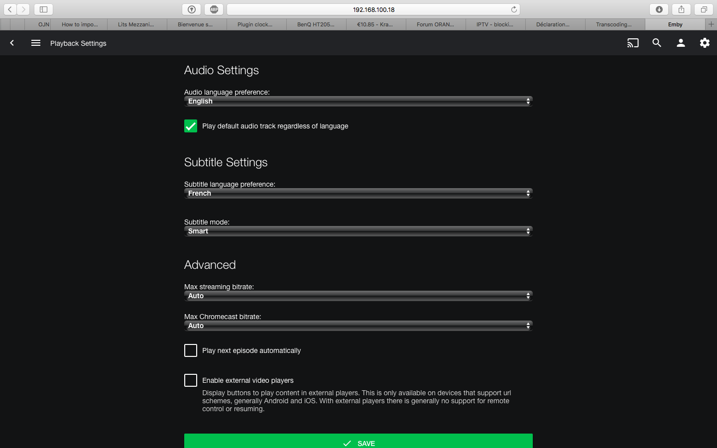

esseki 12 Posted August 10, 2016 Author Posted August 10, 2016 (edited) Hi Luke, first of all, thank you for your quick reply I don't understand what makes you think that the in app bitrate is not set to "Auto". I think it is. To make sure i'm not misunderstanding you i have created a screenshot from the web client. I have checked and form the iPad app the settings look the same as the screenshot above. Let me check if i disable Quick Sync, if the problem is the same. I will let you know the result. Cheers Edited August 10, 2016 by esseki
Luke 42186 Posted August 10, 2016 Posted August 10, 2016 Ok. You could also try lowering the in-app bitrate setting to 1mbps as a test.
