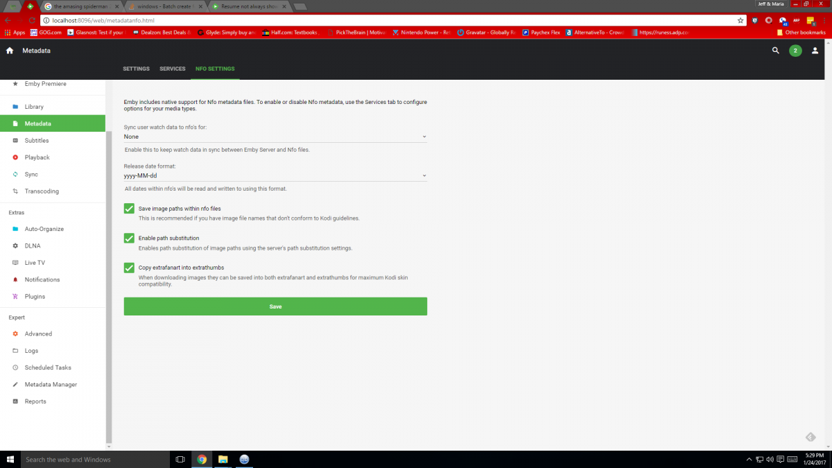

Luke 42249 Posted January 24, 2017 Posted January 24, 2017 can you show a screenshot of your nfo metadata settings from the server dashboard? thanks !
xXSagaiaXx 25 Posted January 24, 2017 Author Posted January 24, 2017 Here you go. Where are the files stored? Untitled.zip
Luke 42249 Posted January 24, 2017 Posted January 24, 2017 You've enabled syncing user data to nfo's, so most likely another program is altering the saved data. try turning that off.

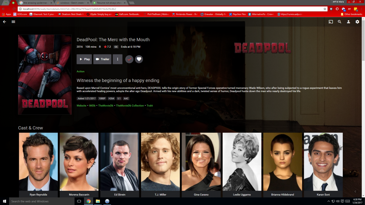

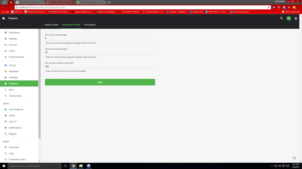

ebr 16339 Posted January 24, 2017 Posted January 24, 2017 The data is not anywhere you can easily see it. What is the reported length of the item you were last trying? Can you show the media info for it from the web client? Also, what are your resume settings under Dashboard->Playback->Resume Settings?
Luke 42249 Posted January 24, 2017 Posted January 24, 2017 yea and actually, since you enabled nfo syncing, for that user the nfo files will be the primary source.
xXSagaiaXx 25 Posted January 24, 2017 Author Posted January 24, 2017 yea and actually, since you enabled nfo syncing, for that user the nfo files will be the primary source. I disabled nfo syncing as you had suggested earlier
xXSagaiaXx 25 Posted January 24, 2017 Author Posted January 24, 2017 The data is not anywhere you can easily see it. What is the reported length of the item you were last trying? Can you show the media info for it from the web client? Also, what are your resume settings under Dashboard->Playback->Resume Settings? Attached screenshots for your questions
Luke 42249 Posted January 24, 2017 Posted January 24, 2017 Can you show another screenshot of the nfo settings? thanks.
ebr 16339 Posted January 24, 2017 Posted January 24, 2017 And the media info at the bottom of that page you posted...
xXSagaiaXx 25 Posted January 24, 2017 Author Posted January 24, 2017 Can you show another screenshot of the nfo settings? thanks.
xXSagaiaXx 25 Posted January 24, 2017 Author Posted January 24, 2017 And the media info at the bottom of that page you posted...
