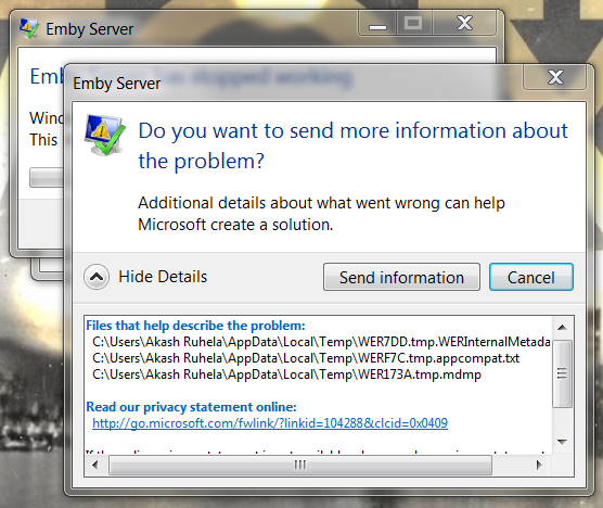

AkashRuhela 0 Posted August 6, 2016 Posted August 6, 2016 (edited) Hello, I've been using Emby with no problems but lately my server won't even start. Every time I try to start the server, it just crashes with the image attached. I've tried multiple re-installations with no luck, always the same exact error. Please advise. Edited August 6, 2016 by AkashRuhela

AkashRuhela 0 Posted August 8, 2016 Author Posted August 8, 2016 Found 2 errors. Log Name: Application Source: Application Error Date: 08/08/2016 4:42:14 PM Event ID: 1000 Task Category: (100) Level: Error Keywords: Classic User: N/A Computer: AkashRuhela-PC Description: Faulting application name: MediaBrowser.ServerApplication.exe, version: 3.0.6030.0, time stamp: 0x57a2cf4d Faulting module name: KERNELBASE.dll, version: 6.1.7601.23455, time stamp: 0x573a54fc Exception code: 0xe0434352 Fault offset: 0x000000000001a06d Faulting process id: 0x301c Faulting application start time: 0x01d1f1b55159b2d4 Faulting application path: C:\Users\Akash Ruhela\AppData\Roaming\Emby-Server\System\MediaBrowser.ServerApplication.exe Faulting module path: C:\Windows\system32\KERNELBASE.dll Report Id: 95d0e435-5da8-11e6-9676-08edb9d9df20 Event Xml: <Event xmlns="http://schemas.microsoft.com/win/2004/08/events/event"> <System> <Provider Name="Application Error" /> <EventID Qualifiers="0">1000</EventID> <Level>2</Level> <Task>100</Task> <Keywords>0x80000000000000</Keywords> <TimeCreated SystemTime="2016-08-08T20:42:14.000000000Z" /> <EventRecordID>466568</EventRecordID> <Channel>Application</Channel> <Computer>AkashRuhela-PC</Computer> <Security /> </System> <EventData> <Data>MediaBrowser.ServerApplication.exe</Data> <Data>3.0.6030.0</Data> <Data>57a2cf4d</Data> <Data>KERNELBASE.dll</Data> <Data>6.1.7601.23455</Data> <Data>573a54fc</Data> <Data>e0434352</Data> <Data>000000000001a06d</Data> <Data>301c</Data> <Data>01d1f1b55159b2d4</Data> <Data>C:\Users\Akash Ruhela\AppData\Roaming\Emby-Server\System\MediaBrowser.ServerApplication.exe</Data> <Data>C:\Windows\system32\KERNELBASE.dll</Data> <Data>95d0e435-5da8-11e6-9676-08edb9d9df20</Data> </EventData> </Event> Log Name: Application Source: .NET Runtime Date: 08/08/2016 4:42:12 PM Event ID: 1026 Task Category: None Level: Error Keywords: Classic User: N/A Computer: AkashRuhela-PC Description: Application: MediaBrowser.ServerApplication.exe Framework Version: v4.0.30319 Description: The process was terminated due to an unhandled exception. Exception Info: System.Management.ManagementException at System.Management.ManagementException.ThrowWithExtendedInfo(System.Management.ManagementStatus) at System.Management.ManagementObjectCollection+ManagementObjectEnumerator.MoveNext() at MediaBrowser.ServerApplication.MainStartup.IsAlreadyRunningAsService(System.String) at MediaBrowser.ServerApplication.MainStartup.Main() Event Xml: <Event xmlns="http://schemas.microsoft.com/win/2004/08/events/event"> <System> <Provider Name=".NET Runtime" /> <EventID Qualifiers="0">1026</EventID> <Level>2</Level> <Task>0</Task> <Keywords>0x80000000000000</Keywords> <TimeCreated SystemTime="2016-08-08T20:42:12.000000000Z" /> <EventRecordID>466567</EventRecordID> <Channel>Application</Channel> <Computer>AkashRuhela-PC</Computer> <Security /> </System> <EventData> <Data>Application: MediaBrowser.ServerApplication.exe Framework Version: v4.0.30319 Description: The process was terminated due to an unhandled exception. Exception Info: System.Management.ManagementException at System.Management.ManagementException.ThrowWithExtendedInfo(System.Management.ManagementStatus) at System.Management.ManagementObjectCollection+ManagementObjectEnumerator.MoveNext() at MediaBrowser.ServerApplication.MainStartup.IsAlreadyRunningAsService(System.String) at MediaBrowser.ServerApplication.MainStartup.Main() </Data> </EventData> </Event> Please advise. Thanks.
Solution Luke 42186 Posted August 8, 2016 Solution Posted August 8, 2016 WMI - Windows Management Instrumentation has either been disabled or has failed. You could try this: First ensure the service is running: https://msdn.microsoft.com/en-us/library/aa826517(v=vs.85).aspx If the issue persists, then see http://www.ehow.com/how_7243330_repair-wmi-error.html 1
