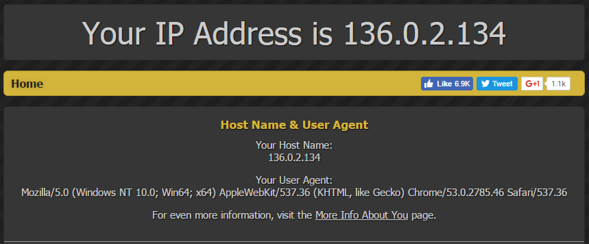

pir8radio 1313 Posted August 7, 2016 Posted August 7, 2016 (edited) I'm not sure I understand... Which IP address would I use to connect to my server in that case? And how do I know if my VPN accepts inbound connections? BTW, the remote desktop applications that I use are teamviewer, chrome remote desktop and splashtop. Yea all of those remote desktop connections originate from your pc, establish a connection to their servers, then you remotely connect to their server... Its hard to block those outbound connections which is why they work. You have to do some digging to see what VPN service allows inbound connections. Here are a "Top 10" vpn provider list: https://www.top10vpn.com/compare/?bsid=c0se1kw060&gclid=CMfD2rHzr84CFUKVGwod7hsDmQ Once connected to the VPN service, you can go to http://www.whatsmyip.org/ and it will show you your new public IP that is running through the VPN service. Here is my normal ISP IP: Here is after I have connected to a VPN in Switzerland: Edited August 7, 2016 by pir8radio
